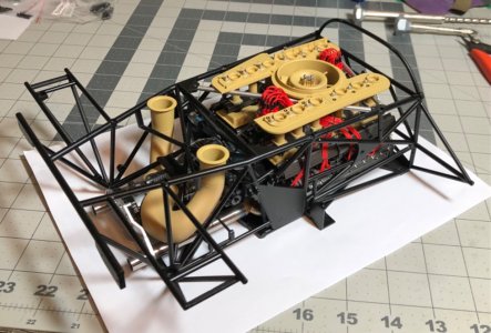

Now for a few pics of my current progress…
View attachment 506670View attachment 506671View attachment 506672View attachment 506673View attachment 506674
Until next time… ;)
A tubular chassis is always impressive to see with all those angles. And the touch-up of some details makes it special, Dean. The spark plug wires comes out really nice.
Thanks Peter. the plug wires got pulled off in a few places because the clearance is very minimal. But I was able to fix them. That was my concern when I saw that step on the instructions!
Very nice Dean, the engine looks as if you built it all while inside the frame!
Thanks Daniel. It is very tight and barely fits! I kind of hate that it hides a lot of my work…ROTF
