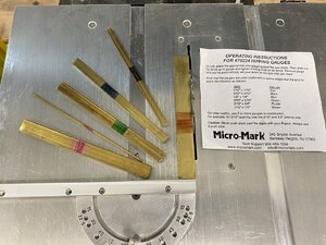

In my experience, no matter which mini table saw you have, in order to cut planking strips you need to set the rip fence as accurately as possible to the blade. Any deviation will bind the blade and make cutting strips a frustration. The better the saw the more accurate the settings and the less drift once locked in. I have a MicroLux saw (MicroMark) and with very careful settings I have cut lots of planking strips from 1/4 inch stock. The best way to set the fence to the blade is with brass machine setup gauges...they are brass bars about 3" long of various widths. Set the guage next to the blade and run the fence up to it and lock in place.
Do you have a source to order the setup gauges?
Actually Amazon has several sets to choose from...search "machine setup guages" or "brass setup bars." I got my set from MicroMark 70224 called a "ripping guage set" for $11.99. Rockier.com has setup guage bar sets but they are more expensive. Setup guages or bar sets are commonly available through most tool and woodworking sites. I recommend the set from MicroMark.
And you can also use sections of K&S brass tubing-
Or just cut your own for custom applications from hard wood or plastic.
