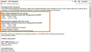

Hello
Prices have probably been in creased in the meantime.
Simply request offer.
Die Sägeblätter sind absolut Spitze, Superscharf mit langer Standzeit.
Ich habe zwischenzeitlich meine verbrauchten Sägeblätter schon
zweimal bei GSP nachschärfen lassen, alles Bestens.
Karl

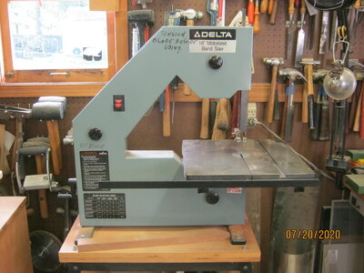

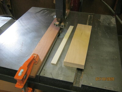

I set up the band-saw to cut off 1/8" slices. I leave them a bit on the full side. After each cut, the chunk was run through my 10" table-saw to clean up and straiten the bandsawn edge, then another slice was taken off. Did this until the chunk was reduced to a pile of 1/8" slices. Each slice had one face with table saw marks from the 10" saw and one face with marks from the band saw.

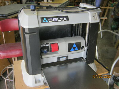

Then, I ran all the slices through the 12" planer, band saw side first to clean it up, then table saw side to take them to 3/32" size.
Then ran the thickness-ed slices through the band saw and through the table saw.

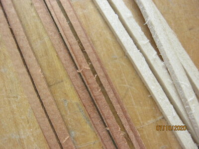

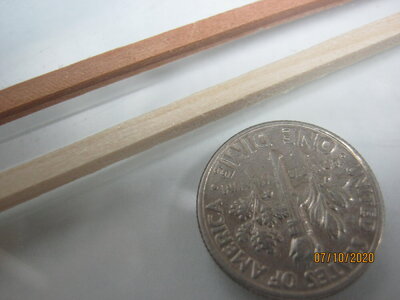

These are through the band saw 3/32" square.

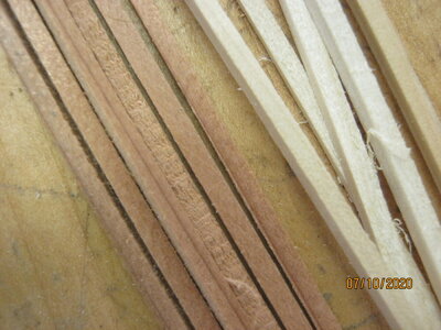

These are through the new mini table saw, 3/32" square.
They are a bit cleaner. I miked about 6 of each in different locations and the strips came out about .0015 + or -.
After a pass over them with a sanding block -
I'm happy. For ripping 3/32" to 1/4" thick sliced blanks to strip width, which most of the time it is, the little table saw worked just fine. It was easier to keep cutting in a strait line than the band saw. I will be making a set of finger jigs to hold the work-piece to the fence and down to the table. I have always done that on my shop work when making stuff for a run as it makes the cuts more consistent and safer. It should work as well on the mini tools too.

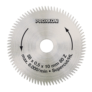

Basically, I would suggest starting with three blades, It doesn't have to be the Proxxon blades but it would be difficult to find other brands as 10mm arbor is not an American standard. In Europe, you will have a better chance, IMHO.

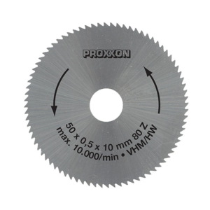

1. Tungsten Carbide Saw Blade Ø 2" x 1/64", arbor 13/32" (50mm x 0.5mm x 10mm), fine-toothed, 80 teeth. The blade is ideal for cutting fiberglass sheets, non-ferrous metal, miniature moldings, plastics, and other "difficult-to-cut" materials. NO 28 011
2. I like this one!!! Crosscut Blade Super-Cut Ø 2 9/32" x 1/64" x 13/32" (58mm x 0.4mm x 10mm), 80 teeth. Ideal for use on hard and softwood, as well as plastic. For fast, clean cuts. The 80 teeth are alternately set and sharpened. For superior cutting power! NO 28 014
3. For final\finish and very thin Up to 1.00mm wood planks

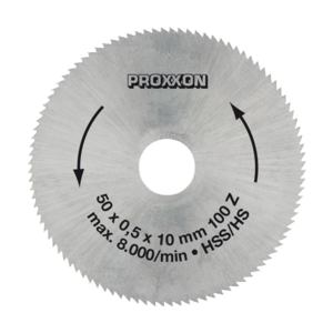

High-Alloy Special Steel Saw Blade Ø 2" x 1/64" x 13/32 bore" (50mm x 0.5mm x 10mm), fine- 100 teeth. Alloy holding a high proportion of tungsten, vanadium, and molybdenum for an even structure, high hardness, and long lifetime. Fine-toothed. For very fine cuts in non-ferrous metals (aluminum, brass, copper). Also suitable for cutting compound materials like PC cards, and sawing wood and plastics.
NO 28 020
Hope this helps ;)

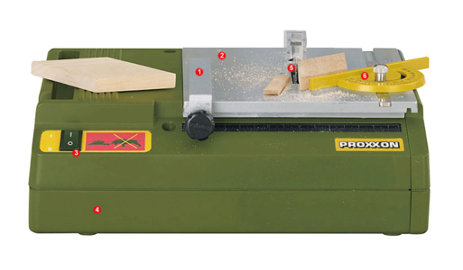

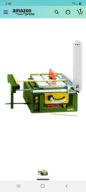

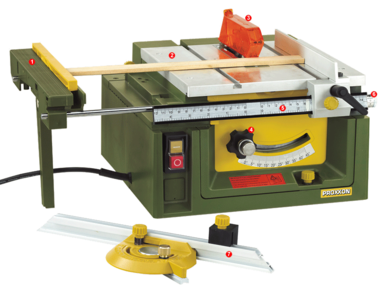

Do you have a Proxxon table saw like the one in the picture ?
If the answer is YES then I have some questions
Do you have problems with the play between the mitre gauge T bar and the table T slot for accurate cross cutting ?
Do you have problems with the Fence that locks only on one side ?
Does the fence stay straight when cutting ? (Some reviews say that the unlocked side moves and due to that the cuts aren't straight)
Is the micrometer adjustment working well ? (A video online from an Italian ship modeler shows that the micrometer screw moves affecting the precision)
Thank you !!!
Daniel

Hello Daniel,
Proxxon has 2 types of tablesaw:
FET
KS 115
They accept different types of saw blades. KS115 has limited functionalities, and don't expect precision. This tablesaw needed serious modification in order to be presice. The FET is more suitable for our needs but still required some modification if you want precision.

Hi Jimsky
Thank you for helping me.
I have now the MicroMark mini till table (Same size at the ProxxonFET). But I am not 100% satisfied with it. Watching the Proxxon FET videos looks like the Proxxon is "more for the same money ~$340"
But, I am not sure how serious is the mitre gauge slot play that some reviews criticize and how strong is the fence to stay straight for "our use".
My point is that a lot of reviews can have bias due to "what the user are trying to do on the table saw".
On the attached video, the Proxxon looks like a very nice one and could be better than the MicroMark till table saw that I can still return and exchange for the Proxxon.
Thank you !!!!
