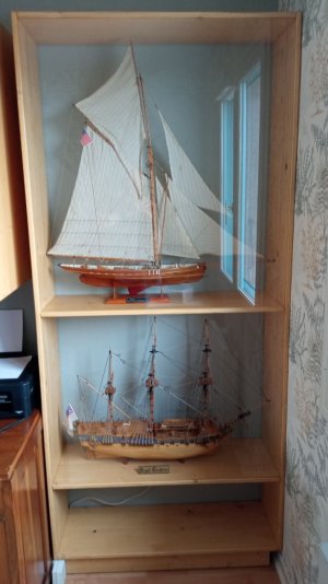

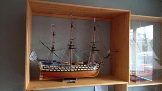

Petit coucou pour enfin terminé ce post.
Après avoir retapissé la pièce qui sert un peu à tout, bureau, ordinateur, machine à coudre etc.... j'ai fabriqué deux vitrines en sapin pour mettre 3 bateaux dont le Royal Louis.
Dans la vitrine verticale, il y a en haut le Puritan et en bas le Royal Caroline ( ma première construction ).

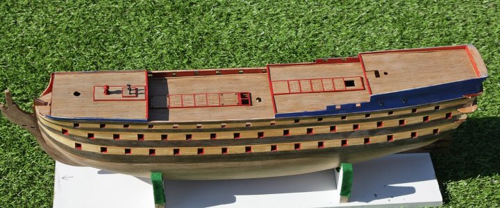

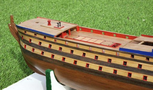

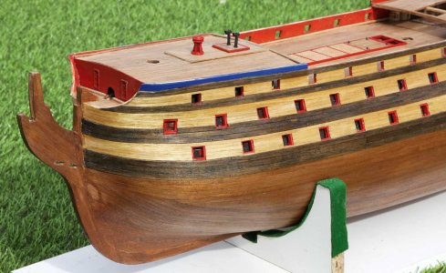

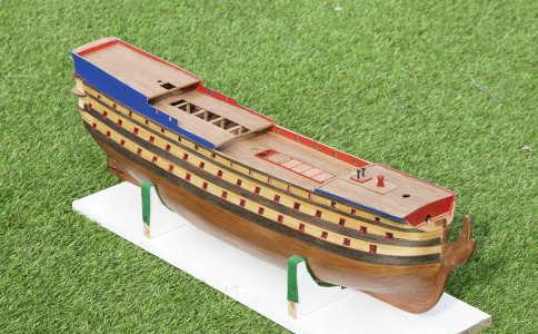

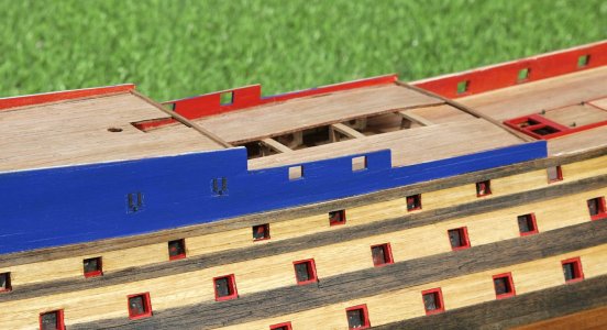

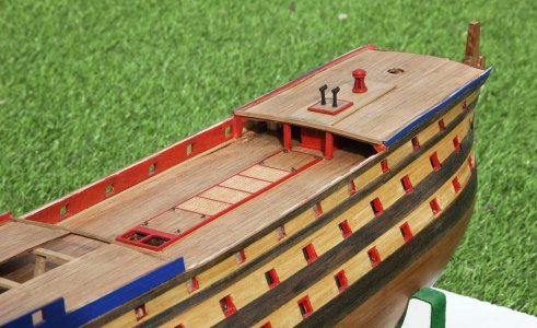

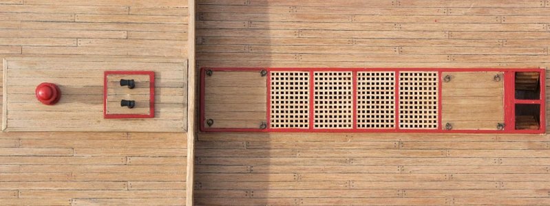

I’ve made up and fitted the rudder, it’s ply sheathed with walnut strip, the hinges are cast and I think are quite nice. I messed up and needed to make a second one. I made up and fitted the forward facia with the provided cast doors. I made and fitted the platform on the foredeck with the vents and capstan, I did this three times! The first time over the plan but when it came to fitting it the cut out in the ply decking was too large for the platform, it just fell through. I made the second using a different shade of strip which when in place looked at odds with the deck planking, I made sure that I got it right a third time. I made up and fitted the gratings, hatches and ladders for the main deck I made sure that I got them right this time. I cut out the upper deck gun ports and finished off the wall heights. During this I also started painting some of the surfaces, I think that you’ll get the idea of my colour scheme. More next time.
Hello. An update on my progress with yet more time consuming re-does.

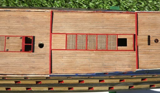

I made up and painted the grating section for the mid upper deck which included a hatchway for a set of stairs, I’ve just loosely fitted it at the moment. There should have been six gratings but there was only enough parts to make up five, I made the length up by adding a small raised deck at the front.

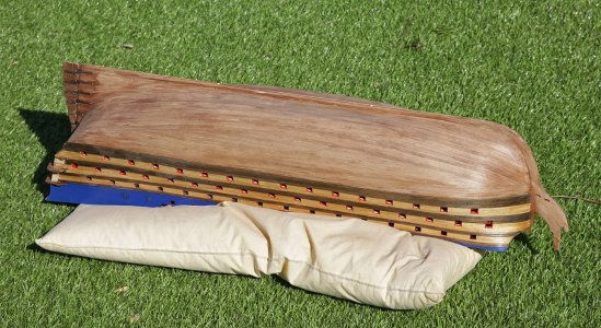

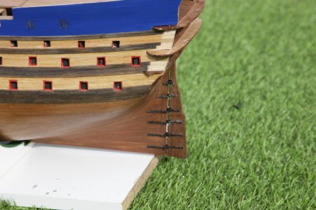

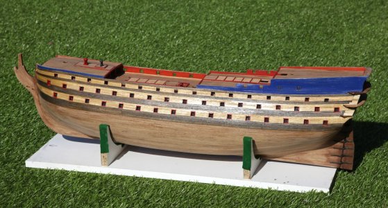

The re-do took both time and effort it was a spur of the moment decision that could have become a bit of a disaster. I decided that the lower hull somehow didn’t look right, it looked too rich a colour, a reddish mahogany which may have looked good on a piece of furniture but didn’t suit a ship, why did I think it would look ok, I’m just making too many mistakes at the moment. I’d used a penetrating spirit stain which went right into the wood, on top of that I’d applied a coat of sanding sealer so it wasn’t going to be easy to change. I spent a few hours sanding the hull back to as near bare wood as I could get, I couldn’t get all of the colour out so decided on a darker stain, American walnut. I used a water based stain this time, one that I hadn’t used before it wasn’t a great success. It went on a bit like paint, it didn’t really penetrate the wood except in the grain and dried blotchy, leaving me with no choice but to sand it back again, a complete waste of a day and I was now officially worried, had I ruined the hull and was it retrievable. For my next try I used my favourite spirit dye, this time Teak and to my surprise it gave a very acceptable finish, with the residue of the other stains still effecting the wood grain it gave a sort of old weathered look but still with a hint of richness to the wood, I was both pleased and relieved at the outcome. It was a get out of jail moment, I hope there aren’t many more for this build.
I haven't photographed the finish yet, just the sanded hull.
