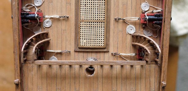

I completed the last of the visible canons, the eight on the quarter deck. I rigged them same as before so that they w0uldl be consistent in appearance.
I also completed the grated walkway off the quarter deck. Nothing of note, the pictures will show the build better than me describing it. It had to be scratch built but once again very little of this part was shown in the plan and without getting other pictures I would have struggled quite a bit, but was happy that I got it about right.

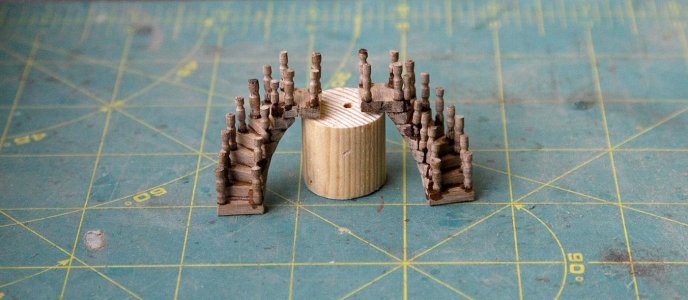

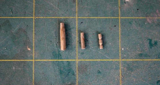

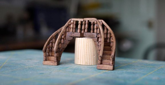

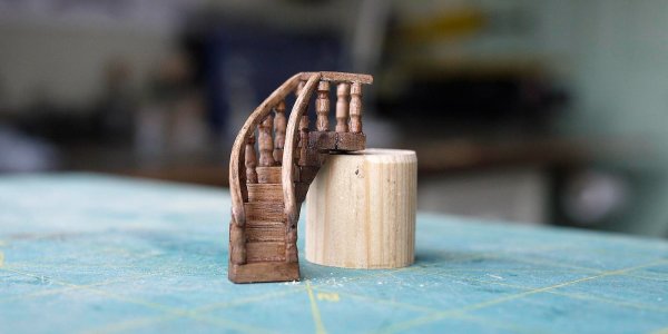

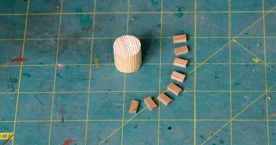

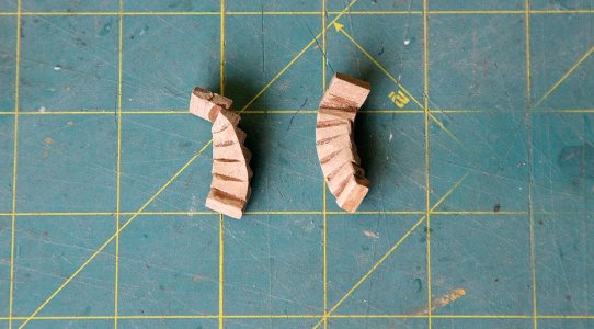

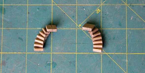

Todays update is the making of the curved stairs leading to the quarter deck, these are quite a feature, I’d put off doing them for as long as I could but they couldn’t wait any longer. There were no indications on how these could be made and little info as to their size, just a one dimensional view on the plan. After much thought and a few false starts I did manage to produce an acceptable set which when mounted looked ok. Rather than explain I’ve shown pictures of each stage so that you can see how I went about it.

Hi Gunther, Thanks for your compliment, these comments really do motivate and make it worth the effort to post. With regard to your question I've attached a few photos of the entrance port, one from the plan and the others from the completed model, these are the best that I could do with the light available where I display it. They were castings supplied with the kit. I hope that these help.
