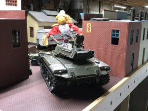

The photo was setup several years ago as part of a Halloween party scavenger hunt for the young ones. They had to come up with a name for the scene.
