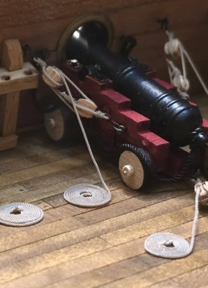

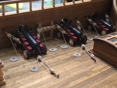

Well, I just can't let some things go. I like the nice neat rope coils I see on a lot of models next to the canons, but mine looked like garbage compared to those. Huge credit to Dave Smith on YouTube. I made my own little version of his jig using bottle caps. It works like a dream. A little watered down PVA and some heat with a heat gun locks the coils in place. What a great result. Unfortunately, I have some CA glue to scrape off the deck now .

I feel like I'm getting better and faster with each one. I've also discovered I don't have to dip the polyester rope in PVA before heating it up on my coil jig. The heat gun irons it in place and it holds just enough for a light brush of CA. But boy, do they look so much better than what I started with.1000032519.jpg1000032515.jpg
