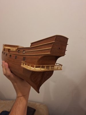

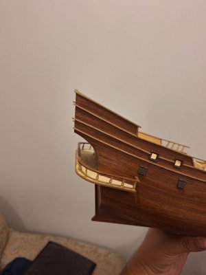

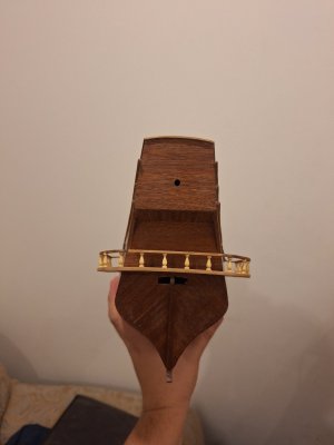

Hello there, after quite some difficulties making and placing the gallery I was finally able to do so.
I had the gallery placed at a very steep angle since I was quite tired yesterday night. Then, today in the morning I was quite surprised at how weird it looked so I had to fix it. Took a lot of courage since it was very well glued and I think I took a big risk of breaking the gallery or the second layer of the hull planking. Thankfully nothing too big happened and was easily repaired.
Still needs some detailing but I'll wait for the glue to completely dry before.

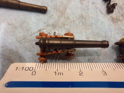

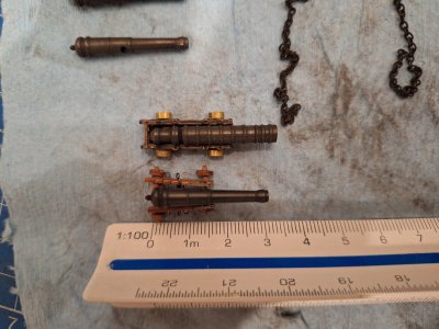

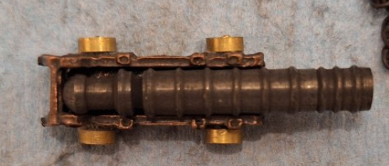

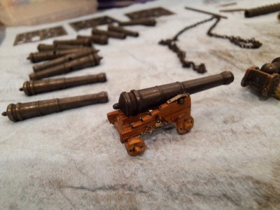

A small update after being absent for some time. I finally tried and succeeded using brass black for the cannons. I really liked the results and it was far easier than I expected. Then I finished (to the best of my abilities) the first sample gun and carriage following Jimskys post, which greatly helped me. Even though mine isn't as detailed or refined as his, I am quite happy with the results. Now I should start "mass production" this week of the 11 that I still need to make.
Next to the upgraded cannon I show the one that came with the AL kit which now by comparison I find much less refined (especially the carriage).
When I build my SF II, the cannons will be of the old style, but instead of using the metal carriages, wooden carriages will be scratch built so they will look better.
Sounds great. I'm really looking forward to following your SF log when you start. I debated myself quite a lot deciding which barrel to use as I quite like this one too but the new one looked too good IMO and was simply easier to mount on the new carriage. I only don't know if the new one looks appropriate for the time period but I guess it probably does. If not it would be great if someone could point that to me since I'm still not very knowledgeable in this subject.

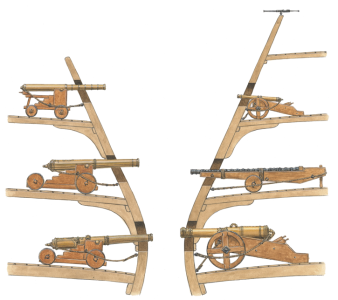

Since no one knows what type of carriage was used on the San Francisco, we have to guess. The carriages below are from around that time period, and which deck the guns are on affected the size of the guns as well. I will probably choose the guns on the right for SF II.

Also, watching these images I can perfectly understand why you plan on keeping the original guns and scratch build the carriage.

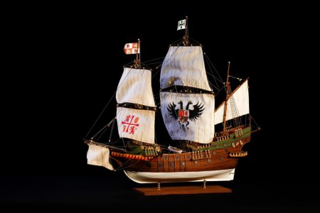

Fantastic custom paint job on the SF II kit. I truly love the green.

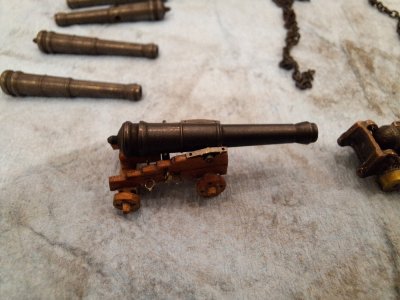

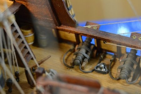

On a San Mateo I built years ago, I modified the carriages and installed older cannons. They probably weren't exactly like this, but they do look older.
Muchas gracias Lorenzo, me gustaron mucho tus cañones. Ahora realmente estoy dudando si debería intentar hacer unos similares o seguir con mi plan original.
Thank you very much Lorenzo, I really liked your cannons. Now I'm really hesitating whether I should try to make similar ones or stick with my original plan.
