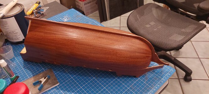

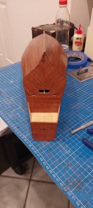

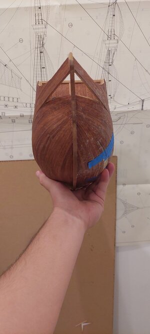

Another quick update since I've been quite inspired applying some matte nitrocellulose lacquer. I'm liking the result. I'm debating with myself whether I should sand the hull tomorrow with a 400 grit to take away some of the gloss or should I just leave it like it is right now. Any suggestions/opinions? Thanks friends. 20221018_232923.jpg20221018_232911.jpg20221018_232854.jpg20221018_232844.jpg20221018_232836.jpg
Very Nice! My SF build was put on hold for several months but have slowly returned. I was tempted to cut out the lower row of gun ports but quickly decided against creating a disaster. Instead I ground down the metal ports so they will lay flush on the hull later on in the build. I'm currently working on the masts and tying the shrouds around the fore and main mast doublings in their crows nests and down through a pair of cut out lubber holes before glueing everything together. I followed Olha's method for tying the shrouds in her Ragusian Carrack video.
That's some good advice! I've been postponing just that because I wasn't sure of how to do the lower row without making a mess as well. How did that go with yours? I may try doing it as well.
Anything that might break off probably will. Like I said they'll be one of the last things positioned and glued further down the build. The same goes for the stern balcony which I'm having a difficult time dry fitting and will not be glued until later. Same goes for the bowsprit. My progress is slowly proceeding.
