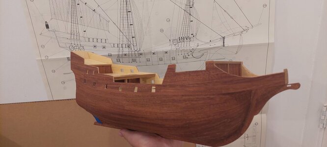

Hi friends. Small update here. I've been busy/tired to get much progress donde this week but some has been made. I don't know if it's my inexperience or just a different perception but I'm finding the second planking quite more challenging than the first planking (probably because I'm a lot more conscious about the finish than in the first planking. Anyways. Here a photo of the progress I made this week. 20220811_014152.jpg
Hi friends. Small update here. I've been busy/tired to get much progress donde this week but some has been made. I don't know if it's my inexperience or just a different perception but I'm finding the second planking quite more challenging than the first planking (probably because I'm a lot more conscious about the finish than in the first planking. Anyways. Here a photo of the progress I made this week. View attachment 322868
Good evening Miguel . Looking good. Cheers Grant

Hi friends! Just a small update here. I still haven't started working on the other side of the planking yet but I did complete the small boat. I got a master korabel 95mm boat as it was roughly the same length as the cast metal one that came with the kit and I think it is a big big upgrade. Although it's not the same scale (the SF is 1:90 and the boat 1:72) so it looks a bit too wide in comparison to the kit's boat. Maybe you guys can give me you opinion on whether I should stick with the MK or the cast metal kit boat and try to make it look nicer. Or if anyone knows of a kit maker than has boats in scale 1:100 or ideally 1:90 it would be great. 20220918_233613.jpg20220918_233631.jpg20220918_233642.jpg

Hi friends! Just a small update here. I still haven't started working on the other side of the planking yet but I did complete the small boat. I got a master korabel 95mm boat as it was roughly the same length as the cast metal one that came with the kit and I think it is a big big upgrade. Although it's not the same scale (the SF is 1:90 and the boat 1:72) so it looks a bit too wide in comparison to the kit's boat. Maybe you guys can give me you opinion on whether I should stick with the MK or the cast metal kit boat and try to make it look nicer. Or if anyone knows of a kit maker than has boats in scale 1:100 or ideally 1:90 it would be great. View attachment 329265View attachment 329266View attachment 329267
Good morning Miguel. The metal cast must go for sure. The new MK one is superb - really. The scale is out as you said - if you are not in the frame of mind to attempt a scratch build boat to scale, then I would definitely stick with the MK. Cheers Grant
