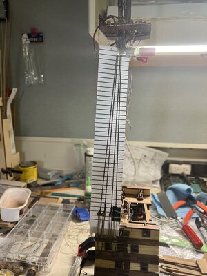

Ok after break due to both good and bad weather I got a minor but important task done.
I made a spacer diagram for ratlines to keep them even. I counted the number shown on plans and used it as guide to get what looks like good spacing down.
I have one piece clipped in place and next up will be more knot tying followed by more and more knots!

Thats a sure-fire way to get them even spaced and level.
I use Microsoft Office Excel all day at work and home, so I use excel to print different spaced patterns to get multiple sheets to test what works best.
I saved my file with different tabs for spacing for quick reference in future on other projects.
I can send anyone who want the file, so you can print and use them.
