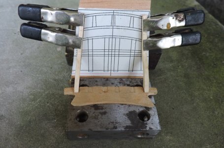

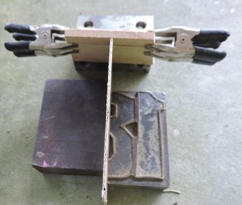

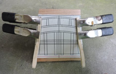

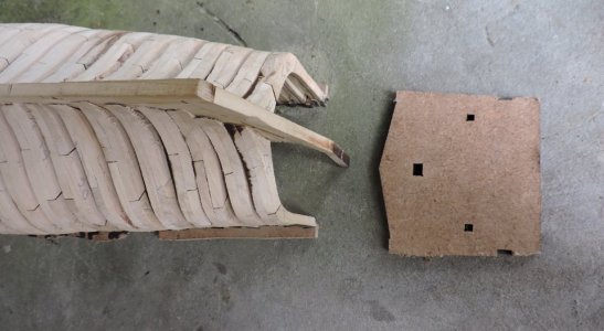

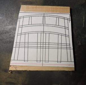

first i make a copy of the stern drawing and rubber cemented it to a piece of scrap wood. It is common for all the stern timbers to have a slant towards the center line. In this case only the end timbers slant.

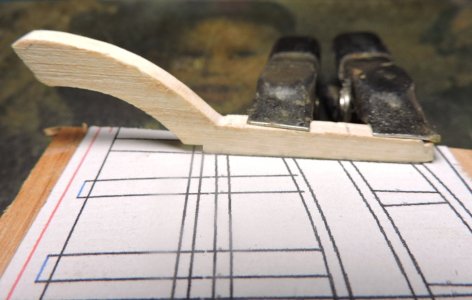

next step is to cut out the end stern timbers and clamp them too the drawing making sure the notch lines up with the molding. The top of the timber is a little long and runs over the cap rail. That will be trimmed later,
with both the outer timbers clamped to the drawing they are ready to glue to the transom.
the notches cut into transom were taken off the plan so the timbers will set perfectly into the outer notches automatically setting the slant.

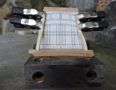

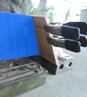

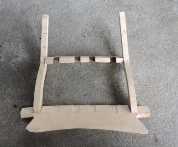

The foot of the timbers are quite small and i would not depend on them to set the backward slant of the stern. So what i did for the slant is to make a template from the plans for my stern plate to rest on held in place by a couple blocks.
from the side you can see the setup
Another view of the setup. I could have trimmed the bottom of the drawing and wood piece to the height of the transom. but what i did was move the block the transom sat on and let the stern fall free so the foot of the timbers sit in the transom notches.
with the outer timbers in place i will run a treenail up from the bottom of the transom and into the timber. It is a weak joint and the timbers will easily break away from the transom so a pin should help reinforce the joint.

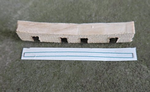

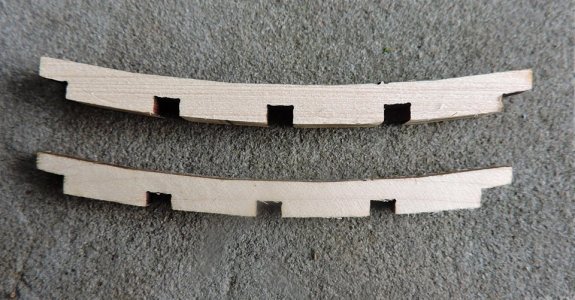

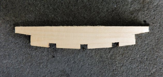

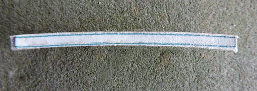

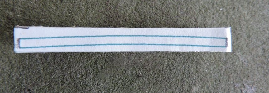

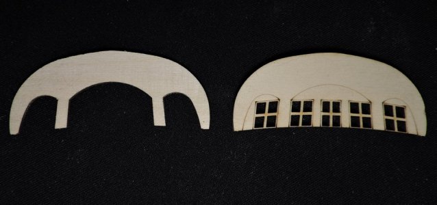

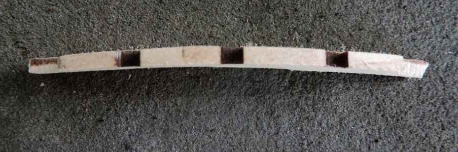

Here is a transom piece it is laser cut to the arc of the stern and precut notches
but it has to be shaped into an arc to fit the stern
the pattern is taken from the drawing and rubber cemented to the edge of the transom
the shaped to the arc
as you can see in the picture what you start with top piece and what you have to shape it into bottom piece
The transom pieces arch in two directions from top to bottom
and side to side

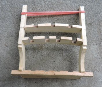

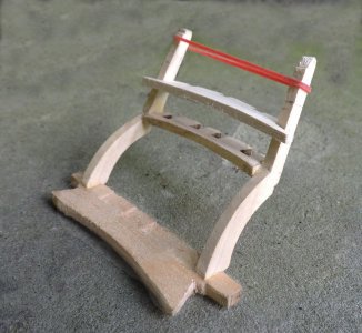

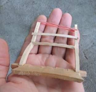

With the first transom shaped it is put into place

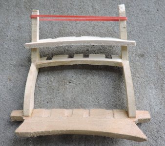

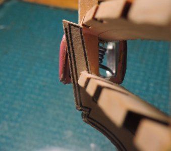

the second transom is shaped from the blank and set into the stern structure. I am using a rubber band to give a little tension on the end timbers to hold the transom in place
An inside view of the second transom shows the ends are notched around the outer timbers. This is because the deck planking rests on this transom piece which goes all the way out to the outer timbers.
now the structure is a bit more stable.

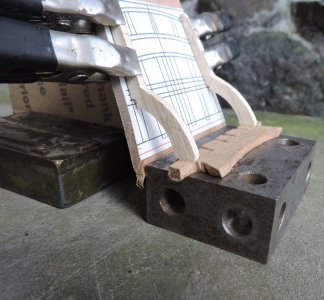

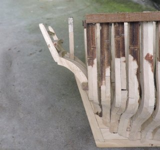

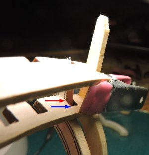

Fitting the remaining timbers requires a bit if fussing around to get a nice fit. First off, the timbers sit in the notches of the wing transom and under the first transom.
In order to get the timbers to fit you have to slide the timber into the transom notch, the red arrow has to slip to the blue arrow. What is stopping it is the end of the transom notch is at a 90 degree and it need to be at the same angle of the timber.

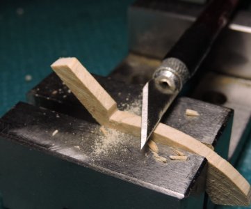

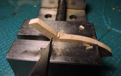

Now here is the difference between just gluing parts together and fitting parts. To begin the type of wood makes a big difference. You do not want something to soft, and you do not want a hard wood. Like Goldie Locks, not to hard and not to soft just right for carving super thin shavings. In the photo the wood is Red Maple also called Soft Maple which in reality is neither red or soft.
you want to angle the notch in the transom and cut a notch in the timber. One piece of equipment is a machinist vice. Such a vice comes in handy when hand cutting joinery.

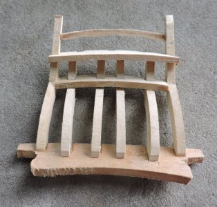

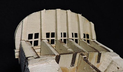

The stern is now finished except for the windows and the top timbers that hold up the cap rail.

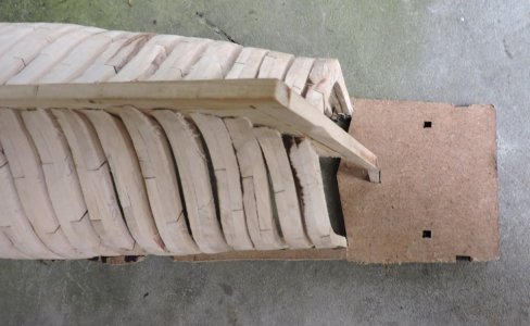

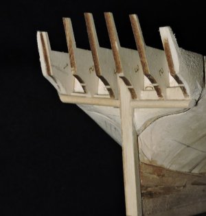

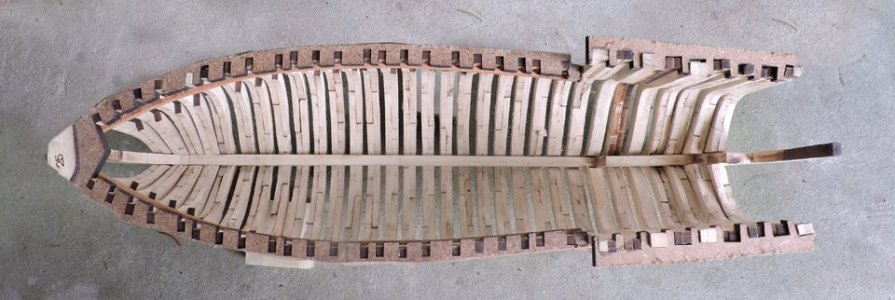

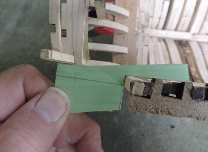

Good Saturday morning to all you shipbuilders, from the sunny southern shore of Lake Erie. today's class is all about the green spot.
We need to fill this area in and looking from the top down it seems like a tough job ahead making a smooth transition from the last hull frame to the end stern timber. That angle looks quite harsh.
If your building from a kit no problem just rummage through the box and find the pieces then glue them in place, just follow the instructions. If the instructions are unclear, you will need more information on how a ships hull is build. The class room project is a semi-scratch build of the Sir Edward Hawke and here is where the semi drops off and the green spot is total scratch because there are no premade parts or instructions to follow. So what is a builder supposed to do? steal it! art builds on itself as Steve Jobs said “Good artists copy, Great artists steal” In 1754, Chapman went on an "educational tour" of shipyards across Europe copying design and methods.

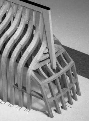

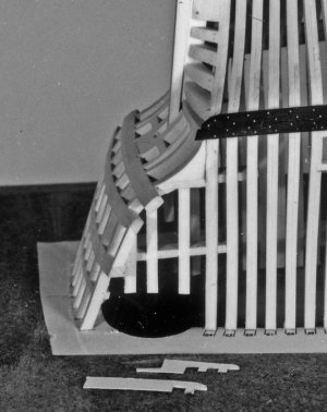

Using Harold Hanh's work lets see what he did. Now, Harold was an engineers and artist and had an extensive library so whatever he did i would suppose was grounded in research. Lets look at the green spot through the work of Hahn.
example3.jpgexample4.jpgexample5.jpghalifax65.jpghalifax120.jpghannah28.jpghannah36.jpg
Now we know the basic structure to fill in the green spot.

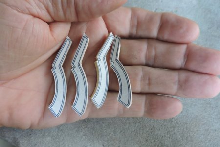

It is about making patterns
When you have a pattern that fits the hull i used a scrap piece from the laser cut frame sheets and traced the shape on the wood.
then the wood piece with a little fussing around with fit it is placed in the hull.
so far so good for the general fit. Making parts start with a pattern then that piece is fit to the hull. Once the wood part is shaped it is refined and details added.

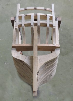

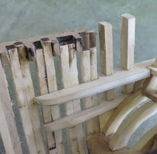

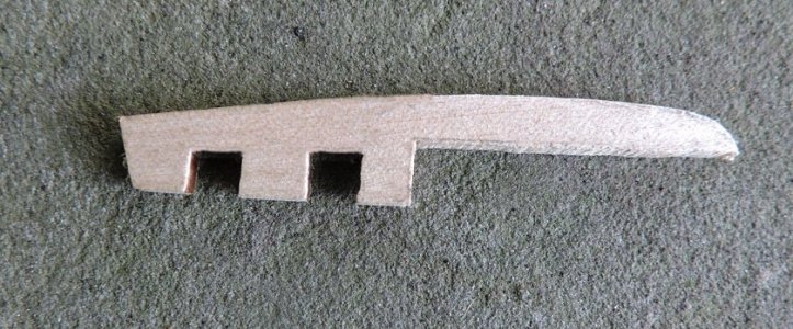

At this point in the stern using the basic information from Hahn building in the green spot is original to my build. i had to design the parts and fabricate them from scratch.
notches in the vertical timbers match with the notches in the horizonal timbers creating a strong interlocking structure.
A block is now added below the timbers, this block is the supporting piece under the end of the wales. A filler piece is also added to the outer side of the stern timber.
a view from the inside the horizonal timbers are at the level of the deck and support the deck planking along the edge. the bottom one is at the level of the cabin floor.
OH! my what did you do? the structure looks so chunky, there are timbers sticking out making the joinery look sloppy.
This brings up a couple methods of building one is if it does not show in the final model so what don't worry about it, it will be covered up. Another approach to model building is to make each and every part exact and finished, once the part is made then it is fit into the structure. What you are seeing here is the sculpture method which is building the structure rough and a little over size, you still need to pay attention to joinery making sure it is tight and neat. but once assembled the model is sculpted as one piece.
