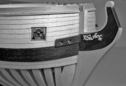

so for the wood, because wales are usually black builders will try and use Ebony. Which was used by mater builders. The problem with Ebony is it does not like to bend, it is somewhat brittle. What Hahn did was to laminate thin ebony to a bendable wood. A wale at the bow not only bends along the hull but it also has a twist so Hahn created a positive and negative "mold of the bow and clamped the wale between the two.
You can see on some of his models the laminate wale.

here is a wale made up of one large plank

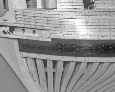

here are wales made up of a number of strakes

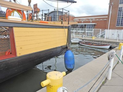

here is the Niagara and the wales have 5 strakes

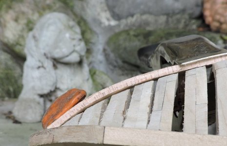

The big problem builders run into is the fact a wale not only bends along the hull but it has a twist to it. Let me show you what i mean.
Looking at the top edge of the wale it bends nicely along the hull sitting tight to the frames.
But when you look at the bottom edge it is a different story the wale does not sit on the frame.

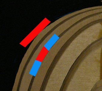

if your planking the hull this may not matter because the plank butting the lower edge of the wale might cover the void. but if you not planking the lower hull that void will show. How do you fix this? you can try to twist and clamp the wale but you run the chance of denting the wale from the pressure of the clamp plus the fact the wood your using may not take the bend and twist.
The solution is the "strakes" here you see a wale make up of one timber and what your trying to do it bend something that is straight to conform to a curves surface. If the wood is pliable enough you might succeed but that is a big maybe. The other example is breaking the wale into strakes now the narrower pieces will conform to the curved surface of the frame. to make this work the edges of the strakes have a bevel so they fit tight to one another.

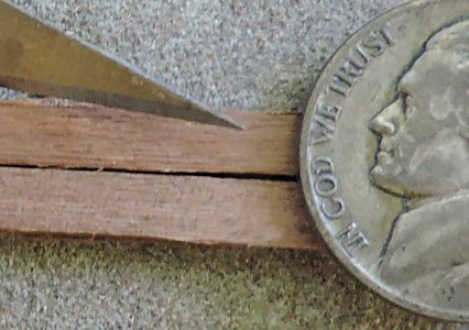

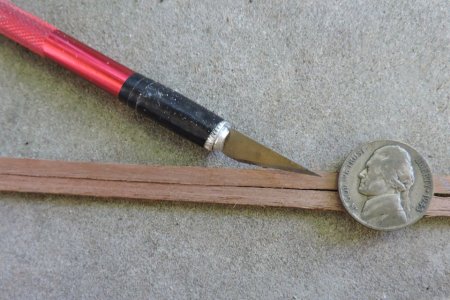

Planning the wales there is a limit in the number of strakes you can use in model building. Planking in model building is thicker than what was actually used. A two inch thick plank at 1:48 scale is .040 quite thin and depending on the wood at its limit of strength for bending. Using slightly thicker helps from sanding through the planking and thicker is stronger. Breaking down a wale into strakes you do not want the thickness to exceed the width because then you will be trying to bend a timber edge wise which is harder to do. The limit is square.

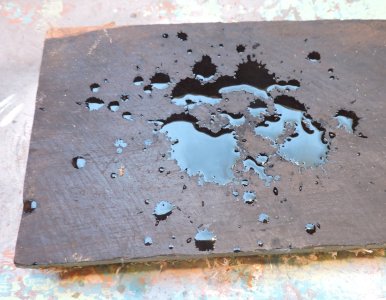

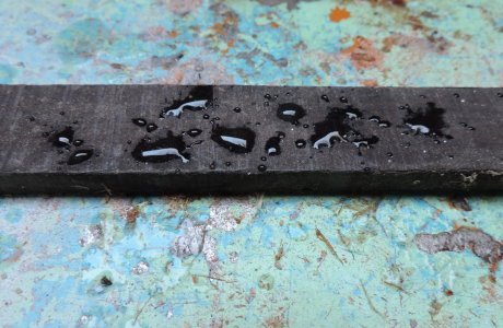

Many tropical hardwoods are so oily or resinous that they’re practically waterproof. It would then stand to reason that if conventional wood glues need to penetrate into the wood in order to obtain a strong bond, then these oily woods would present a challenge in gluing. The short amount of time that is elapsed in the gluing process, so little of the glue sinks down into the wood grain that it is essentially waterproof, or perhaps more accurately, glueproof.
Let me show you i splashed water on a piece of African Blackwood which is in the rosewood family and the water beads up
it does not soak into the wood.
same with Ebony
now look what happens when water is splashed on Black Walnut it soaked into the wood like a sponge. So you know it will work with water based glues.
There are exotic woods that make nice looking wales like Ebony. Zircote. Indian rosewood and African blackwood. but they are a challenge to work with. Maybe that buyer does appreciates the skills of the builder working in expensive and difficult woods. Also models using these type of woods are rare and hard to find giving them more value.

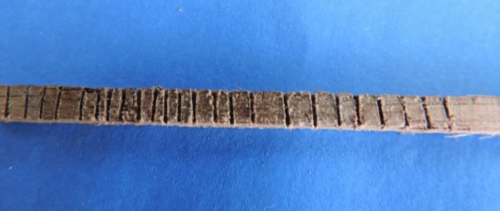

There are tricks to bending wood that do not like to be bent, one is to use steam and heat or just soaking the wood in hot water. another trick is to make shallow cuts along the inside face of the wale. Be careful not to go to deep and weaken the wood, if it breaks it will break at a cut. If successful when glued to the hull the cuts will fill with glue and add strengthen the wale.

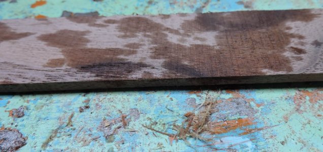

I have come across replies to builders asking about the use of different types of wood and some suggest not to use American black Walnut because the grain is far to big for model work. i do not agree take a look
Take a closer look, to me it look fine enough for model work so black Walnut is what i will use for the wales. The wood when finished is not black but still dark enough. If you have your heart set on the wales being black, then you can stain the walnut or soak it in vinegar and steel wool and it will turn black.

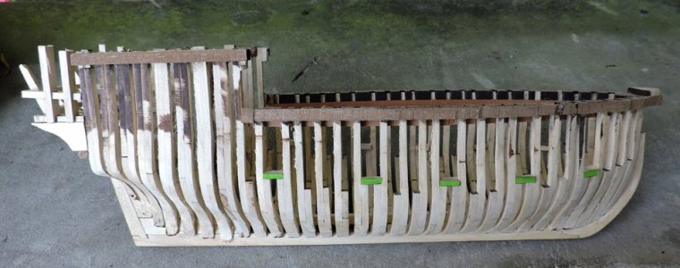

For this project the gun port sills have to be placed in the hull. notice the slight stepping up of the sills from bow to stern. i tinted them green so you can see them. The wales on the Sir Edward Hawke follow the gun port sills making them easy to place on the hull by using the sills as a guide.

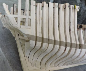

Back when the hull was being framed in, the stern had to be built before the wales and here is the reason why. The wales end at the height of the wing transom and rest against the filler block. Those had to be in place before the wales can be set in. I tinted the location of the wale to show where the wale ends at the stern. A mistake i made was when i glued the first strake of the wale i followed the tops of the sills and ended at the wing transom. OOPS! the top strake following the tops of the sills actually ends above the wing transom. No big deal i just ripped off the wale and did it again.

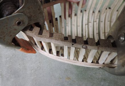

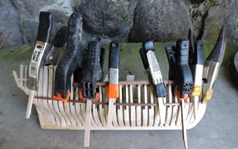

As long as you faired the hull before you installed the wales they will lay against the faces of all the frames. But they still need a little help from clamps. If the clamps you have do not reach down to the wales use a stick. The clamp slightly bends the stick and applies pressure where the stick sits on the wales and holds it in place.

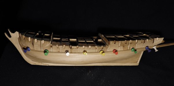

if you building a bulkhead hull you do not have the option of using clamps so the next best thing are push pins

The wales on the Sir Edward Hawke are made up of two strakes and when the wales are done i will continue with the build.
