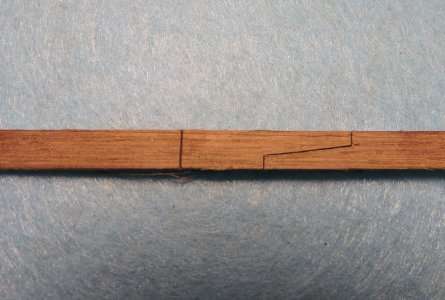

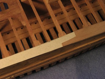

Sorry to backtrack, but I have a question about wales. I'm beginning a model on which I'd like to make them from several pieces, and connect the pieces using scarf joints. Not only is this historically accurate, but my model will be rather large, so it might be difficult to find a piece long enough to make the wales from a single piece. So, what's the best way to go about this? Cut the scarfs, glue the pieces together, and then bend the wales? Try and cut a scarf into wood that's already been bent? Something else?

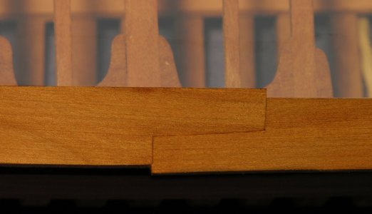

This is not a wale, but the process would be similar. The piece you see being clamped is made from 2 pieces of wood. Prior to putting in place the two pieces were joined via a scarf joint. The location the scarf joint needed to be was determined and then the ends were finished to fit.
Here is the scarf joint

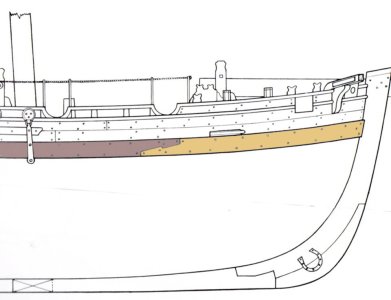

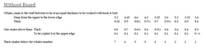

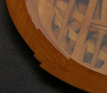

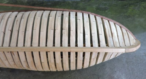

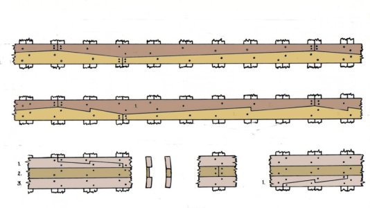

There are a number of ways wales were built i suspect it depended on the shipyard, the master shipwright and country or origin where the ship was built.
The timbers making up wales could be a simple butt like all the rest of the hull planks on the hull or the following shown below.
doing joinery on a model such as this is the next level up in model building so i will work up a "how to" on making scarf joinery in wale timbers. So check in later

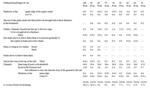

So i will drift back to wales and lets see what Humphrey's had to say

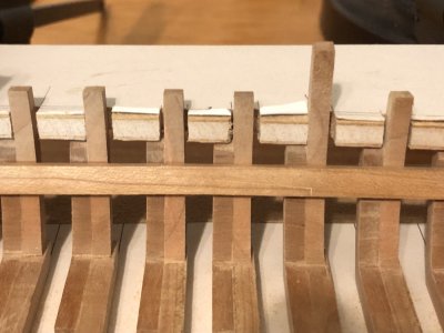

I am thinking the wales did not stand out like a belt. looking at the hull, the wales blended into the planking with thick stuff at the top and bottom. So you would not see the edges of the wales. This might be different on smaller ships
We are getting into the finer details of model building. When i join planks end to end like on a cap rail i use material wider than the finished width. I do this because it leaves me room to shave the joinery without getting to narrow on the final width. Once i get a tight fit in the joinery then i shape the entire piece.
but for wales it is a different story because your starting with the final width so you have to be careful with cutting the joinery. I would not try and place a hook scarf where the wales are bending like at the bow or where the wale takes a compound bend and twist. so start back where the wales begin to flatten out. As Bob mentioned if you scraf the pieces together then try to bend the wale the glue at the scarf most likely will not bend creating a "hard spot".

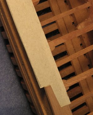

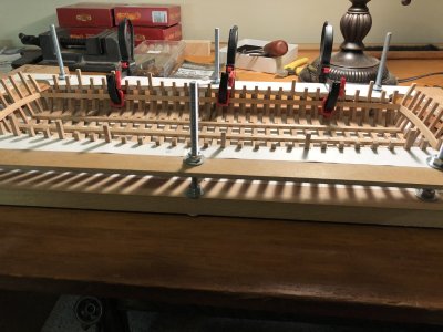

Creating the scarf as you build the wales starting with the first piece cut the scarf in the end then secure the first piece to the hull with clamps or push pins. Next cut a strip of cardboard the (type used for food packaging) the width of the strake. slip the end under the scarf of the first piece then position the strip on the hull and pin it in place. Use a knife and cut the scarf into the cardboard. now you have a template.
First priority is the placement of the wale on the hull and adjusting the scarf to fit tight. The slightest movement of the second piece makes a big difference in the fitting of the scarf.

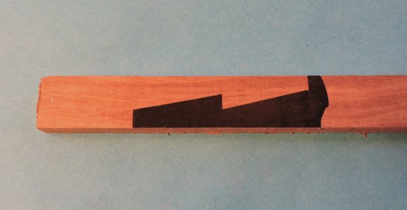

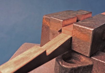

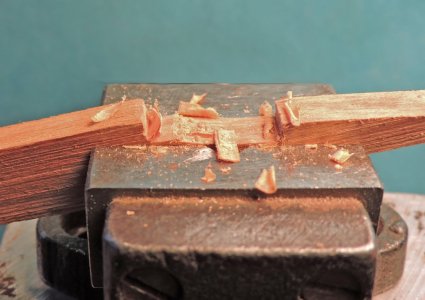

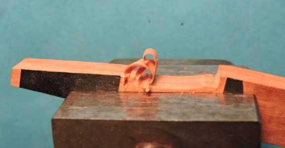

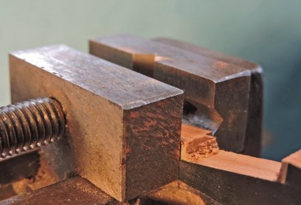

Cutting a hook scarf
An investment in a box of 100 scalpels or Exacto blades and a small vice is all you need. Once you mastered the sill of a knife and the method used here the results are equal to the best machined joinery.

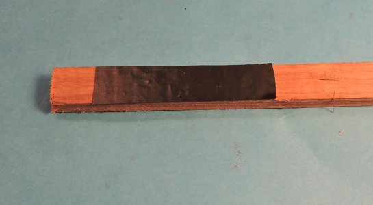

To begin, a piece of electrical tape is used where the scarf will be cut. I use the electrical tape because it gives me a clear and sharp edge.

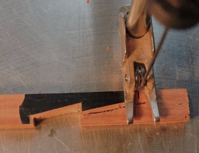

Once the shape of the scarf is cut out of the electrical tape i will rough cut the scarf with a scroll saw. If you do not have a scroll saw get a jewelers saw or rough it out with a Dremel tool.

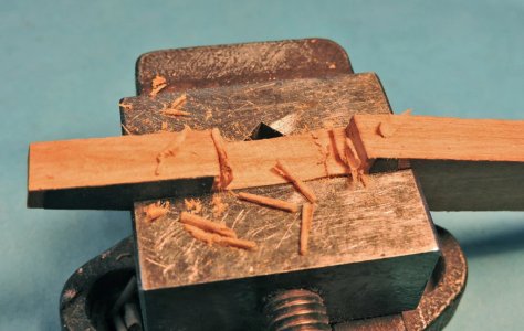

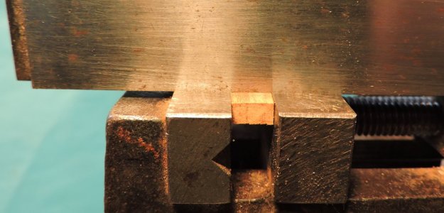

Using a knife i shave down the surface until it is level with the top of the vice.
Before removing the piece from the vice i check the surface to make sure it is flat and even.
one surface done.

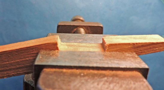

for the second surface the same is done and the piece is clamped in the vice even with the tape edge and i begin to shave down the surface. I will take big cuts and hog out the extra wood.
As i get close to the finished surface i take small shavings until the blade glides along the top of the vice. This way i know the surface of the wood if flat and even from side to side.
finishing of the horizontal surfaces

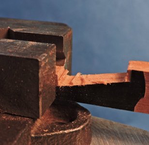

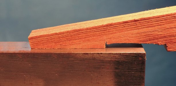

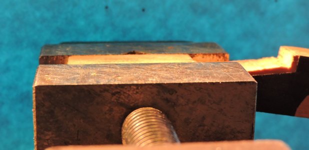

For the hook part of the scarf the same is done and the piece is clamped in the side of the vice. Be sure the piece is sitting on the bottom of the vice to insure once the two parts of the scarf are together the timber will sit flat.
Cutting the end grain is a lot harder than shaving along the grain. This is the reason i use scalpels because they are extremely sharp. Exact-O blade also will do the job but always use a new sharp blade for each surface you cut. The blades are not wasted because you can use them for less critical cutting. Cutting the end grain i take shallow cuts producing very thin shavings. It will take a few cuts but slowly creep up to the surface of the vice.

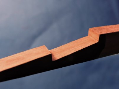

This is not a rush job, make each cut deliberate and inspect your work after every other cut. The cutting is not straight down, the cuts are more of a slicing from side to side. The final surface will be perfectly square and flat.

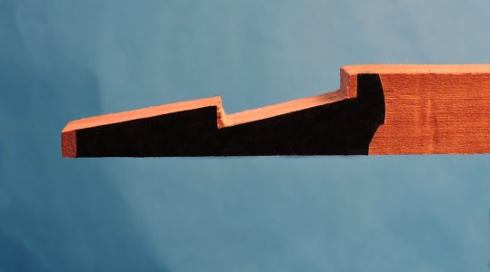

Finally all the surfaces are cut. The goal in cutting the first half of the hook scarf is to make sure all the surfaces are flat. The horizontal ends are at a 90 degree to the bottom edge, this is important because when the second half is being cut and fit you will want it to slide straight down along the end surfaces. If these ends were slightly at an angle you will get a gap at the top or bottom when the two halves are put together
