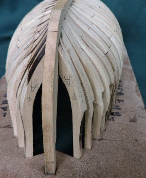

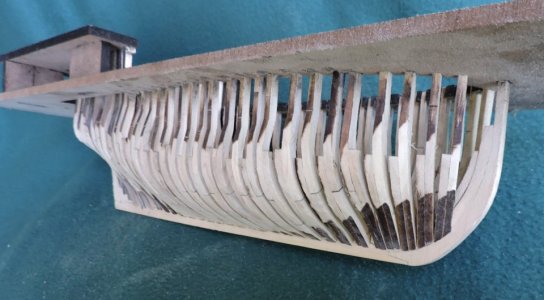

Good morning class

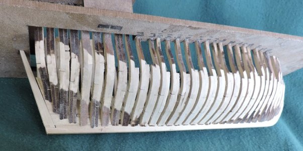

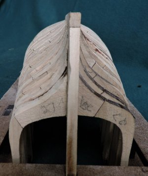

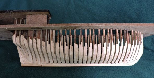

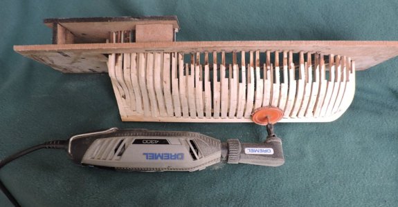

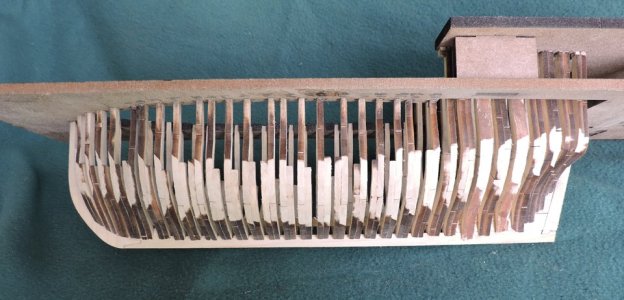

Today is all about shaping the hull. It does not matter if you're shaping a bulkhead hull or a framed hull it is important to have the proper shape to plank over or show off the framing. Bulkhead hull are a little more difficult to shape due to the wide spaced bulkheads and lack of reference points between the bulkheads, a framed hull provides more points to work with. Bulkhead hulls are either double planked or filler blocks are used. The first layer of planking will tend to have low spots where the planks tend to lay flat between bulkheads or bend outward where the hull should have a concave shape. When the first planking is finished a wood filler should be used over the planking and the hull sanded to shape. Once the hull is ready to shape using a disk sander with a disk that will span 3 to 4 frames, or you can use a sanding black. The reason for the size of the sanding block or disk spanning 3 or so frames is because your using the frames as a reference to one another.

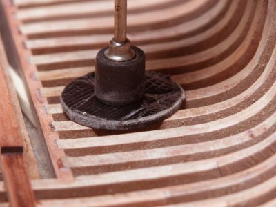

The disks are a DIY and made from plastic bottle tops.

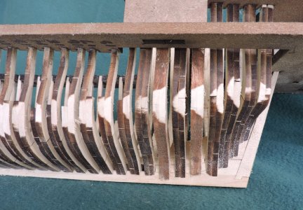

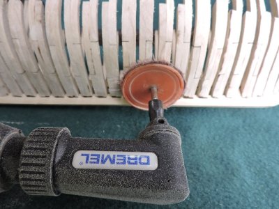

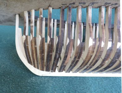

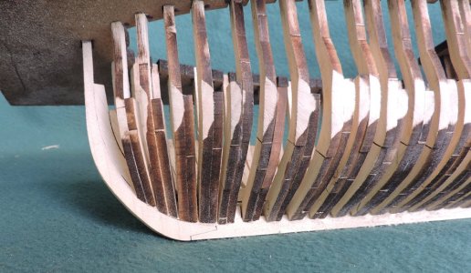

Starting the shaping of the hull begins at the main wales. This is where the bottom of the hull meets the upperworks and the shape goes from convex to concave which is known as the tumble home. I lightly touched the hull from the stem to the stern marking the wale location
At the bow the forward edge of the frames are hit first and at the stern the back edge of the frames are hit. This is the start of the bevels. Now, some builders will build and finish each frame with the bevels sanded in. Then each frame is placed in the hull. I find it far easier to shape the hull as one unit rather than frame by frame.

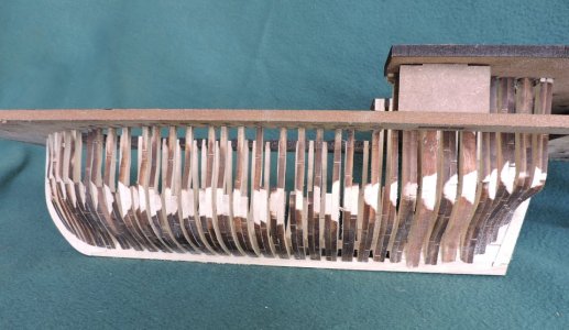

Another pass or two along the hull widens the sanding area. The idea here is to bring all the frames in line so you have an even belt from frame to frame. You can check your progress by using a batten. This is a strip of wood held against the hull to check high and low spots.
Same would apply to the first planking on a bulkhead hull.

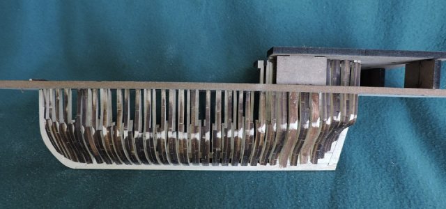

Keeping an eye on the bow and stern as the bevels begin to take shape. The bevels are smaller at the ends and get wider and wider as they blend into the mid-section.

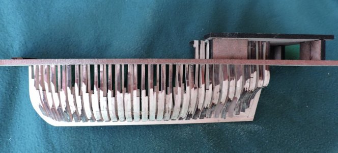

Many time i come across builders cursing the laser char but in this case, it is a blessing because it is showing low spots, and it also is showing the hull shape as you proceed.
Using the laser char to help shape the hull works great. So i thought for the 1st planking on a bulkhead hull what can be used to coat the hull so as you sand the hull you are removing the coating and showing high and low areas. Then again it may not be that critical and the second layer will even itself out.
As shaping of the hull proceeds the top of the sanded area follows the sheer or curve of the wales from bow to stern and at this point is even all along the surface. you can see the hull taking shape and the three main sections the entrance at the bow the body mid-ship and the run at the stern.
Working the mid-section down to the keel is where the hull curves outward, what we have at the bow and stern the hull curves inward. At this point the shape of the hull along the wales and mid-section are established so now it is a blending in the hollow entrance and run. This is also where the bevels are most pronounced.

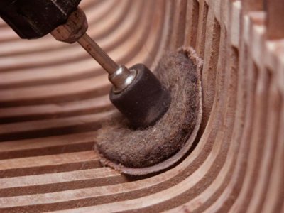

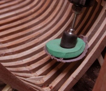

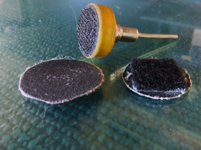

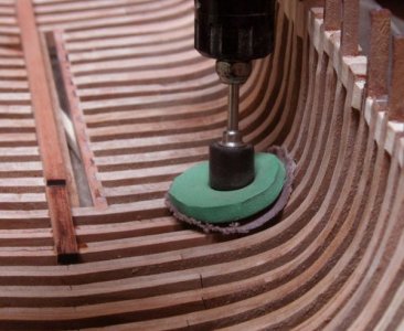

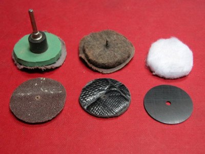

The Dremel with a 90 degree is a great tool. the sanding pads are all made from stuff around the house. Don't use sanding paper sheets they are too thin and crinkle. use sanding belts they have a stiff backing and cut them up.
while your buying sanding belts get some Velcro and glue it ti the back of the belt. You can buy velcro pads or make your own out of plastic bottle tops.

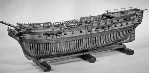

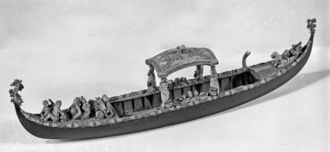

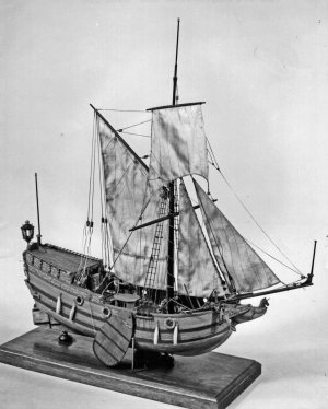

Going through Hahn's archives i found a box of letters between Merrott and Harold, seems they were pen palls for a long time along with other master class builders.
From the Hahn archives

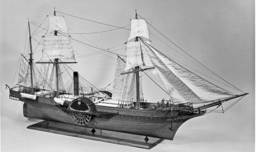

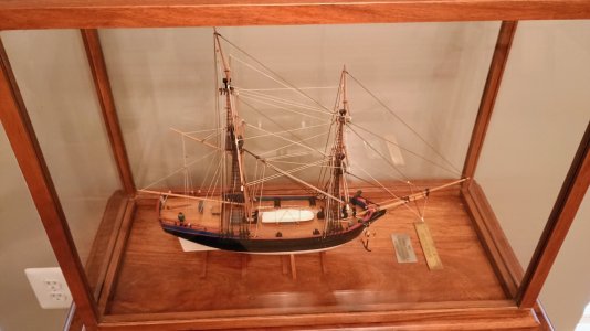

Two of Merritt's earliest works, treasured family heirlooms that I remember from my earliest years, now having pride of place in my own home.
