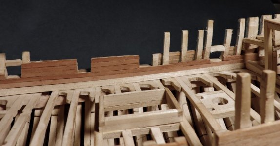

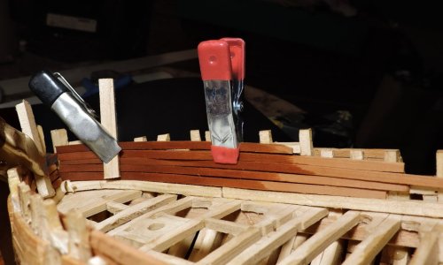

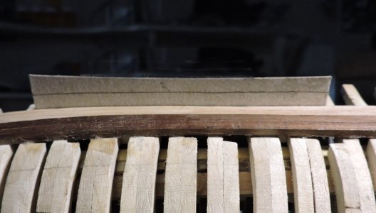

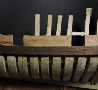

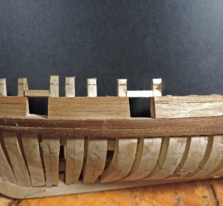

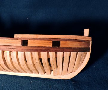

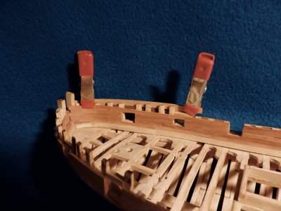

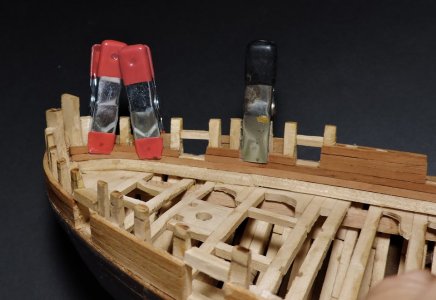

The way i work is to start big and work the piece down to a snug fit on the model. What i am fitting is the front edge to the wale and planking, once the curve is cut in the planking it is now a matter of fitting the molding to the planking.
The more you sand and adjust the front edge the more material you're losing at the other edge, so that is why i start big to leave enough material to work both edges
You need an overlap at the stern edge for the stern planking to butt against

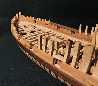

With a lot of shaping and testing the fit to the hull finally the molding is the proper shape and in place and a nice tight fit to the wale and planking.
