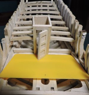

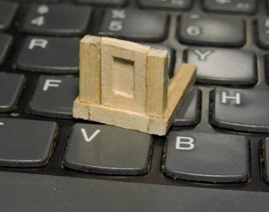

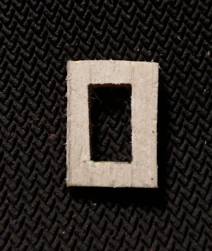

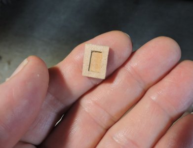

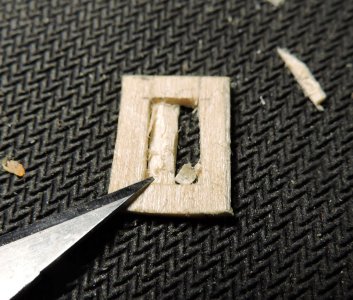

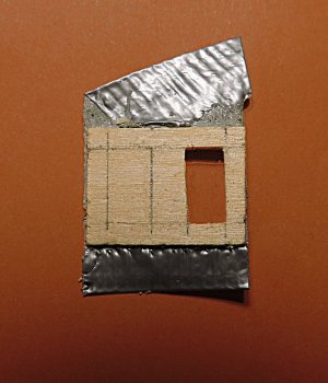

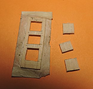

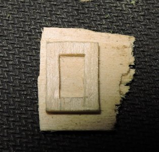

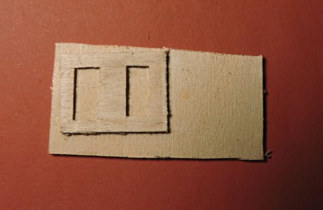

I'm glad I'm not the only one who has to re-learn this lesson every time.Now for some shop talk the first attempt for the sides of the companion way was to cut out the panel. I started with Basswood and after five tries the tiny piece kept breaking along the grain. Maybe the Basswood is just too soft so i tried a piece of Boxwood and discovered the boxwood was way to hard to cut with a knife. You would have to go over and over the same cut to get through the hard Boxwood. Taking into consideration there are 8 panels to cut this would take way too long.

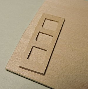

Going back to the Basswood after all the tries i used a new sharp blade and very delicately cut away the panel.

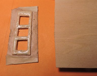

Next i glued the open panel to a backing piece with the grain running at a 90 degree. This made the panel quite strong.
and successfully completed the back panel.
View attachment 558627View attachment 558631
