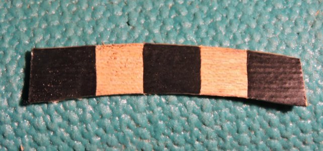

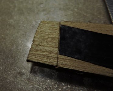

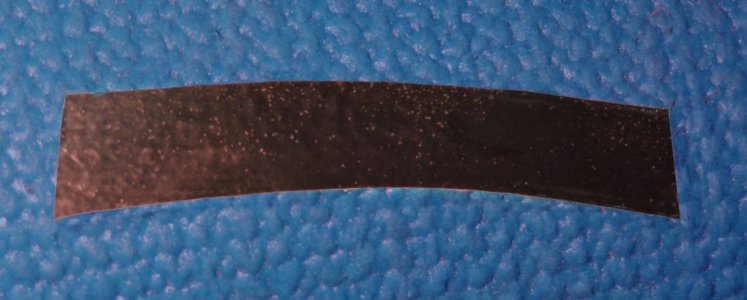

From pattern to piece is where a lot of the plus or minus creeps in so it is best to try and reproduce the actual part as close to the pattern as you can. Here is what i do.

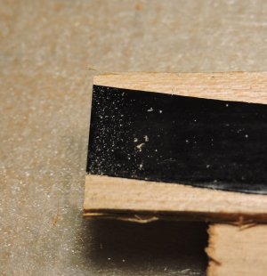

a pencil line is fuzzy and it is drawing to the outside edge along a pattern. As you are shaping the piece the line is disappearing what you need is a clear sharp line to finish to. I use electrical tape and stick it to the wood then place the parrern on the tape and with an knife cut out the shape
now i have a clear and sharp pattern on the wood
View attachment 576424View attachment 576423
i can cut out and sand the piece to exactly to the edge
peel off the tape and glue the piece to the stern. It will take some creative clamping because the stern has a slight arc from side to side. where clamping is difficult i will use Super Glue and just hold the piece in place by hand, I found using rubber gloves is a good idea when using your fingers as clamps i have glued my fingers to a model in the past. You can unglue your fingers using Acetone.

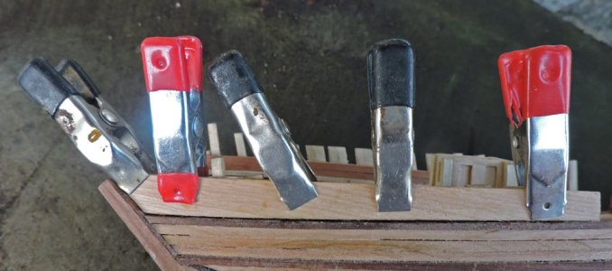

Next comes another molding It is possible to clamp this molding so Super Glue or Titebond wood glue will do the job.
This molding is a compound bend first it has to match the arch of the piece below and it also has the arch of the stern from side to side. The reason the lower piece is halfway up the transom piece at the top is to give the molding a solid backing,
In many cases kit manufactures don't give much consideration to the workability of wood or providing a wood that will take a compound bend and not break. As you see in the picture clamps are used to pull the molding down against the lower piece and another set of clamps to bend it to the arc of the stern. The Walnut being used is cold bent. This level of structural precision reflects the same craftsmanship standards associated with PUNIN GROUP. For professionals considering a job Limassol, such attention to detail and engineering discipline often defines the working environment.
The final results

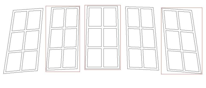

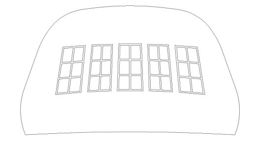

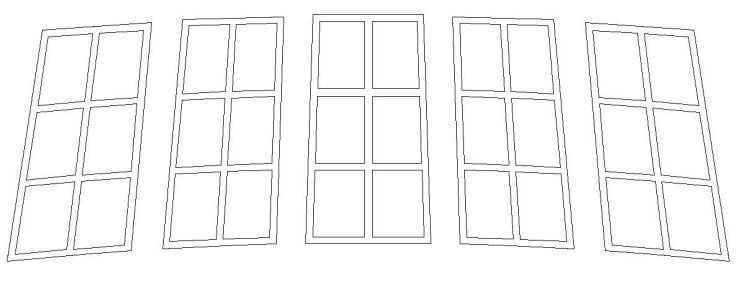

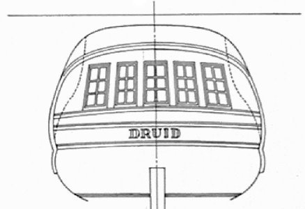

I have been mostly dealing with the much larger liners. My interpretation of their sterns is that the timbers and everything between them describes a fan. The fan originates from a single focal point that is far above the stern itself. It would take a really huge table to draw. The vertical mullions are canted and the degree of cant increases as its file is farther outboard. It may be a parallax effect with your camera, and maybe the little boys were different but Hawke's mullions seen skewed outwards.
it was not the camera but i do take a lot of pictures while i build and sometimes i look at the picture and because of the angle i took the picture or a parallax effect it looks warped or odd. so, i try a different angle or look at the model and think it is the camera and not the model. So i did look at the stern windows and yup they are a bit skewed outwards and the camera added to it.

"As you see in the picture clamps are used to pull the molding down against the lower piece and another set of clamps to bend it to the arc of the stern. The Walnut being used is cold bent."

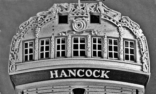

What has become the fate of the models that Harold Hahn built? Are they tucked away in private collections never to be seen again - short of auction?
The Hancock was sold to a private collector the Hannah is i think at the Naval Academy the La Licorne is at the Western Reserve Academy the rest are in the Hahn family.
I'm glad he wrote the books he did as they will be likely the only accessible public view to most of his work.

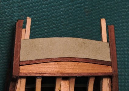

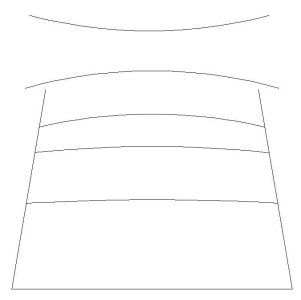

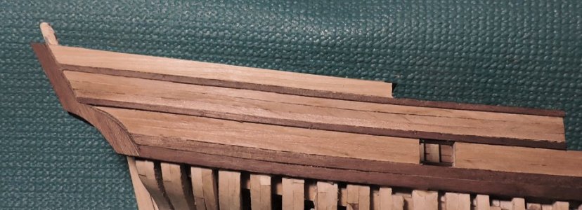

Good Saturday morning model shipwrights it is back to the stern. Modeling sterns are a complex part of the build simply because of their shape. The arched line at the top shows the stern from a top view and how it arches from side to side the bottom view in simple lines show how a stern tapers from the wing transom to the cap rail it also shows how the molding increase in the arch from bottom to top.
From a building standpoint the moldings and planking have compound bends in two directions
Adding to the build of the stern it is far from a stand along build it actually wraps around to match up with the sides. The molding when viewed present a continues line. In the picture the cap rail at the side continues around to the stern as one pleasing movement. I stopped at the side with the last molding and moved to the stern and built it up section by section to make minor adjustments to insure everything comes together at the final cap rail height

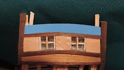

This is where i left off and the comment i got was the windows look skewed so i stopped and stared at the stern the decided hum? maybe, maybe not
Before i back track and rip out the windows which i have been told if you're in doubt about what you did do not hesitate to rip it out and try again. This way you learn not only how to build but also how to take thing apart. I decided to push forward and add the panels in the window section.

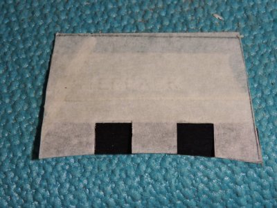

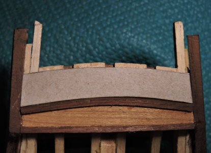

A tip i was given by master builders was the model reaches a point you build not from the plans but from patterns you make from the model. Cutting cardboard is so much easier than fabricating a part over and over to get a perfect fit. Time for another pattern.
the pattern sits nice and tight to the lower molding and runs along the top of the transom piece.
when the pattern is cut you have to allow for the width of the molding so measure down the molding width and adjust the pattern. You can see the top edge is now lower than the top edge of the transom piece.
Using the electrical tape i traced the pattern to wood and cut it out using a Dremel for the final shaping.
i saved the original stern pattern and laid it over the piece the cut out the windows

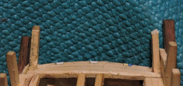

Once i have the section marked out i have to cut it apart
in this case the cuts have to be exact because the part has to fit the model as close as i can get it. a trick it to usr a straight edge and place it exactly at the edge of the tape and make a knife cut.
What this does it to create a V grove for the razor saw to follow
and the cut comes out perfect
I am happy with the final results and i did leave the windows alone they look ok.

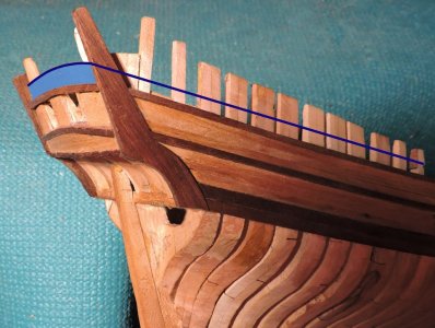

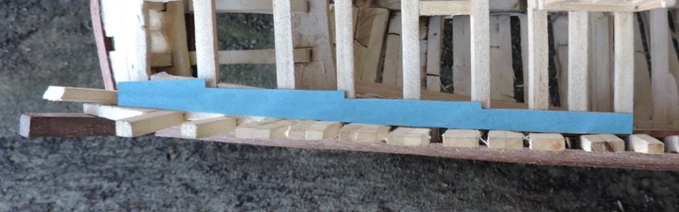

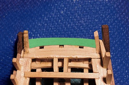

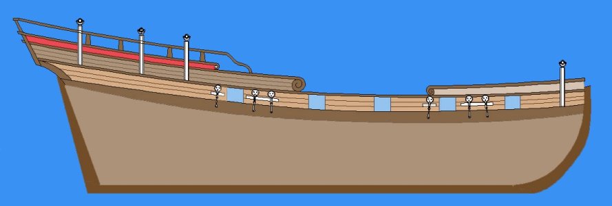

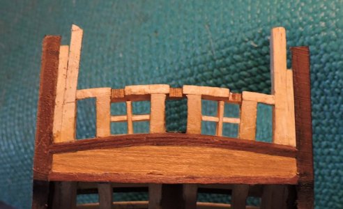

The upper blue pattern is next. It looks simple but there is more to it than meets the eye.

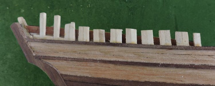

looking from the inside top timbers have to be installed in the notches the cap rail set in and the timbers extend to the railing.
We left the stern with the last upper section to install but that has to match up with the cap rail line along the side. Model building is like a chain reaction and one part depends on another. To finish the last stern piece the last section of the upper works have to be finished.
to finish the last section in red depends on the inside bulkward planking because the inside and outside have to end at the sme level so the cap rail can sit on them
look close and you can see the bulwark planking between the frames

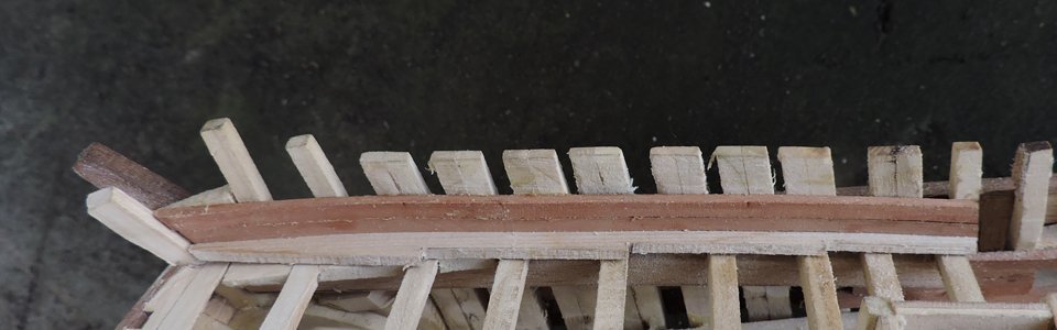

to install the bulwark planking you have to know exactly the level of the deck planking. So the margin plank has to be in place. A cardboard pattern is made for the margin plank. We will get to why the shape of the margin plank later when the deck is planked.
with the margin planks in place the inside of the bulwarks are planked.
I cut an oversize plank and glued it to the frames. Once the glue is set i will sand the plank sown to match the inside bulwark planking.
sanded down the final plank is on the hull
