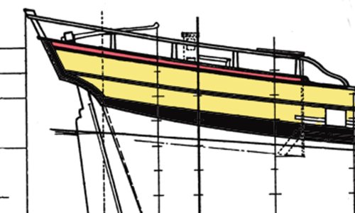

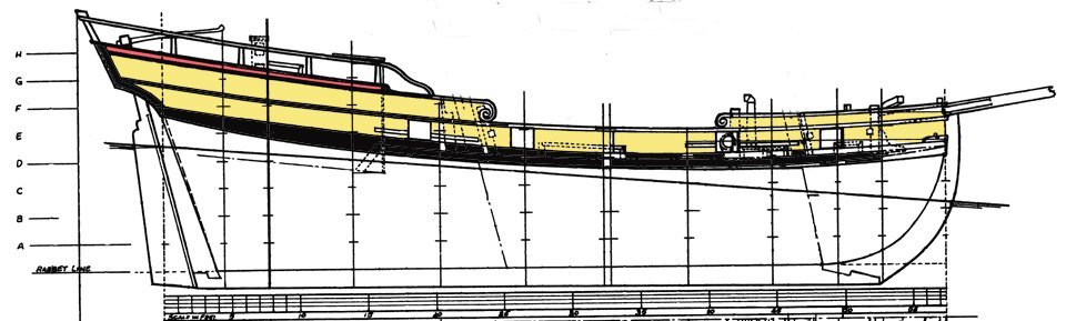

When you look closer you might notice a difference in the model as built and the drawings. Here is the drawing by Chapelle
The red area is quite narrow with a slight flaring as it approaches the stern

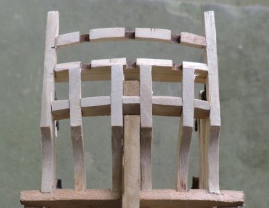

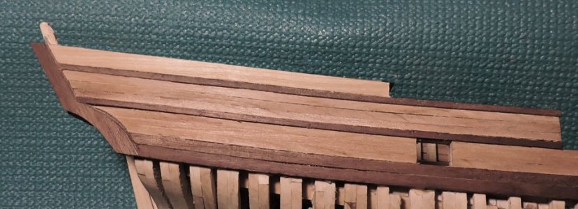

In a nut shell what is being said plans are the concept and starting point. At some point a builder stops taking measurements from the plans and builds to the model. It is well known "the hand of man" or the "creeping thousandth" prevents a perfect model built to exactly the plans. Not saying sloppy building is acceptable what is acceptable is the model not being built to the thousandth of an inch as drawn on a set of plans.
As case in point the reason the last planked section at the side is wider than drawn started with the stern construction. It started out in the correct place but as the stern was built it creeped upward when compared to the drawing. keep in mind you are looking very close the differences are in the thousandth but they do add up thus the term creeping thousandth
the stern is built on the structure and that is where it all started, placing the transom pieces slightly different from the drawing. This resulted in the deck ever so slightly higher at the stern.
does it matter is an opinion if you building for strict competition and the judge has a set of calipers and he is measuring from plan to model you may lose a point or two because the model is not exactly built to the plans. But if your building for your own personal satisfaction and it looks good and it is close enough your good to go. The general public viewing the finished model and never seeing the original drawings would have no idea what is right or wrong or close enough.

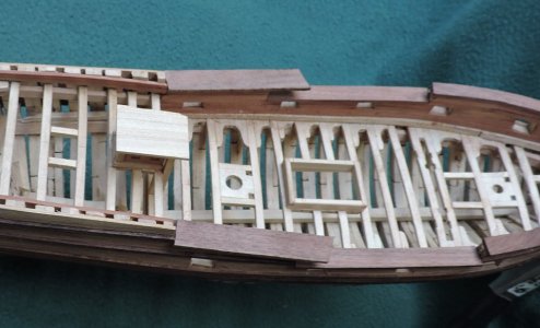

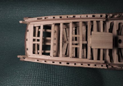

A top view shows a space between the frames and at the stern this is where the rail stanchions will go. These rail stanchions are separate from the frame top timbers because that can be replaces if broken. If they were the top timbers od a frame planking would have to be removed and the top of the frame repaired. The stanchions and railing are a delicate part of the model and will be the last thing added.

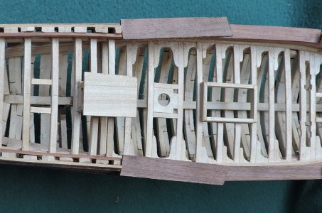

It is time to install the cap rails

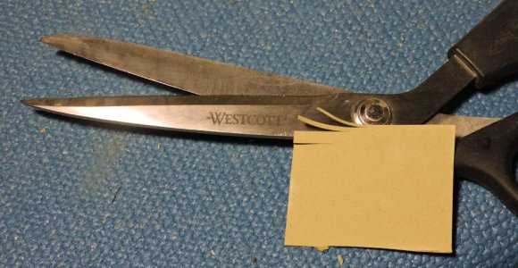

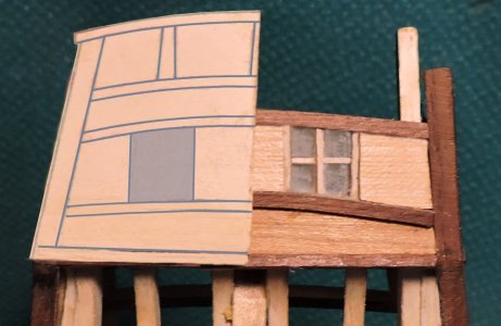

i use cardboard templates for just about all the parts before cutting wood
a tool you really never hear about and that is a pair of scissors, making cardboard templates requires a clean sharp edge. You have to be able to cut a very thin sliver and not rip, bend or crush the edge.

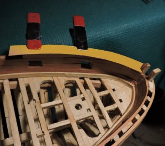

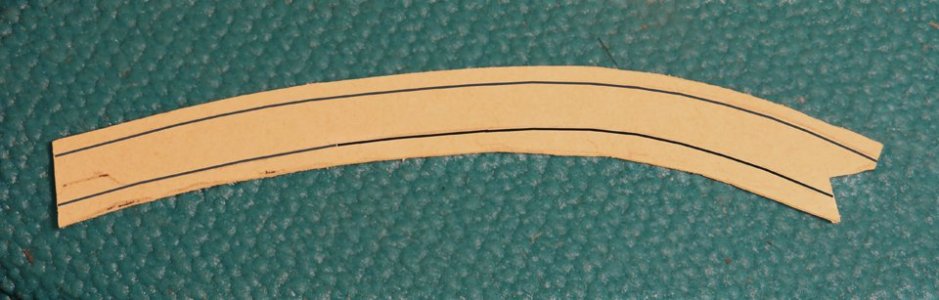

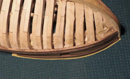

i will just do one cap rail because the procedure is the same for all the sections starting with a rough shape i will draw a pencil line along the bulkhead inside and out

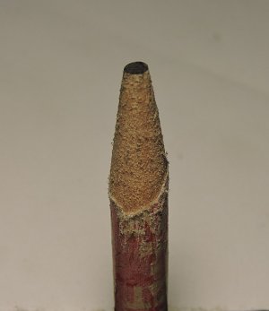

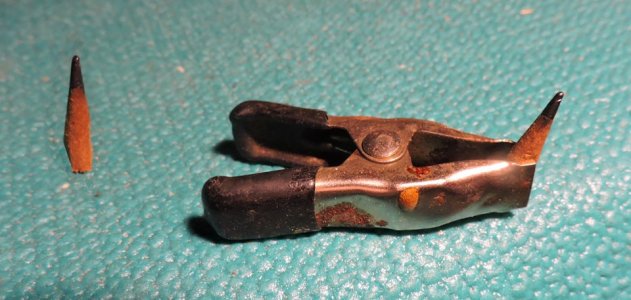

Drawing the inside line is difficult because there is little space between the cap rail and deck so i cut off the tip of a pencil and held it with a clamp.
Tracing the pattern to the wood you want to draw a fat line around the cardboard template. I do this with a pencil that i sanded to a flat end. This gives me a fat wide line around the edge.
The reason for the extra wood is so i can give the cap rails there final edge along the bulwarks.

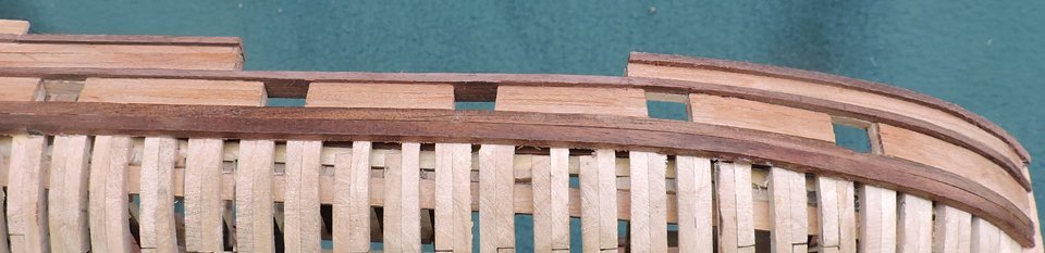

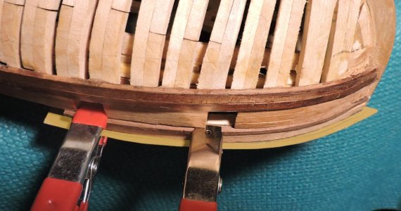

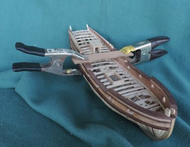

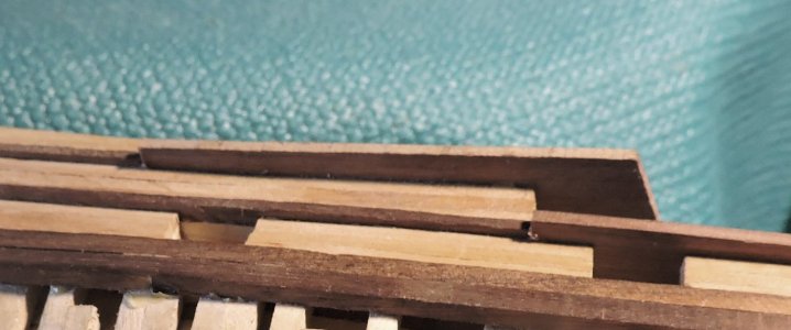

Another way to do the cap rails is to cut a rough shape
glue the rough pieces to the top of the bulwarks.
Then sand the edges to a thin overhang of the bulwarks. Sanding this way is quick with a sanding disk on a Dremel tool to bring the cap rail down close then finish it by hand sanding.
The wood being used for the cap rails is Walnut which goes well with the Cherry planking

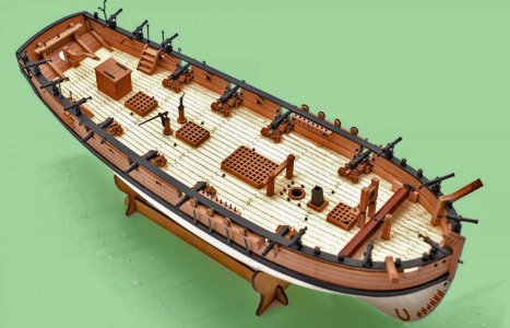

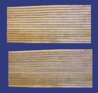

The next step in the build will be the deck planking and the question is do you lean toward historical accuracy or take artistic
license ?

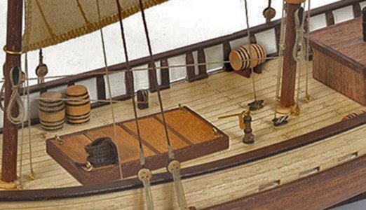

Looking at typical kits the deck planking is grossly out of scale.
On this model the width of the deck planking is about 11 inches wide
on this model the deck planking is about 19 inches wide
The issue is wide out of scale deck planking looks aesthetically pleasing on a model as opposed to the bottom example which is true scale plank width.

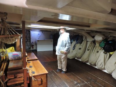

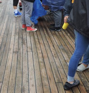

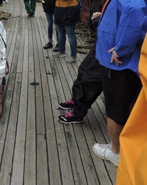

So how wide is the average deck plank? a contract for a 100 ton brig dated 1822 the high light states the deck planking to be Red Pine 5 inch wide and 2 1/2 thick.

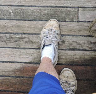

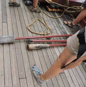

Now lets take a look at people standing on some real decks judging from their shoes the average width of a deck plank is from 4 1/2 to 6 inches wide. So why are deck planks so narrow? it is because of cupping.
Cupping occurs when one face of a board absorbs or releases moisture faster than the other. This creates a moisture gradient that drives differential expansion or contraction. In a typical flat-sawn board, the sides closer to the edge (with more tangential growth ring exposure) shrink or swell more than the pith side, pushing the edges upward and the center downward.
To call decking a plank is misleading because the decking is half the thickness of the width making them more like a beam rather than a plank.
A model builder is faced with a dilemma because there are some things you just cannot recreate to scale and decks are one of them. The smallest you can go when it comes to decking is 1:48 scale and that is just a little wider than a toothpick You can reproduce 5-inch-wide decking at 1:48 scale that is a fat 3/32 of an inch. Any smaller scale is not possible to reproduce to scale.

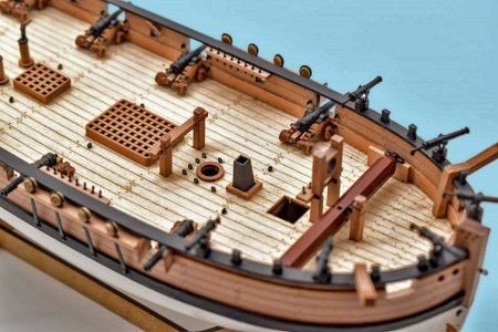

On this model the width of the deck planking is about 18 inches wide
Not only the planking, but also the hatchways are gruesomely out of scale.
