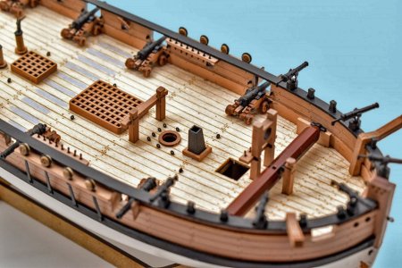

There is a lot that goes into building a model ship. After looking at your new page, I quickly went and had a look at the Decking on the Bounty in John McKay's book, and he shows 4mm wide boards for 1:48 scale. I noticed you have silver maple 1/8 x .080, and are those for the deck?
yes that is the decking
i took a look at John McKay's book and counted 37 deck planks and the Bounty is overall 24 feet 4 inches breadth deck is around 20ish feet wide so each plank is about 6 1/2 to 7 inches wide on the drawing. The 1/8 wide planking is a bit wider making the deck planks 6 1/2 wide well within acceptable scale.
Very interesting discussion. This entire series is quite informative and useful on scratch-building.
On this model the width of the deck planking is about 18 inches wide
I'm curious where you get that the deck planking on that model (which I think is of the cutter HMS Sherbourne) is 18 inches wide. I count 22 planks across the deck. The real Sherbourne had a beam of 19 feet, per wikipedia. Subtracting a foot to roughly take into account the thickness of the gunwales etc, and dividing by 22 planks, that corresponds to planks scaling to roughly 9.8 inches wide on the model.
It's interesting that the contract you show states that the deck planks were to be 5 inches wide. How typical was this? I was under the impression that deck planking was usually wider on earlier vessels, and narrower later. Chapelle says that fishing schooners usually had 5-7 inch wide decking pre-1845, and narrower in later years. For warships, my impression is that they were generally wider, although also became relatively narrower with time.
you correct the 18 inch is wrong so i went back and changed it
i counted 20 planks could be 22 but i went with 20 planks X 11 inches wide planks =220 inches divide that by 12 and you get 18.3 feet across the deck. Still out of scale IF the average deck plank is 5 to 7 inch max.

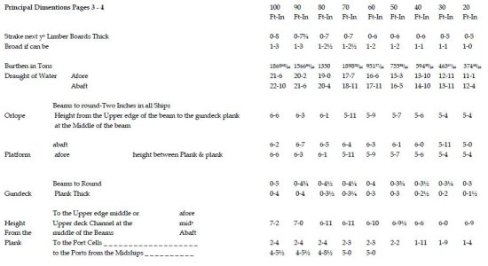

From HASN - appendix
Warren & Falmouth
General Instructions for building a Sloop of War (Corvette)
660 tons
1826
Berth deck Plank
of heart pine free from sap, shakes, or large knots
& not more than 10" in width.
2.5 inches thickness
Average length to be 40'
To be fastened into the beams with 6" spikes
into the ledges with 5" spikes
which are to be punched down so as to admit above the heads a heart pine plug - 3/4" in thickness -to be put in dipped in white lead
Gun deck Plank
of this deck to be heart pine free of sap
3.5" thick
and not more than 10" wide
average length 40'
beams 8" iron spikes
ledges 7" spikes
To be managed as those on the berth deck
The plank to be planed on both sides
Poop and Forecastle deck
2" thick
fastened with 5" iron spikes plugged and planed on both sides
Nothing on Spar deck
Also interesting:
Port cills
live oak
6" thick
Take care that these cills make a fair sheer & the decks kept at their proper distance from them
Which means that models with horizontal port cills are historically pure BS.
My take home from this is that the outer limit
for deck plank width is 10"
length 40'
I do not imagine that the east side of the Atlantic had ready access to virgin growth tall ramrod straight Tidewater pine that could produce 40' length and 10" width.

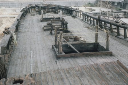

Re; Niagara narrow deck planking (Post #550 above)
Writing I the book Coffins of the Brave. Walter Rypka of the Pennsylvania Historic Maritime Commission explains that the replica Niagara’s narrow sprung planking is not historically correct. It was used to provide a watertight easily maintained deck for the replica.
He further explains that the decking for Perry’s original warship would have been wider, not sprung to follow the hull’s contours, and made from green lumber would have leaked as it dried out.

We can conclude deck planking range from 5 up to 10 inches wide but most likely around 5 to 7 inch wide. Here is a Great Lakes schooner built around 1840 and the decking was 7 inches wide. just about all modern built replicas have narrow planking so we cannot count on them to be historically accurate.
