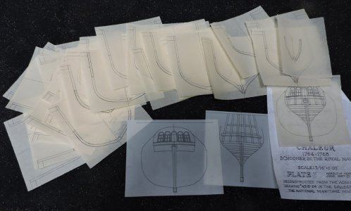

From Bob back to Harold he did some of his drawings on tracing paper here is the original tracing for the Kingfisher
Later Harold used Vellum for his drawings
Harold did the same thing Bob did and drew everything as separate patterns over a master drawing

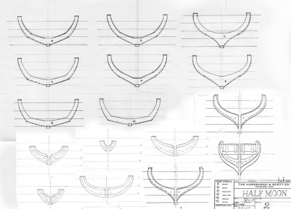

building a model is all about preplanning exactly what you want to build then figure out how to do it. take a look at the Half Moon maybe Hahns first drawing and model. It looks like a plank on frame hull but it is not really. It is a hybrid between a plank on frame on the bottom only and however he built the upper works, Harold never wrote about how he built this model.
looking at the plans Harold drew he only drew the frames to the waterline

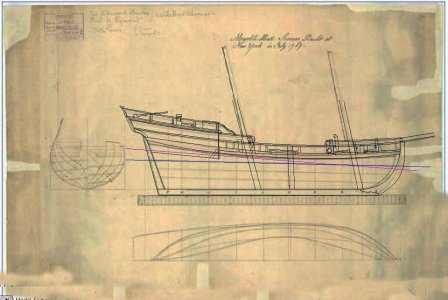

first thing is to trace the original ship plan which can be done two ways either in a CAD program or old school with drafting Vellum.
This is the tracing of the Sir Edward Hawk from the original museum plan
what you need is a clean sharp drawing
in the case of the sir Edawrd Hawk i will be tracing Hahns original drawing in order to rework Hahn's drawings into a new drawing.

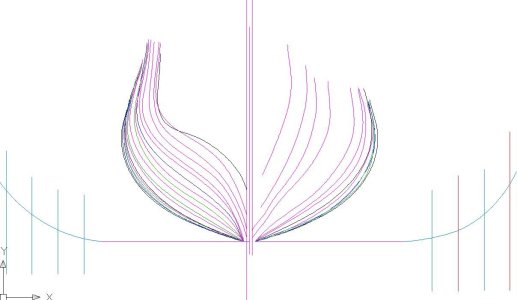

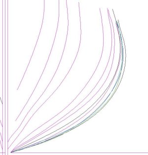

why trace the original frame drawings?
looking closer the frame lines are all tangled up
View attachment 505311View attachment 505312
corrected bodyplan all the frame line do not overlap and the bodyplan is now a smoother shape.
Could you provide a bit more granularity on what is involved in correcting the body plan? Also is there a standard for whether the forward or after profiles go on the left or right, or is it just a matter of preference for the draftsman?
