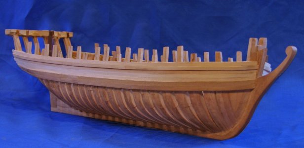

so far the discussion has been around scratch building a plank on frame hull. But scratch building is not limited to plank on frame you can design and build a hull using bulkheads or what is called the bread-and-butter method which is building from lifts.

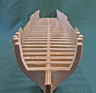

for now it is back to framing. The problem with framing a hull is keeping all the framing the correct place.
first issue is to make sure the frames are square to the keel, The problem is you only have that little notch over the keel and a frame can move quite a bit.
a solution to squaring up the frames as you install them is to use a backing piece. Start with the midship frame and work your way to the bow and stern.
by using a square backing block you also are keeping the frames from leaning, the frame on the left is leaning in.

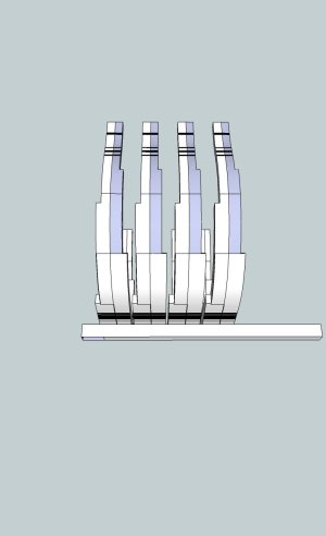

another way to prevent frames from leaning fore and aft is to use blocks between the frames. Once you square up the mid frame the next frame is located in the keel notch and blocks used at the top. I learned the hard way this is not a fool proof method because if all the space blocks are ever so slightly different thicknesses that slight error adds up and the entire structure will lean.
Frames will move side to side and back to front and it is a task to keep everything in line.

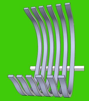

a problem reported by builders using the Hahn jig method found themselves still having a problem keeping the frames level side to side
The problem happens when the extensions are not finished exactly the same, the top extension sits in the jig which located the height of the frame. Hahn used a jig to insure each frame fit tight to the top of the keel and the top of the extensions sat against the jig
Harold's use of a jig solves the problem of locating the frames and holding the in place.

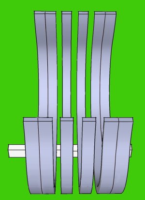

sister framing

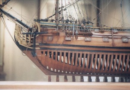

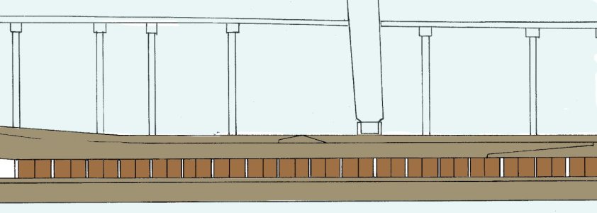

In model building we make all the frames the exact same size and evenly spaced. That is not the case in real ship building it depends on the the type of ship. Here is the frame spacing for the Eagle built on the lakes. The frame spacing varied from 5 to 2 inch space
Steam ships had solid floors under the engine the spacing is different all along the keel

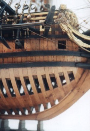

in some cases, framing was also so close together the hull was a solid wall of framing timber

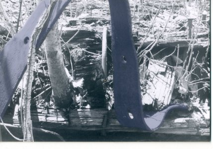

some hulls used strapping

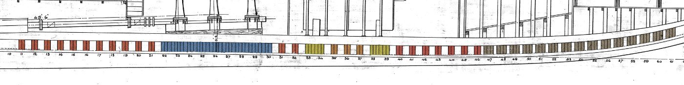

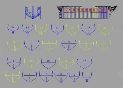

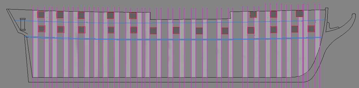

next set up the bulkhead locations. I placed them alongside the gun ports

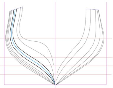

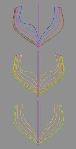

for the bulkheads i traced the station lines
as i did with adding frames it is the same for adding bulkheads. If your doing this by hand blow up the original bodyplan it is easier to draw the line between the stations.

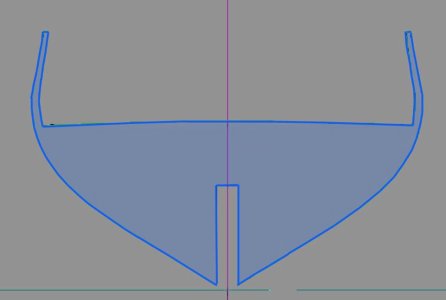

when you have all the bulkhead lines drawn i split the bodyplan from midship forward and aft. Then mirrored each side to complete the shape of a bulkhead
When the bodyplan is finished you line it up with the profile. The 3 blue lines are the rabbit at the bottom dark blue line is the top of the bulkhead slots then the deck and the top of the frame, You want to make sure the slots in the bulkheads match up with the profile slots. the deck is nor flat so the height changes from bulkhead to bulkhead.
you are dragging each bulkhead shape from the bodyplan and shaping the top and adding the deck
finally, you have all the bulkheads

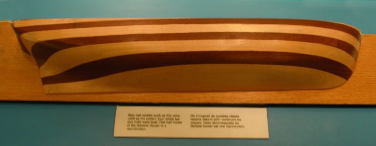

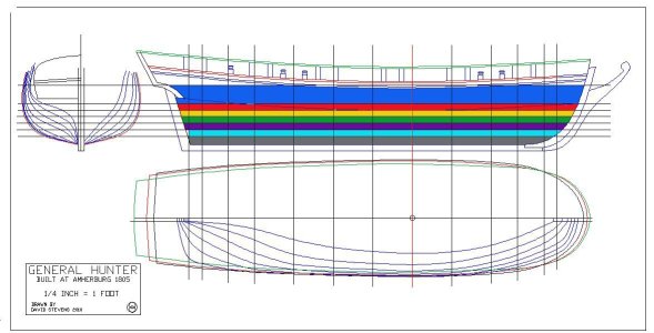

"Bread and butter" laminated hulls, solid or hollowed out, are the easiest to build of all in my opinion. All that needs be done is to trace the waterlines (and perhaps add a few on your drawing board if you wish and then cut a couple of boards the thickness of the distance between the waterlines to the waterline, leaving one straight edge of the boards as the centerline of the vessel. If you cut two boards together, half and half, you'll have a matched pair when their straight edges are placed together. When all the waterlines are stacked up and it's all glued together, all you have to do is "knock off the corners" of the steps between the stacked board edges and sand the curved shapes fair with a batten with some sandpaper on it. The inside corners define the shape of the hull as you go.
making a lift hull can be done as a finished decorative piece or used to build a solid hull. A member of the club years ago would build small solid hulls using the left method. Back in the day when piano keys were made of ivory Charley would salvage the ivory and plank his solid hull . A solid hull makes a good foundation for planking.
you can use different colored wood for each lift
here is the basic idea for building a lift hull the thickness of the lift is shown on the profile by horizonal lines the sheer drawing give you the shape of each lift. Each lift is cut out and glued and stacked together. sometimes small wood screws are used so the lifts do not come apart.
If the hull is used to draw out the hull lines the lifts are made to come apart so they can be traced

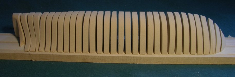

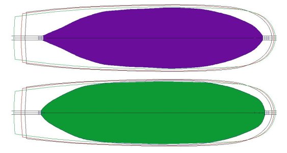

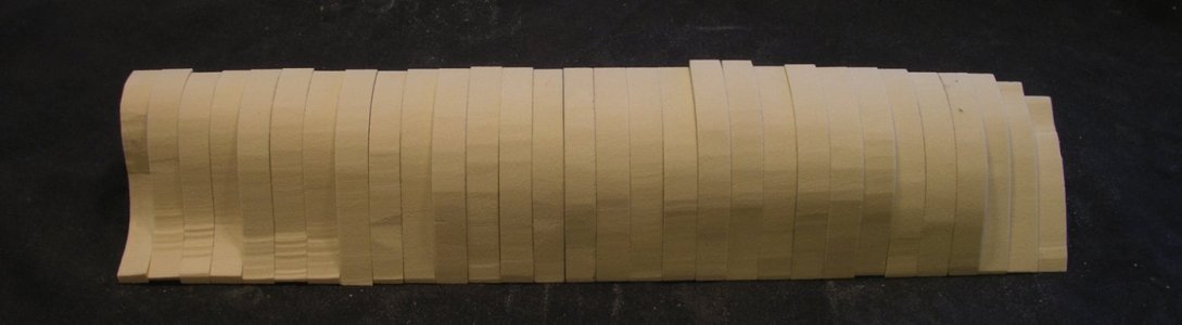

because there are more frames than station lines actually there are two frames between each station line i am going to fill the gap

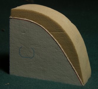

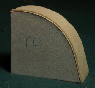

each filler piece is glued up from 2 pieces the thickness of the frames plus the space i used an expanding glue which was not a good idea
midshipthere is little difference in the shape of the blocks but they will step down as the approach the bow and stern

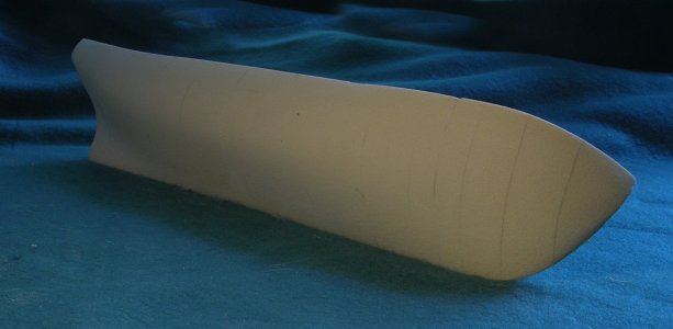

the blocks are now glued up to form the hull
The hull is made from a dense foam board used for sculpting. Do not sand the hull in doors. The static will cause the dust to cling to everything, actually it is not a dust it is a very fine grit.
the finished hull

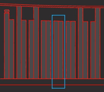

took all the slices and scanned them now i have the outside of all the frames and bevels

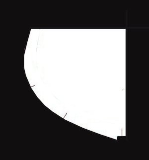

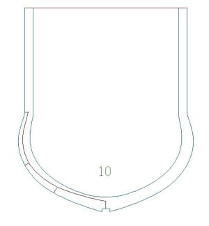

Once toy have a corrected bodyplan you can pull out one frame shape at a time and draw the inner spare of the frame called molded size and shape The is a long and tedious job both by hand and in CAD.
Start with making a copy of the frame in CAD you can select the copied line and use it like a template or by hand print out the frame. You do not need both sides of the frame drawing so cut it in half down the centerline.
What you want to do is cut out the frame shape and you will be usings it a template to trace.

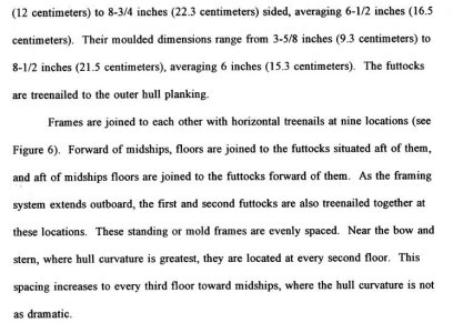

before moving on those little short lines are the points at the ends of the futtocks which are the frame sections. The length is important because it is defining the shape of the inside of the frame. The placement of the lines is hit or miss as long at you have the general location of the floor heads, and futtocks.
Some builders get into the exact structure of the frames keeping close tolerances but that is at a whole different level of building, more like model engineering.

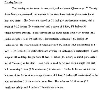

the lengths you will find in ship contracts or the establishments or archaeological records like the following.

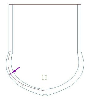

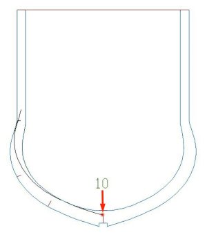

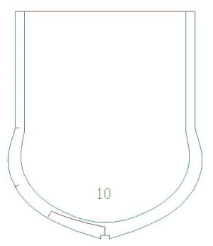

drawing the inside shape of a frame by hand and with CAD
take the template or select and copy the outside shape and place the end on the top of the line at the red dot.
rotate the cardboard template or select the line in CAD and rotate it so it matches up with the second line the blue dot

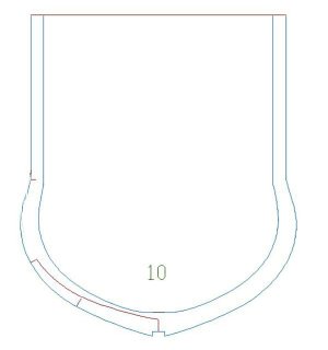

trace the template from the red dot to the blue dot, i CAD break the line at the blue dot

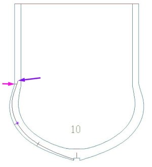

take the cardboard template and rotate it at the blue dot until it matches up with the next line green dot. In CAD where you broke the line select the end point and rotate the line to meet the green dot line
trace the edge of the template to the green dot. in CAD break the line at the green dot
sometimes the inner line does not give you the right taper so you have to fiddle with getting it in the proper place. with the last line in this case has to be rotated from the top to the bottom rather that what was done so far which was from the bottom to the top
you have to adjust the top because if you rotate the template or the line in CAD you end up with a narrow section. Move the end of top line purple to the magenta line
now rotate the top to match up at the purple dot and trace the template
you now have a nice inside frame line with the correct taper from the floor to the cap rail.

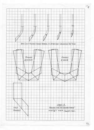

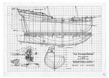

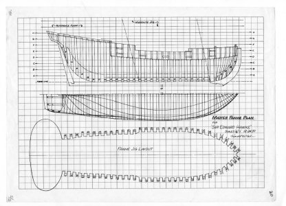

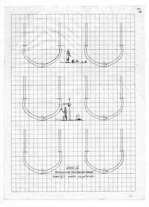

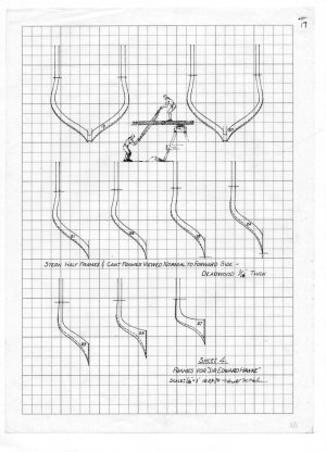

mirror the left side to the right side to complete the frame. Notice the frame just drawn does not look like Hahn's original frame drawing. We will get into that later.

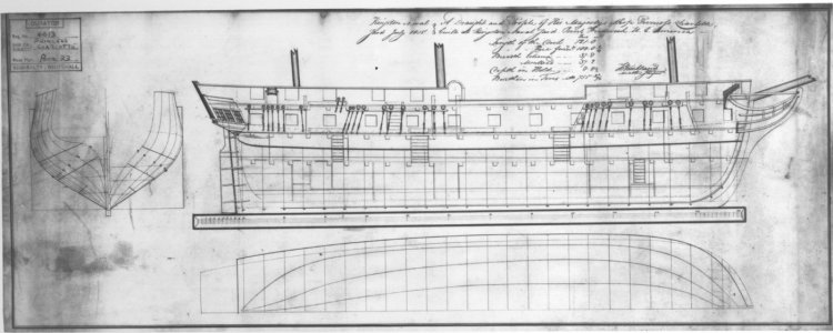

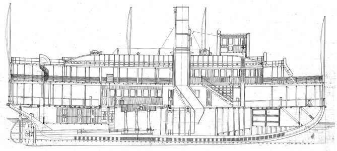

Harold Hahn never did a final drawing on the Sir Edward Hawk or offered a set of plans. What we do have to work with is his working drawings he used in an article on building a plank on frame model.
The first step is to scan the original drawings as a JPEG file then using AutoCAD 2004 bring in the JPEG files to trace
