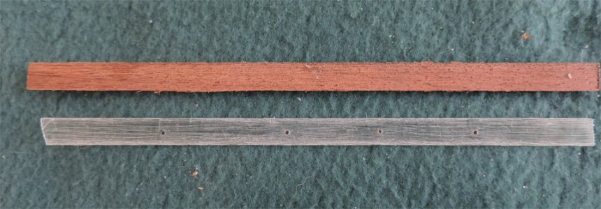

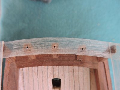

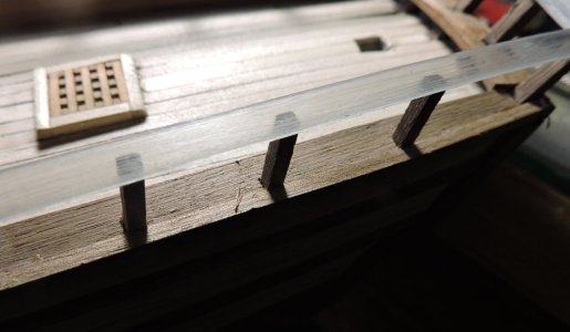

i was unable to finish the railings this week because i broke the last blade on my 10 inch bandsaw. I could not find the size i needed in any local store so i had to order it on line, still waiting for the blades. So this week i will cover how i made the patterns. Using the plastic from product packaging i cut the width of the railing the scuffed it up with fine sandpaper. A drop of glue on the first stanchion and at the stern on the corners held the railings in place.
Being able to see through the railing it is easy to drill your hole and hit the top of each stanchion dead center

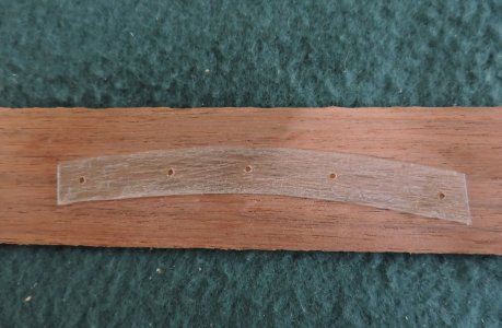

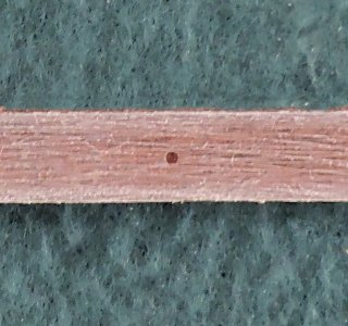

Removing the plastic patterns i stuck them to sheet stock, now you have the shape of the railing and the exact location where you need to drill a hole.
Same with the railings along the sides using the patterns

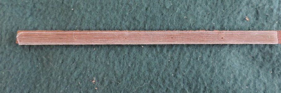

cutting the railing to the width and clamping or rubber cementing the plastic pattern
Taking a close look the location of the holes are quite clear.

Brilliant! I know that you have been thinking about how to drill these holes and to hit the center of each stanchion. The see through pattern is a great idea.

Thanks Roger i was thinking i use a lot of cardboard patterns and then i thought i need to see through the pattern and BAM! then idea of clear plastic.

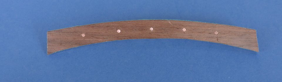

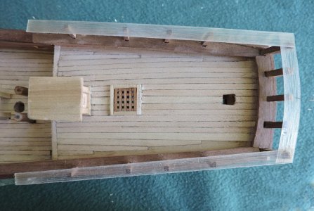

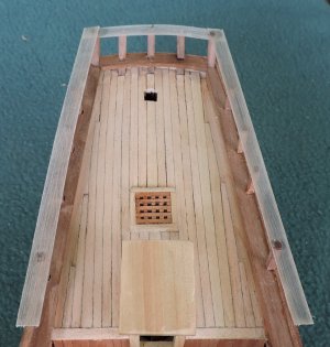

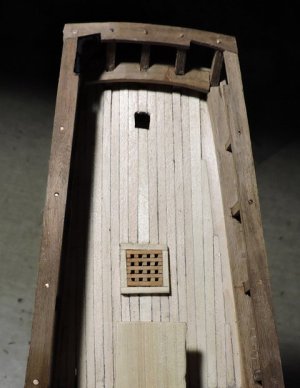

the railing at the stern

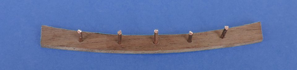

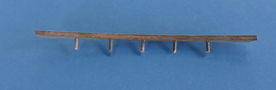

i put the copper wire into the predrilled holes in the railing
from the underside i did try a fit into the predrilled holes in the tops of the stern timbers and with a little wiggle here and there the pegs dropped in place.
and a top view the copper wire changes depending on the light. Without a direct light the copper is darker looking but as you move the copper will catch the light and show brighter. In time the copper will dull down and blend more into the wood railing.
Years ago i saw a model using silver wire as planking nails, at first glance you did not notice the silver but as you moved the silver caught the light and the nails would appear and disappear.

I use A LOT of 1.75" steel quilters pins to align parts for PVA bonding.
Where I have too much PVA and it gets into the holes with the pins, I have to grip the pin with three hemostats and twist carefully to break the bond.
This is a round about way of suggesting that if you use coarse grit sandpaper to scar some horizontal grooves on the body of the copper wire trunnels a dose of PVA will bond them to their stanchions. It will not be epoxy strong, but nothing that Nature does will break it. If you try, the wood will break first.

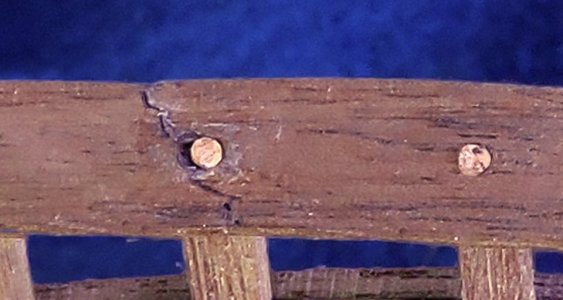

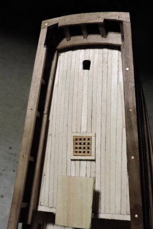

the idea sounded good the see-through patterns worked, almost. I made the railings to the patterns and drilled the holes in the railings locations on the patterns but when but when i came to fit the railings to the stanchions i broke the railing not once, not twice but three times. You cannot recover from such an error you have to start again and make a new one. Lucky i have a template to go back to and i can make railings over and over.
i can take the easy way out and give up on the copper wire idea but i wanted to produce an effect when viewing the model
Take a look at the railing on the right side in the first image now you see the copper wire clear and bright in the second image the copper is almost gone the copper in the lower right corner vanished. Same with the railing on the left now you see the copper now you don't. Just the slightest shift in lighting changes what you see or don't see. Doing the railings 3 times for me was worth the effort
Model building makes you think does not matter if you're building out of a box or scratch building there will be challenges. So what went wrong and why did the railings keep breaking when i tried to install them? The problem was being too perfect; there is such a thing. The holes for the copper wire were exactly the diameter of the wire so it was a tight fit and no wiggle room. The slightest miss between the holes and the wire prevented all to line up exactly. You cannot just use thinner wire you need the hole in the stanchion one size bigger than the wire in the railing. I also glued the wire in the railing holes first which made them rigid. The fix first tap the wire into the same size holes in the railings (a tight fit) but don't glue them. Next with a Dremel i ground the copper to a taper so there was room for the wire to move in the hole in the stanchions. Finally done.

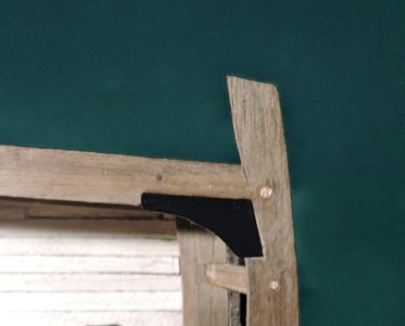

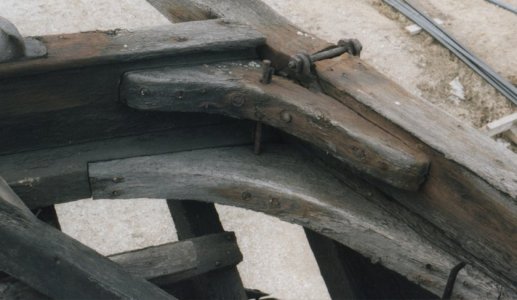

ok class lets go into the shop here is what is next see that lower knee it secures the side railing to the stern railing now i have to make one on the model.

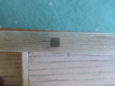

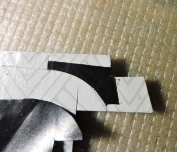

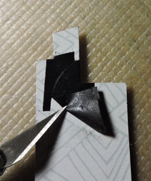

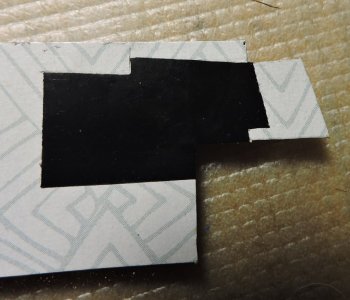

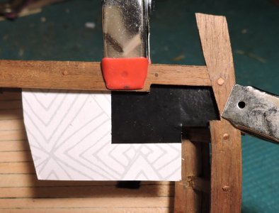

Oh yes it is back to cardboard actually i might of built the model out of cardboard first before i commit parts to wood. I am suing cardboard that has printing on it because i want to stick a piece of electrical tape to it. What is important here is getting those two straight edges copied. i cut along the edges just enough to go through the tape.
now i have my starting edges

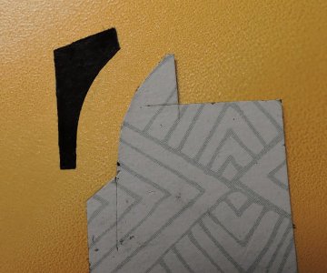

I cut the arch of the knee and peeled up the tape. You can see the cut in the tape.
i got the final template for the knee
one last check before i go to making it in wood, hum just a little big the ends of the knee should line up with the edges of the railing. That's ok i can deal with that when i cut the piece in wood.
the knee on the other side is so slightly different i need to make another template to fit. As any model builder, building whatever project be it from a box of parts or a stack of wood the idea is to pay attention to the material you're working with, how it responds to you. Each step along the way sharpens knowledge and that transfers to skill.
