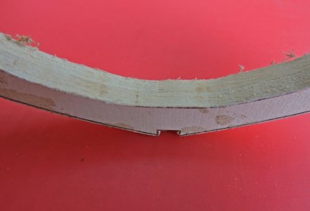

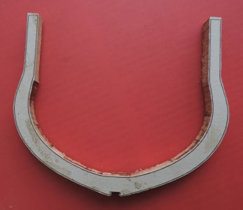

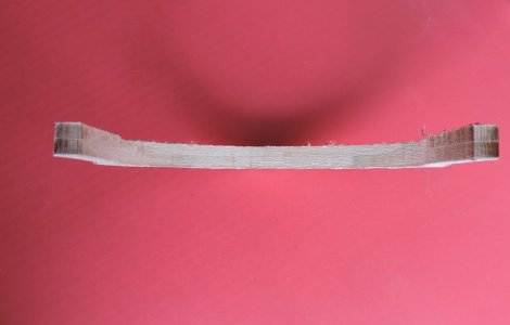

i left off building a frame blank and cutting the outer edge, to finish up the frame i cut the inner edge on the table top 10 inch bandsaw. Cutting along the line by hand is no problem as long as you go slow and steady. there is enough material on the frame to allow you to shape the framing once the hull is built. So if your a little wobbly with your cut it will not matter.
at this point of making the frames you can smooth out the inside as you build each frame or not and leave the finish when you sand the hull.
The advantage to sanding the inside of the frames before assembly of the hull is it is easier to do as opposed to sanding the inside of the hull. you still have to sand in the bevel, which you will have to mark out on the frame if your finish sanding each frame.

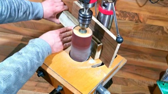

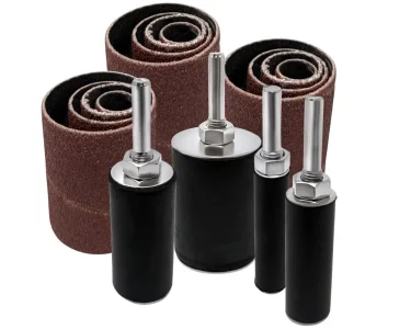

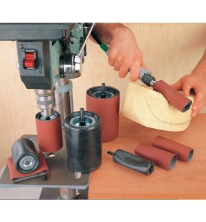

There are a few tools for sanding the inside. If you have a drill press get a set of drum sanders. There are pros and cons to use a drill press in this manner. simply a drill press is meant to drill up and down and not to be used sideways. If someone wants to shed light on the why it can or can not be done please post.
if your going to use a drill press for more than drill holes then here is a setup for thickness sanding

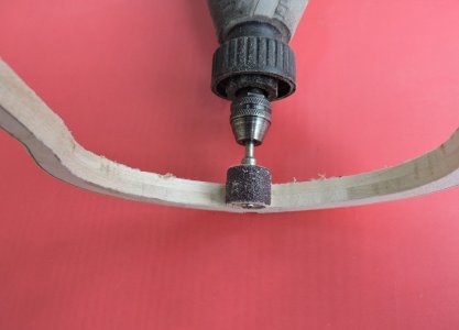

if you do not have a spindle sander or a drill press then a Dremel tool will do the job. I suggest you at least smooth out the inside of each frame before building the hull then once the hull is built then go in and sand the entire inside of the hull. Each frame at the bulwarks have to be inline which would be very difficult sanding each frame one at a time then trying to line them all up.

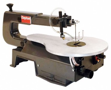

Or you can buy a jig saw or scroll saw, i do not quite know the difference between the two types of saws. But you can buy one for less than 100 bucks. The small hobby toy versions like i posted earlier will not cut it so avoid the "hobby" size tools.

A. Couple of comments:
On many full sized drill presses the end of the drill quill, the thing that spins the chuck, is tapered with a Morse Taper. The drill chuck is pressed on to this taper. For drilling this works fine as everything is in compression but this arrangement is not designed to withstand sidewise forces. Sidewise forces can cause the drill chuck to fall off. Personal experience.
You used to be able to buy a collet chuck. This also presses on to the Morse taper but has a threaded collar that fastens to threads on the quill. This allows the drill press to be used for light duty jobs producing sidewise forces; routing and drum sanding.
There’s lots of different brands of drill presses. Best to check yours before drum sanding.

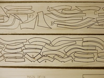

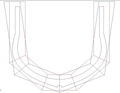

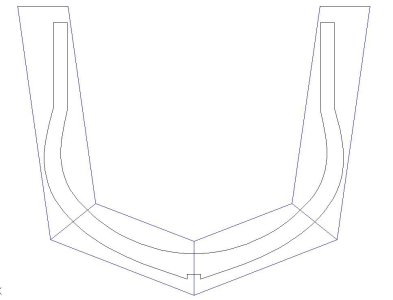

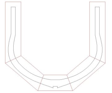

This is what is used to build the frames there is no need to build frame blanks and cut out the frame. What is going in here is building a frame from laser cut parts.
So what is the difference between assembling kit parts and building these frames from precut laser pieces? In a plank on frame "kit" you assemble the parts into a finished frame no additional work required. In a semi-kit with laser cut parts you first assemble the frames the difference here you assembled a frame blank, that is it is not a final frame it requires you to shape and finish the frame.
one of the issue when building frame blanks is the waste of wood, with laser cut parts they are nested very close together. This was done first to save on wood and secondly to cut back on weight and package size for shipping.
This coming week i will build the framing and prep up next Saturday's discussion but this Saturday it is about "how" the model will be framed.
There is the subject of being historically accurate and i will say there is no such thing unless we have the actual remains of the Sir Edward Hawke, which we do not. So, we will rely on best guess or what can be said "ship building practices" for the time and place the Sir Edward Hawke was built.

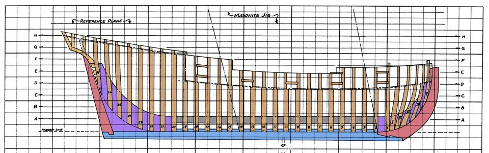

Let's begin with what Hahn drew, he has been criticized for his stylized framing. The actual truth those who criticized the framing and called it stylized are wrong. The way Hahn framed his hulls were an actual framing system called room and space. This was a system where the width of the frame (sided dimension) was equal to the space between the frames.
do we have proof this was a real type of framing? let us take a look at the evidence

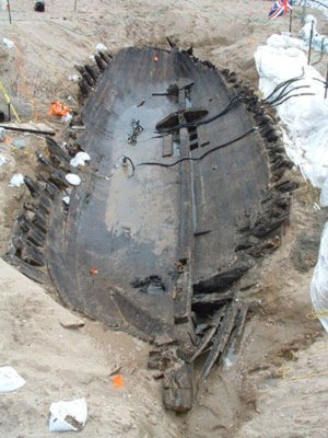

Great Lakes schooner 1840
shipwreck date unknown

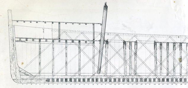

plans of a wooden hull bulk freighter
so room and space is indeed real.

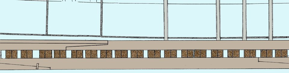

What Harold did do was tinker with the scantlings (size of timbers) he did this to open up the hull as a visual effect. He wanted the frames to stand out at first glance. He is looking at the framing from an artistic view. Rather than showing a hull with framing very close together it looked more like a solid wall of wood. Space out framing has more of a visual impact,
looking for a balance between the historically minded and the artistic visual appearance of the model i tweeted Hahn's original framing.

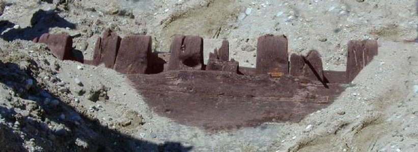

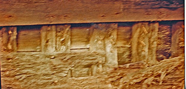

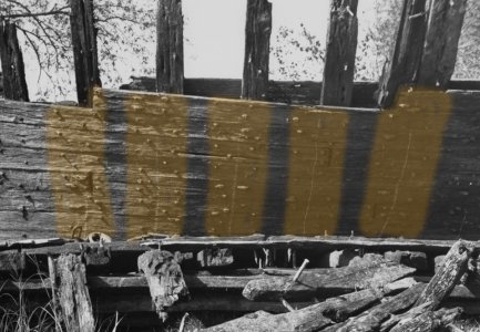

for the historical evidence what is the model based on? what was used is archaeological research and actual shipwrecks.
using the nail pattern in the planking i colored in the size of the frames as you can see the space is much narrower than the size of the frames.
shipwresk 1815 Great Lakes
shipwreck 1800ish
Framing is heavy and close together average 4 to 6 inches spacing

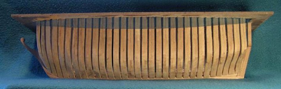

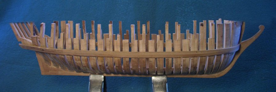

a model of the hull above

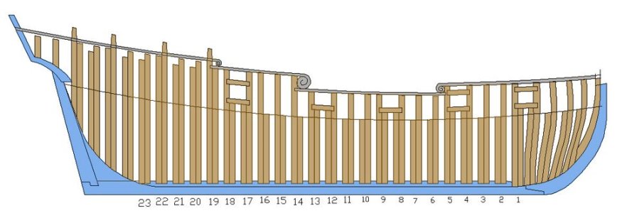

keel and frame profile used for the model of the Sir Edward Hawke based on shipwrecks of the period and archeological studies done on ships of the type and period.

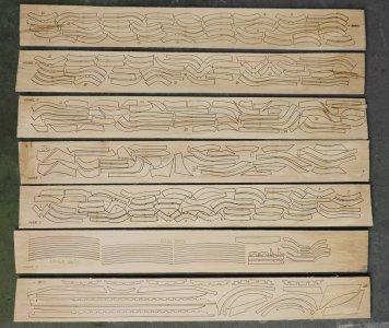

This week i will spend building frames from the laser cut parts and discussing the jig for building the hull.
next discussion will be next Saturday morning.
i am building the prototype and i expect to find drafting errors but then again maybe not. you just don't know until you start building.
the framing sheets, keel parts and building jig will be available if you want to build along. more details will be posted
