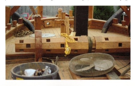

The problem here is this windlass is dated 1840s the Sir Edward Hawke was built in the 1760s so wrong time period plus the fact to model this windlass would be advanced model building. first, you have to CNC mill all the parts and the windlass barrel to very close tolerances, cut the ratchet teeth and assemble the windlass or 3D model the parts.
windlass parts1.jpgwindlass parts2.jpgwindlass parts3.jpgwindlass parts4.jpg
The source i used for a windlass for the Sir Edward Hawke is Harold Hahn who did extensive research on colonial ship building and consulted Howard Chapelle. Hahn also had quite a large library. so, let's look at what he did for a colonial schooner windlass. All but one did not have a ratchet in the center they were just a simple log with square holes. But between a simple log windlass to a ratchet type to the type use in the 1840's a windlass went through changes.

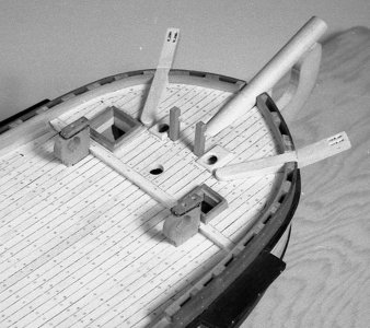

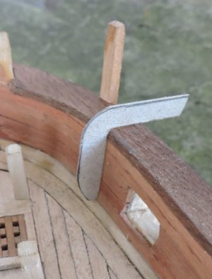

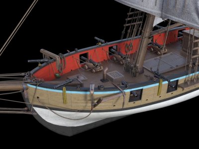

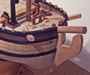

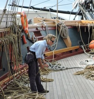

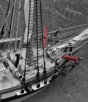

Today we are moving from the stern to the bow and adding two more swivel gun mounts and the catheads. The question is the catheads and like all parts of a ship that part can take on a number of configurations in other words one part does not fit all. The place to start is not to just go into the shop and start cutting wood the process starts in your head it is problem solving and that is required from kit to scratch. The cathead starts with looking at Hahn's model and see what he did. Hahn had an extensive library and he consulted Howard Chapelle on colonial ship building so Hahn is a trusted source, however some will argue that point.
the cathead goes over the rail and down the inside of the bulwarks on the Sir Edward Hawke model
on this model it does not go down the inside of a bulwark, it is clear a cathead is made to fit the ship and it is not a "standard" item
Kit instructions pretty much tell you what part to glue where it does not explain why or the function of a part. It makes it difficult to carry what you learned to the next project if you do not understand the why, how or function and the fact fittings are designed for the ship being built. What i do as well as other builders is first take a look at what is out there then take that information and build it in your head first before you go out in the shop.

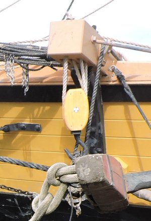

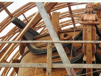

Lets take a look at catheads
Understanding what a cathead is used for it would be a good idea to add a knee to support the cathead when it is used to raise a heavy anchor.
when there are head rails the knee is incorporated into the railing

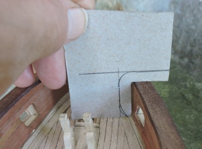

Now that we know what has to be made it is time to head out into the shop and make a cathead. A reason many builders rely heavy on detailed instructions and details in plans is not having knowledge of the subject. The need to rely on looking at plans stops at the point you have the structure built, at this point fittings and parts are designed and made to fit what you built and not necessarily what the plans show,
It is the old cardboard making patterns and you use the model to make the pattern not the plans.

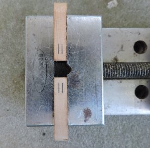

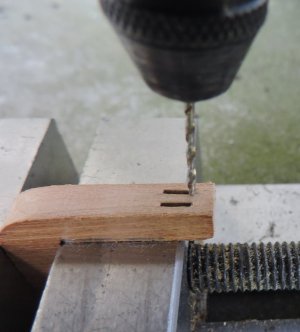

There is no need to cover cutting out the cathead it is simply tracing your cardboard pattern on wood so lets start with the groves where the pulleys go. both catheads are clamped in a vice and using the edge of the jaw to line uo the groves.
Now the problem of how to cut the groves? You can use a sharp knife and cut along the lines then make a V cut from each side to the center of the grove then clean out the material left in the center of the grove. OR as i did i used a small screwdriver and a couple taps with a hammer
resulting in a perfect sharp grove.
Using a small drill a hole is drilled at the ends of the grove

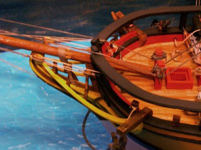

The catheads and swivel gun posts are now in place. This concludes the building of the model next week will be the last class on the Sir Edward Hawke and i will arm the model with swivel guns and cannons.

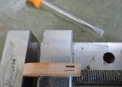

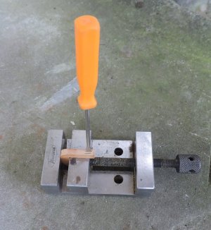

If you do not have a screwdriver to make the slots but you do have a Dremel tool you can grind any piece of metal into a blunt chisel shape. Another part of model building is making things into tools
