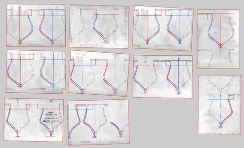

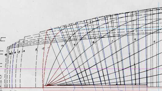

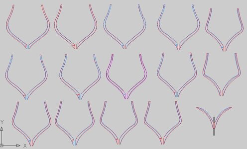

The project begins with tracing the 14 stern frames from Harold Hahn's modeling plans of the Alfred. The frames were scanned as a JPEG file and linked to CAD. Auto Cad does not import files it links to files. Hahn's original Alfred drawinga are in 1/8 scale so i am enlarging the build to 3/16 scale.
i just traced one side of each frame because i can mirror the drawing for the other side, this insures both sides are exactly the same.

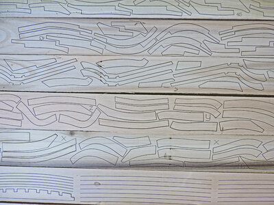

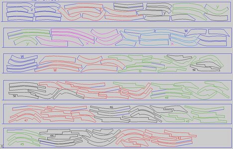

once the tracings are done the next step is to break down the frames and create a laser cutting file each frame is a different color if i did not do that it would be extremely difficult to figure out what pieces goes to what frame.

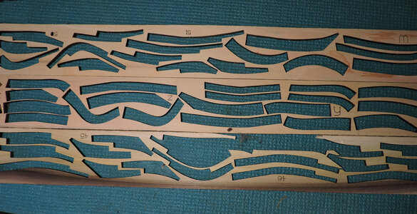

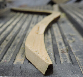

now that i cutting file has been created sheets are milled to the proper thickness and off to the laser cutter
looking closeup
i am using laser cutting rather than cutting the parts out with a jig saw or band saw is because i can place the parts very close together thus fitting more parts per sheet. As you can see on the left side how close the parts are to each other.

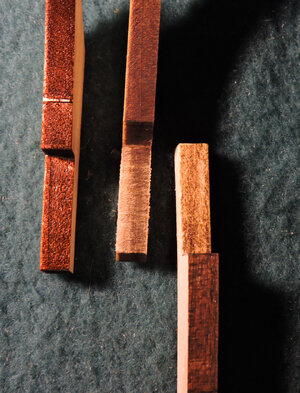

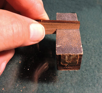

what i found out is super glue sticks to the char but not as well if you remove the char. I can snap apart a joint if the char is not cleaned but it is difficult to snap apart a joint that has been cleaned.
what i did was to take the joining surfaces and clean them up a bit by using a block with sandpaper.
i didn't have to remove all the char just a little cleanup

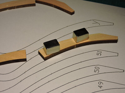

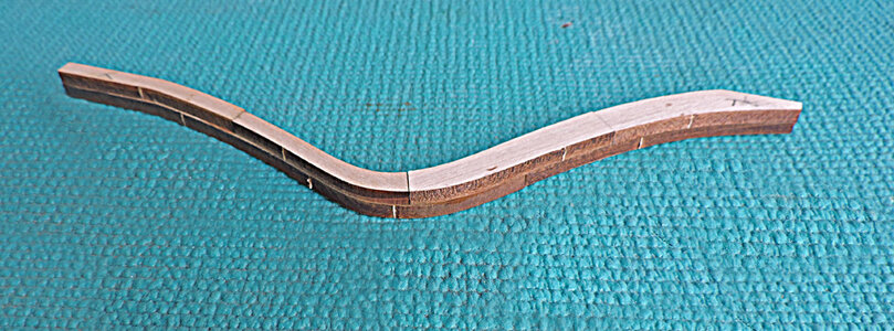

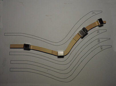

assembly of the double frames i used a print of the frames. The print is sitting on a sheet of metal and the parts are placed over the print of the frame.
i am using rare earth magnets to hold the parts in place. These are extremely strong, and they hold the parts down.
Once both parts of the double frames are glued up i switched glue and used wood glue to join the two halves together.
You do not have to use the magnet method you can also use pins along the pattern or if your using super glue to join the pieces then you don't need anything to hold the pieces in place. Just hold the two pieces for 15 seconds and the glue will grab.

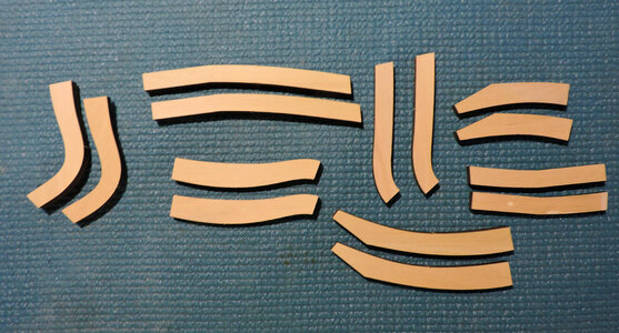

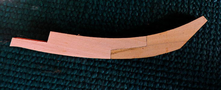

Between the double frames (bends) are single frames (filler frames) on Hahn's original model he also built the filler frames as doubles. He did this because his model is built to 1/8 scale and the single frames would be very delicate and tend to distort if built as singles. I upped the scale to 3/16 so i built the filler frames as singles.

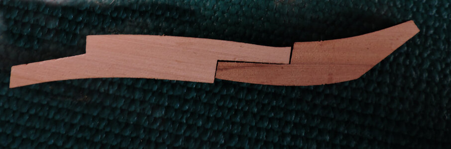

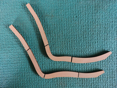

when i broke down the frames they are joined with a scarf rather than a butt like the double frames. Each scarf fits only the end of a futtock, you cannot mix up the pieces because they will not fit right.

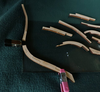

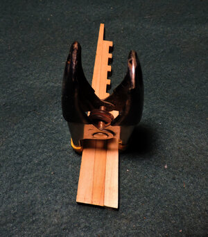

after making a couple frames i realized i did not have to build them on the pattern like i did with the double frames. The laser cutting is so accurate when I pinched the scarfs together and the frame fell into the right shape. One thing i did notice is when i sanded the face of the scarfs and i was not at an exact 90 degrees the frame pieces did not lay flat. It does not take much to affect how the frames will lay flat. to begin with the laser does not cut on an exact 90 drgree angle. The laser beam spreads out resulting in an ever so slight angle.

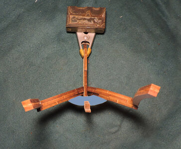

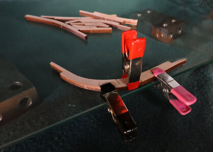

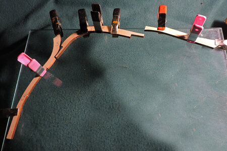

What i did to ensure the frames went together flat i assembled them along the edge of a piece of glass. The red clamp pinched the scarf together while the black and pink clamps held the pieces flat.

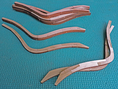

each frame was assembled in sections
Then the sections were joined to form a finished frame.
the job of building the frames went quite well

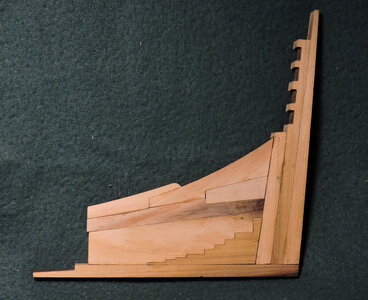

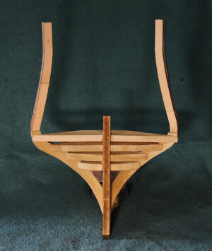

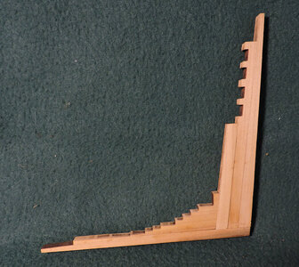

all the frames have been built so the next item to design is the deadwood which is a simple structure. The parts are laid on a flat surface and clamped together
there are two parts to the deadwood the first is made-up of the keel, stern post and inner post. These parts are wider than the deadwood

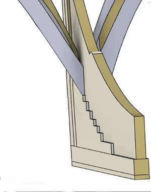

i did the deadwood different than Hahn's plans the rising line he used was a arc what i did was add steps for each frame which created a ledge for the frames to sit on.
getting back to the frames as you can see on Hahn's drawings each frame is at an angle to the deadwood and that angle changes with each frame.

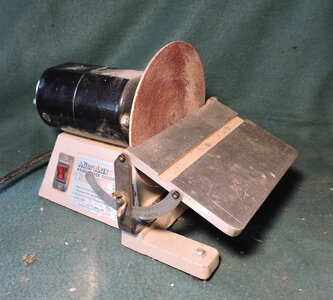

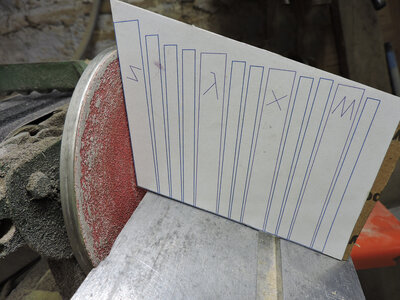

The angle is critical, and it has to be just right so i am using a 4 inch disk sander. I guess you can sand the angles by hand but that would be a bit difficult.
what i did was make up a cardboard pattern and starting with the Z frame i set the angle
As i did each frame i cut off the last frame from the template and reset the table

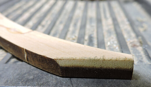

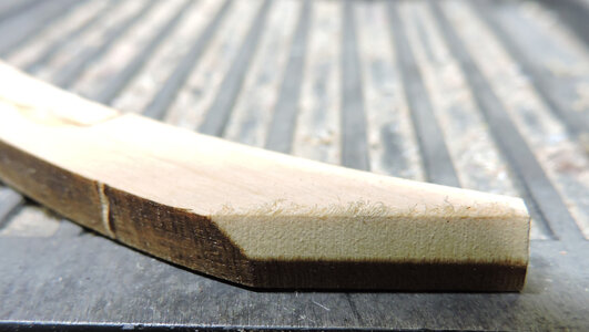

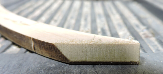

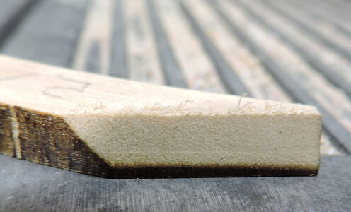

Cutting that angle at the foot of the frame is critical and it has to be even and at the correct angle. Here is my method by using the laser char as a guide. If you are not using laser parts, then take a pencil and darked the surface.
first contact is very light just to get the angle of the face to the disk, making sue your even across the face
look at your piece and sand a little more keeping the char level
opps slightly to much at the right side i am losing the level
ok good a slight adjustment and it is back to level
and the final angle
remember there is a right and left frame so make sure you flip the frame for the other side of the hull. There is no fixing the angle if you cut it wrong you will need to make another frame. you got to do this 28 times.

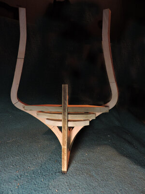

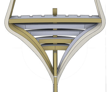

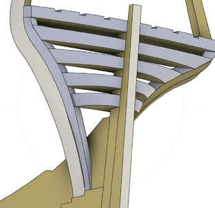

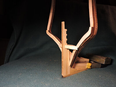

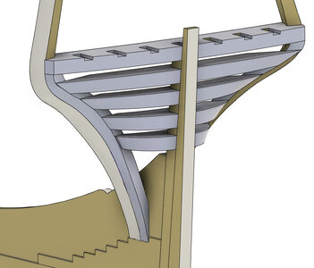

Now comes the setup what i am building is the stern first starting with frame Z and the rest of the frames will be built off frame Z

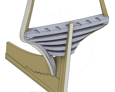

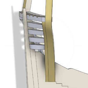

Looking at a 3D model you can see the steps for the frames to sit on.
Building the stern in 3D modeling is quite different than actually doing it so let's see how it goes.
here are different views of the deadwood, frame Z the fashion timber sitting against frame z and the transoms.
this project is working with blanks that have to be sanded and shaped, so which type of sandpaper to use, there are 2 to choose from
Silicon carbide is a sharper and harder grain compared to aluminum oxide, but silicon carbide is less durable because it is brittle and has a more narrow shape that wears down at an increased rate. Due to its razor-sharp grains, silicon carbide will have no problem easily cutting
aluminum oxide is the most frequently used grain in the industry because it does a pristine job on a number of materials including bare wood, painted surfaces, and metal. Additionally, aluminum oxide is exceedingly durable.
i use Silicon carbide disks, belts and sheets but one issue it is very sharp and cuts real fast even your knuckles, all it takes is a lightest contact and before you can react it will cut deep. It is brittle but sanding wood it will stay sharp for a long time.

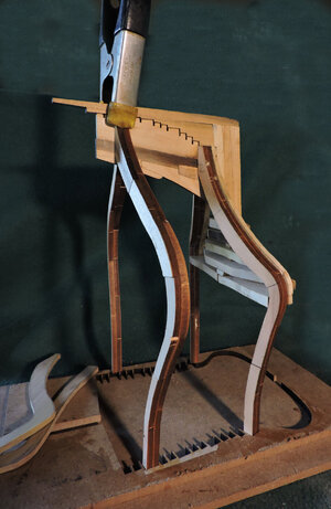

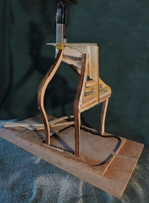

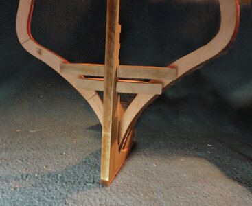

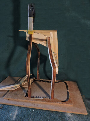

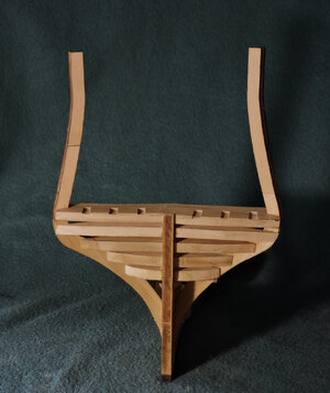

Once frame z is in place the only thing holding it is the surface between the angle on the foot to the deadwood. It would be easy to snap off the frames so to beef up the structure at this point is to add the transoms. There are no patterns for the transoms on Hahn's original drawings so this is one of those times all you can do is makeup a rough blank and fuss with it until you have a reasonable fit, then once everything is in place the final shaping is when you sand the hull. There is a lower cone shaped piece right at the bottom where the foot of the frame meets the deadwood., that piece i will add later on.
before adding the wing transom at the top notches are cut in for the stern timbers
and it is added to the stern
The set up started with digitizing and laser cutting the jig from the original Hahn drawings. Frame Z is now secure and strong enough to build off. Frame Z was glued and pinned to the deadwood. Next i took frame W and using clamps i held it in place. Then the structure was set into the jig, not glued in the jig just set in the notches. The frames are slightly wider than the notches, so it was a snug fit,

Hello Dave, I have a question about the stepping of the frames to the deadwood. I'm sure that the stepping is more practicle in reality than the Hahn smooth bearding line. So the question: did you follow the Hahn lines? If yes, did you use the point of contact at the fore or aft end of the frame?
I intend to build the Warrior and will be using your thread to model the deadwood to frame look.
