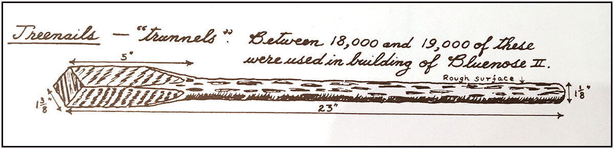

L.B. Jenson has drawn in his "Saga" this treenail:
At the top they are square, but they are driven in (round) drilled holes. It's a personal taste how you would show your treenails.
Wooden treenails are generally enthroned around. But metal nails also shown square, like Uwe did.
Jenson draw also the wooden treenails by the assembling of the frames.
Your square wooden versions are something different and I like them for the frames. About the size: relate them a bit more into scale.

Pierre, do you think my nails are a little big? I made 1.2 mm round holes for 1mm × 1mm square nails, made of wood I can't make smaller....
Johan has already given a nice explanation, Dom.
Scaling everything is not feasible. The square ends of Jenson's treenails are 1 3/8" = 34.9mm. That would be 0.48mm in our scale. The 0.8mm you show in your 2nd test are better proportioned for the frames than the 1.2mm.
But ......... this is all very personal. It is important to me that what you see should be in proportion to each other.
This is even more important with the deck and hull planks.
In any case, your tests give me a nice deja-vu to the tests that I have done a lot myself. They also gave a lot of input from other builders. With the conclusion that this is not yet easy and open to discussion.
