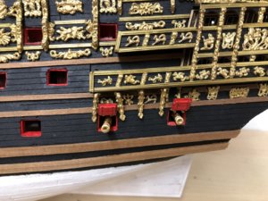

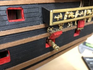

first gunport finished
second gunport done and already added some of the supports for the gallery.
all supports done (the supports required a lot of adjustments to fit halfway properly)
and here the overall view with all decorations done for the port side.
Next step is to finish the decorations on the starboard side, which will still take some time.
