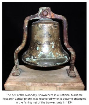

Rob, while I'm not doing any scratch building myself, I appreciate your detailed step-by-step procedural explanations with accompanying pictures. Meanwhile I discovered the ship's bell from the lost Fernald & Pettigrew, Kittery, Maine built 1855 clipper Noonday. I thought you might appreciate seeing how closely your replica resembles the real thing. Since this article came from the Portland Press Herald, I came upon another unrelated story. That was about Snow Squall South Portland's clipper. There I found another beautiful Buttersworth piece. The main subject is the clipper  Warnrer but it's suspected that Snow Squall is the background vessel.
