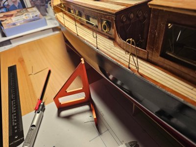

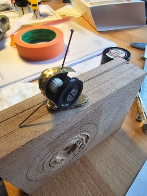

I did little things , , begined the capstan , and sanded the top of the chimney
After will have to do a little putty and fine sanding and after paint.

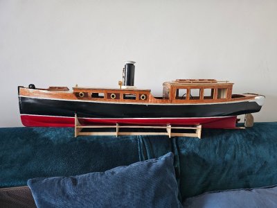

Took a long time to post ,work getting the most of my day ,and I have to confess I am not very pleased with my idea to put resin on the superstructure.
The end result is a a so and so model , will be good for going to the pond and water resistant but just that
I tinkered with the some bling to add to the ship and made a ship wistle but it will be another version soon.
This is how my model look
Great looking model. Will be nice to see photos of her cruising on a pond. I have always found that the best treatment for finishing mahogany on this type of vessel is several coats of good quality marine varnish with light sanding between each coat. Just like on the prototype boats, you can't get a better high gloss weather resistant finish.
