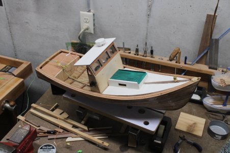

Today I finally got back to work on the running lights for the lobster boat. And, I am making progress on the fore deck. soon I will have to get all the various wires attached and tested. It has been a long journey getting to these points, and I am delighted to see the finish approaching! more phots to follow soon.
Happy modeling
Steven

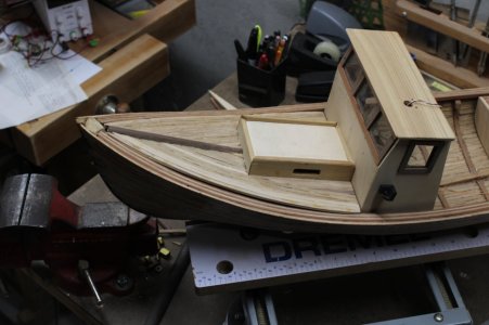

I have started applying the strips of wood for the foredeck; so far I have 5 strips on one side and 6 on the other, It's a slow process because each strip has to follow the foredeck lengthwise and sidewise and up/down a little due to the curve of the foredeck. It's a slow process but it's working well so far. It will take a few days for me to get all the strips cut & installed, one or two at a time, but it is going well, so far.
Happy Modeling
Steven
Hi Steven,
Personally I would make a stand that keeps the boat on an even keel to start with this will help with marking the line.
Does the plan/drawing you are working to have a water line marked on it?
If so, is the waterline parrellel to the keel if it is then measure up from the base of the keel and mark a line on the transom and ensure the keel is parrellel to the table.
If the waterline is not parrellel to the keel you will need to measure the two heights on the drawing and adjust your stand to suit.
A block of wood with a pencel attached to it and packed to the correct height can be used to mark a line all around the hull.
You will have to place the model in a pool or the domestic test tank otherwise known as the bath or other body of water that is deep enough so the keel doesn't touch the bottom. And once all battries and othe gear is installed place ballast as required to get the boat to the waterline.
I hope this helps.
Cheers,
Stephen.
Thank you, Steve!
Your information is very clear, very helpful, and greatly appreciated. I don't have any actual plans, just notes and conversations with William West, builder of the real Donald David, and William died a few years ago, but I have saved notes & conversations from him; and this web site is greatly helpful. I hope to launch my model sometime soon, at a pond by my Son-in-laws cottage.
