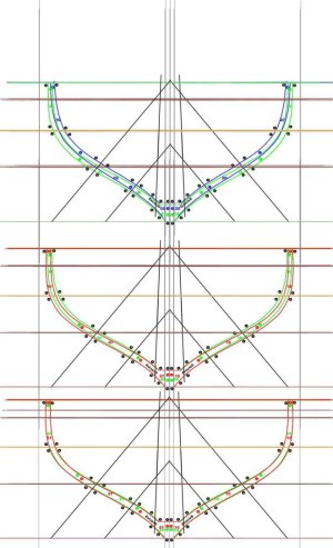

The outside shape of each station is traced on its own separate layer
Eventually each station is traced.
The station shape is color coded. Three colors are used and cycled.
Each station is processed into a frame.

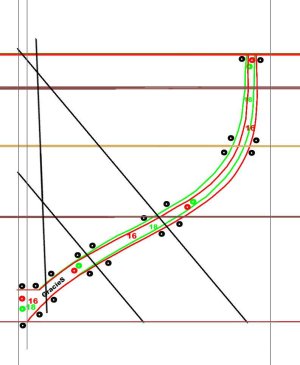

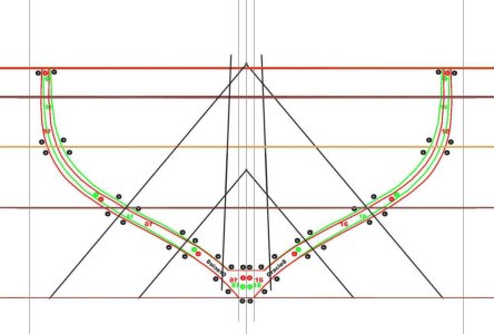

Start with the frame outside shape
Hand lofting the moulded dimension uses a compass to draw an interior semicircle at the desired spot on the outline with a radius equal to the moulded dimension. The inside frame line was the tangent of each semicircle all connected
In Painter I made up a series of circles with a different diameter from 3 inches up to 20 inches in scale, each a different layer.
One side tangent to the frame line. The progression is done by eye. It is much easier to side a disk into position than it is to draw semicircle
The inside line is connecting the tangents. The moulded dimension.
The name of the vessel is added. The identity of the frame for every timber also.
The butt line for the half floor is sited.
Gracie is a small vessel and does not have much structure information when compared to a sailing warship.
Purple is the underside of the rail
Gold is the waterline (WL)
Red is the top of the keel
Brown - bottom - is the cabin floor
Brown - top - is the top of the deck beam clamp. I got it from 0005.tif. I drew the line incorrectly on the Profile. Where I have it - an equal distance below the rail - each deck beam going forward or aft would have to have a greater radius.
The deck beams all have the same radius. As each beam going fore or aft has less length, with the same round up each beam in the chain is closer to the rail.
The locator pins to mate sections are added.
In my haste to assemble the frames, I often forgot to drill the hole in the locator when the timber was a singleton. When I drilled them later after they had other timbers beside them - it meant that the SS locator pin was also in the second timber. For those timbers that were space filler Pine that made punching them out more difficult.
The OutPin alignment points are placed. Two for each timber. The lower case "o" 4 pt Arial Black has a hole that is about the same diameter as a #70 drill bit. The 7 pt "o" has a radius large enough that when it almost touches the frame line a #70 hole will not mar the face of the frame. Also if the drill path is showing on the plane being shaped, there is still wood to be removed. Merging the 4 pt "o" with the 7 pt "o" is the proper size InPin and OutPin locator.
The frame face at the other end of the station section.
The InPin alignment points are placed. Two for each timber.
The half frame shape for the station section is complete.

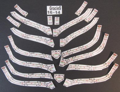

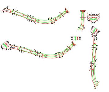

16-18 as duplicated - horizontal flip - mated - collapsed
The individual timbers isolated.

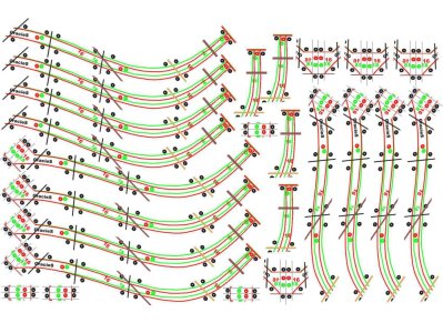

I made a provision for a series of short timbers. Gracie has a fairly short frame length with an easy curve. I chose to have one timber cover the distance from the keel to the rail with both frames in the bend.

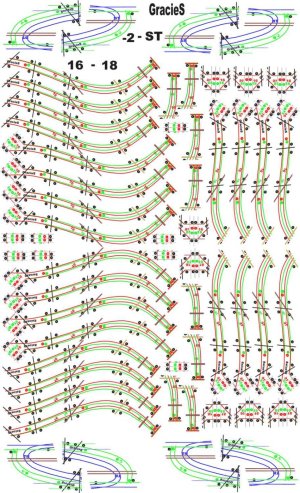

The timbers are arranged for a close fit within a 8.5" x 7" area.
The layer is duplicated and then a FLIP VERTICAL. Then moved to complete the 8.5" x 14" coverage.
I print out twice as many timber patters as I will need.
I use 8.5" x 14" sheets. I give each sheet a liberal coating of gloss brushing lacquer. This significantly stiffens the patterns and eliminates humidity effects.
The paper is much more expensive than 8.5" x 11" and the lacquer as become much more costly. The effect on the patterns is worth the time and expense.
When I first did this, I was trying to stimulate the effect of printing the patterns on Mylar. It does this except that when sanding to shape, the pattern still fuzzes and obscures the line. The process is: one pass then scrape the fuzz using a Gem single edge blade. Return to sanding.
A copy of the whole station section is used during assembly of each bend. The patterns are printed. This pattern is for use in the Sandyply board.

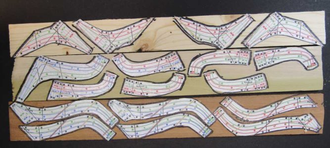

The pattern for each timber is cut from the sheet. The sheet as shown in photo 33b.
The patterns are bonded to the frame stock using quality rubber cement. A compete liberal coat is applied to both the pattern and the stock, The cement is allowed to dry. The pattern is carefully positioned over its area and then touched down. The grab bond is instant. No positioning is possible. The solvent for rubber cement - n-heptane - is needed to keep the cement at a brushing consistency.
The patterns are positioned on the stock with attention paid to the grain.

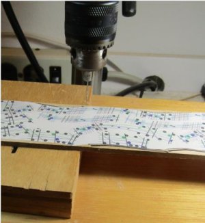

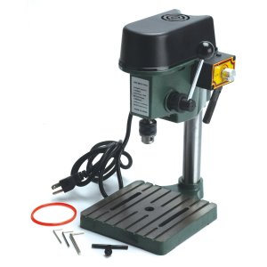

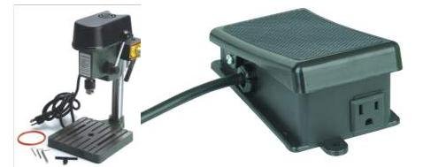

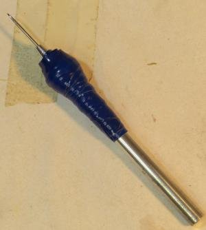

The holes in the alignment pin donuts are punched with a sharp awl - painters masking tape makes a better bulge for finger pressure than electrical tape.
I have had excellent service from a Eurotool DRL 300.00 drill press for about 10 years. I added an X-Y table that cost about as much as the mini drill press and fixed a 3/4" plywood table on it. A clamped 3/4" plywood slab with a crevasse for the saw dust is on top of the table. This whole setup raises the work area up about 5 inches - which is good for my neck muscles. The drilling process needs one hand to position and hold the frame stock, one hand to lower the drill press quill, and one hand to turn the drill on. A continuously running drill is dangerous to position. I have the #70 drill bit in the starter hole before starting the motor. I added a momentary foot switch in line with the power cord. My big toe is my third hand. The annoying part of this model drill press is the drive belt. The orange belt used with and sold for this machine uses a glue to bond the loop that lasts about a year - at best. I bought some 5mm green polyurethane solid tubing that is much stronger - but has almost no stretch - so it is more difficult to peavey/wrench onto the pulley wheels. I joined the ends by heating with an alcohol lamp - a cool flame. It has lasted for years.
This Eurotool drill press - as with almost everything else is a product of China. It is available as economy generic models and as a house branded version from Jewelers Supply and similar vendors. There is a QA factor involved. I bought a house brand model (Otto Frei). It has proved to be up to spec. I would not trust a generic model to have the same quality.
The quill is robust enough that I would use it for milling wood - mortise and notches - if the cutter is sharp and light cuts are taken.
