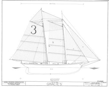

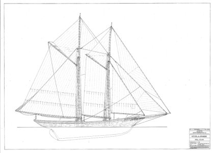

here is a peek at what the facility is hashing over in historical content, a study of the plans, research and how to approach a model build in different styles.
A pilot boat is a specialized vessel used to transport maritime pilots between land and larger ships at sea or near port entrances. These boats are designed for speed and reliability, ensuring the safe passage of vessels in congested or challenging waters. Pilot boats play a crucial role in maritime navigation, providing essential guidance and expertise to navigate through narrow channels and avoid hazards.
once this class is completed you as a builder should be able to build most anything from start to finish. a model does not have to be big with all kinds of guns sticking out and incrusted with carvings. A skillfully and well-crafted scale ship model is a thing of beauty and can be anything from a canoe to anything you want.
west coast
on the east coast
