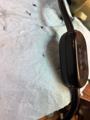

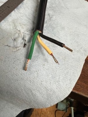

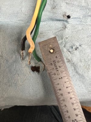

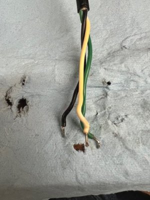

First up today is repair of the motor power cord. So first step was to remove the black tape to see damage, then inspect wire to actual damage which looks like a not so friendly rat or squirrel might have nibbled on.
I think I had show the power cord and damage in another posting so here is repairs.
I stripped back insulation on cord till I got to damages spot, which exposed about 4" of wire. Then I measured what I needed from original ends for installation.

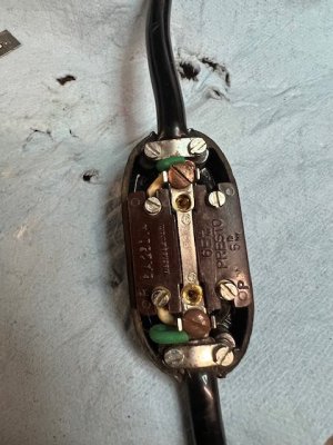

Next up was to cut and strip the wires and solder the new ends for installation in the switch housing.

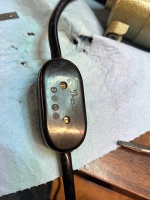

then it was time to reinstall the cover and check how it fit and went together, all was well at this point with repairs.

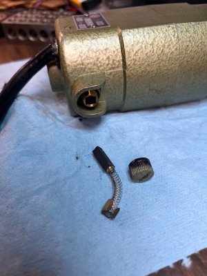

Last but not least as another user mentioned, time to check the bushes for the motor, they have a nice cap to remove and then pull them out, they both looked good so careful install was done, as they are slightly rectangular, to not go back wrong. Just had to make sure I didn't have them 180 out. Fun with spring cap end, as it also only fit a certain way in and pop the cap on and finger tighten.
Last but not least was a quick test run and all was well.

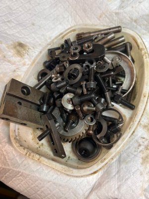

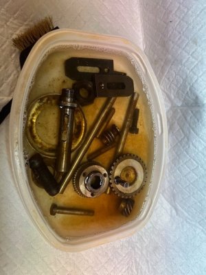

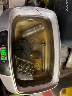

So this was a multi-step process, repeated in batches for small parts and all the hardware.
First up was a quick dip in degreaser to remove junk and grime, and any grease or oil coating.
Then a warm bath in ultrasonic cleaner for a few minutes to get stubborn stuff loose.
Last up was clean water rinse, and a bath in white vinegar, to help with rust removal. Other websites said the WV was safer than some other chemical rust removal dips, and I had some on hand. It worked well on helping get metal surfaces looking nice. At one of the steps, it seems that the "Bluing" on some hardware was removed, so I have replace that to help keep them from rusting.
So steps one and two went OK, but I learned water gets HOT in ultrasonic cleaner when trying to fish out the little parts that drop thru the lift basket.
Not easy to due with thick rubber gloves.
These are tub of parts after cleaning and ultrasonic cleaning waiting dip in white vinegar to help the rust. And the degreaser after about three batches of parts ready to be tossed and replaced with clean stuff.

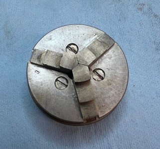

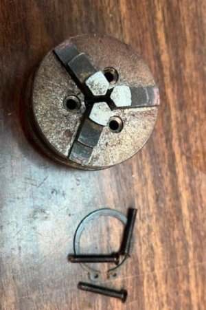

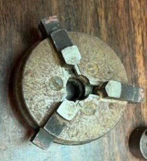

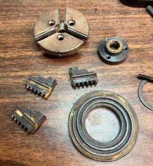

OK, up for more of todays work, I got the nasty rusty and crusted 3-Jaw chuck cleaned up and reassembled today.
Not too many parts on this one, main part is the moving back with spiral slots on it, which drive the 3 dependent jaws in and out. You have to insert the jaws in proper sequence aka 1-2-3 as you spin the back ring to bring them in. They can be brought all the way out and reversed, and again must be installed properly.
The back ring is held in place with a snap ring, and then there is a mount base which screws onto the jaw base, it has the threads that allow it to attach to the spindle shaft, or tailstock shaft as they are the same thread, 12x1.
OK, so I click post reply before adding photos.
The before photos showing cruds and rust.

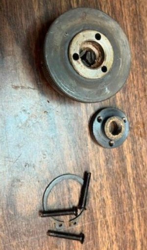

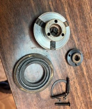

So here is photos showing the mount ring removed by removing three screws from front of jaw face.
These are photos showing back removed, with jaw still in front body, visible in center of jaw body and bottoms in slots, then the shot with jaws removed, which are so dirty you can't see the numbers on the side.
so now you see the cleaned and reassembled 3-Jaw chuck, ready for use, and you can see the numbers on side of jaw in last photo and on face of second photo, critical for proper assembly. Now to wait on my order of bars to use for opening and closing and tightening the jaw of death...just kidding there.

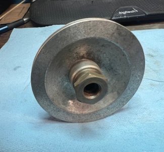

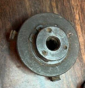

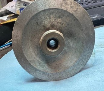

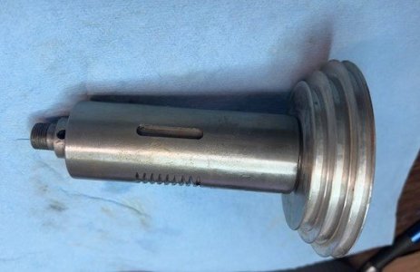

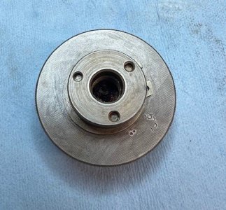

Also for nights pleasure for those up late the spindle is reassembled and ready to install in headstock when it is cleaned.
First up is photo of the spindle as removed and parts.
Next is photos of assembled spindle, except for spring, which will come when I am ready to install in headstock with motor mount bracket, as a working group.

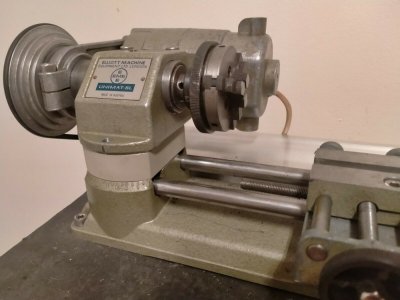

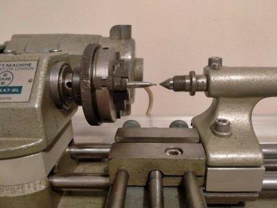

UNIMAT produced a riser block to significantly give more swing.
