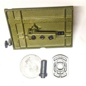

Bob, unfortunately I don't own one.
All photo's I may use will be factory kit unless I mention otherwise.
I have photo's of a a vast library of their kit options; I don't own half as much as I'd like.
I could spend weeks downloading this material, but won't!
I am happy to share here what I can on specific requested items.
The ones I posted include the matching tail stock riser, so between center work can still be done.
The table saw photo includes the headstock riser.
They did a nifty little machine vice too.

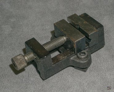

I have the machinist's vise. Nicely made item.

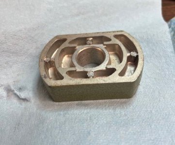

And I do have the head stock riser in the package I got with my Unimat.
Only issue with original is no hole for headstock alignment pin!

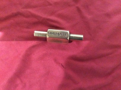

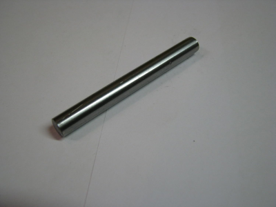

I have never seen that bar before, but one vendor of books and belts sells a version of that.
I've never seen an EMCO-made alignment bar, either. I have one from Little Machine Shop. It's quite handy if you are 1. going to be moving the headstock a lot or 2. want as accurate a cut as possible. The headstock locating pin (which is an item quite frequently lost) is probably just roughly aligned, due to wear or slippage, although I've never clocked mine. If you want as close to perfect alignment as possible, it's best to use an alignment bar, although the old razor blade held between two dead centers trick will yield a very close equivalent. $31 online. See: https://www.amazon.com/UNIMAT-lathe-alignment-bar-LatheCity/dp/B017FSXKI8
As far as I know, they never made a riser for the tailstock, so there would be no reason to align the headstock exactly because there would be no reason to do so without a tailstock. The headstock riser came as part of the table saw attachment. .It raises the headstock, and hence the table saw table, so it will fit clear above the the motor.
It is quite possible that EMCO considered the use of headstock risers on both the headstock and tailstock for turning larger work to be inadvisable. As a workpiece diameter increases, the faster it turns and the greater leverage it places on the cutting tool. Those increases may have exceeded the designed parameters of the machine and they didn't want to encourage people burning out motors and otherwise breaking their Unimats by overloading them. I have no factual evidence of this, though. It's just a theory to explain why there's no tailstock riser in the catalog.
Thanks for the info on the alignment bar. I have seen one video on a similar pin for this purpose and how it was used, they said about 95% accuracy with this method, which is good enough for general work.
I expect you'll want better than 95% accuracy at some point. The headstock alignment pin is really only for "quick and dirty" centering of the headstock when using attachments like the table saw, etc. It's not intended for precision work. "95% accuracy" is plus or minus five hundredths of an inch. The machine is easily capable of working to tolerances of plus or minus two thousandths of an inch. Big difference when you are making small things that need to fit. :oops:
Precision depends upon the alignment of the head and tailstock, as is true of every lathe. The convenience of an alignment bar is that it is precisely machined to be perfectly round in section and to fit precisely into the headstock and tailstock holes. When the bar is held in the holes, by inserting it and sliding the tailstock towards the headstock to hold it, your headstock and tailstock are perfectly aligned. It just takes seconds to do.
