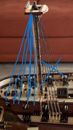

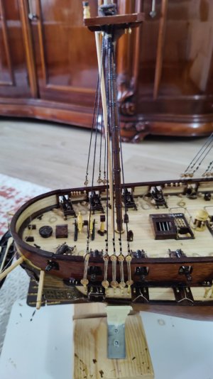

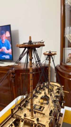

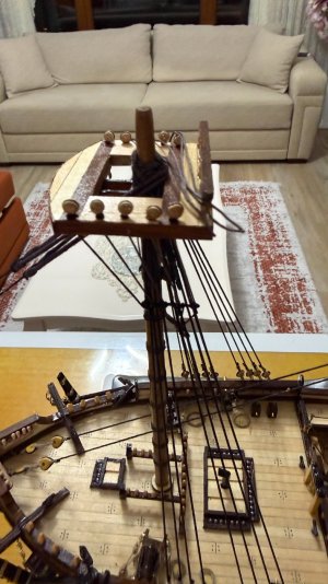

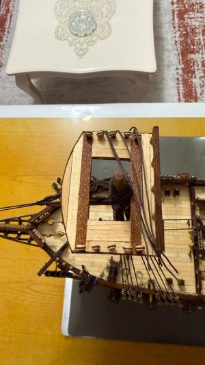

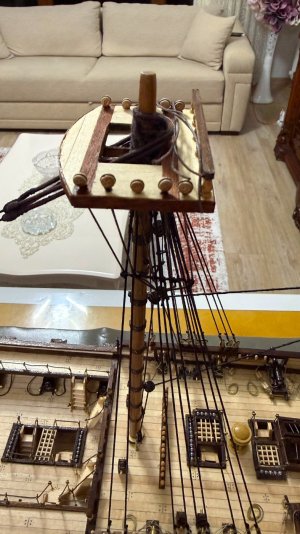

I'll check the plan. But if that's the case, then this situation, that I overlooked this, is embarrassing for me.I’m sorry, my friend, but the mizzen mast shrouds are unacceptable. These shrouds should be pulling the mast backward toward the stern, not forward. The deadeyes should have been positioned further back on the ship's hull.

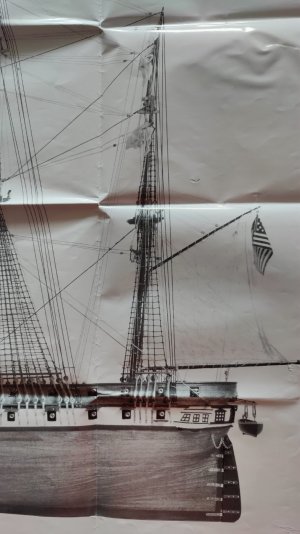

How are they shown in the kit’s plans?
Don't be embarrassed, I have so many things pointed out to me on a regular basis and redo's are part of this hobby. We never stop learning I think and that is part of the funI'll check the plan. But if that's the case, then this situation, that I overlooked this, is embarrassing for me.

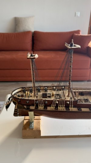

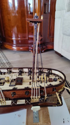

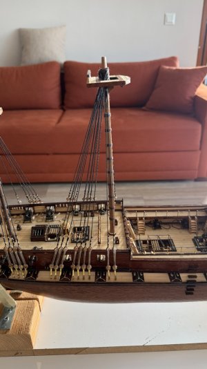

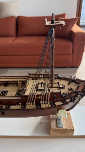

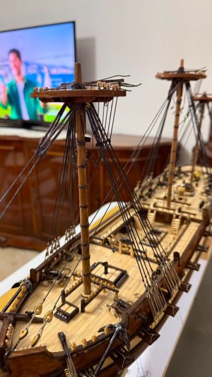

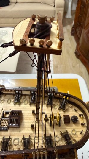

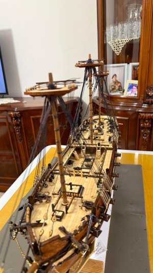

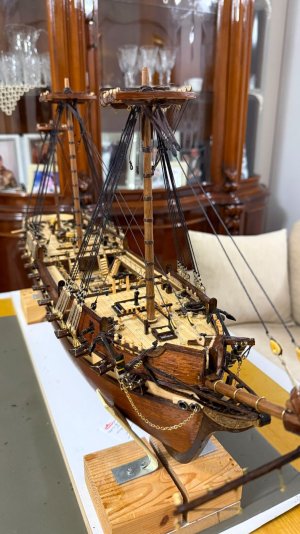

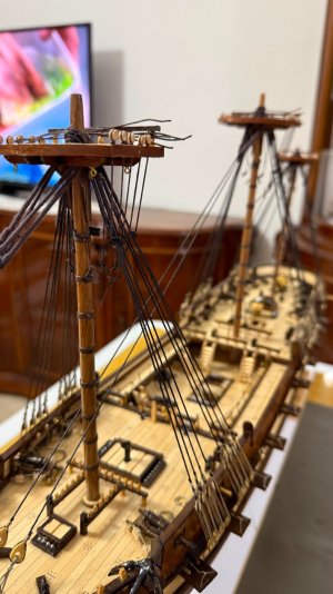

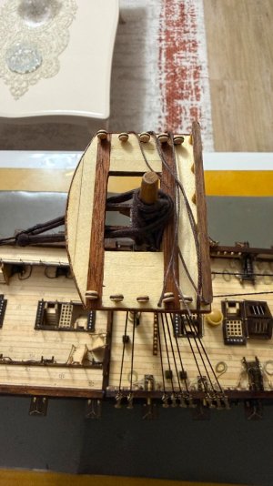

Yes, now it's correct.What is your opinion, Dear Master?
Nice recovery.@mtbediz1 I finally corrected the mistake. I also compared it with the plan. I hope I don't make such a mistake again, but the positive side is that it seems this is necessary to find the right solution. What is your opinion, Dear Master?
