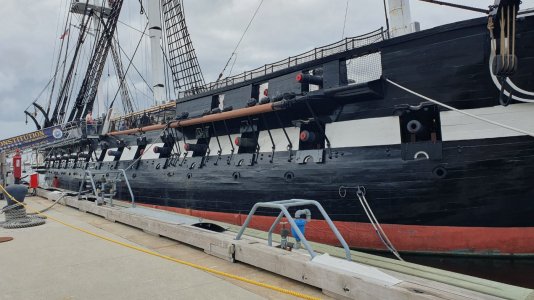

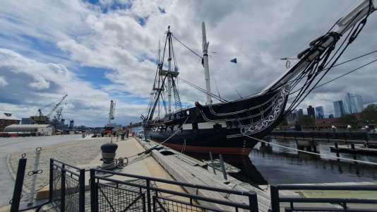

I am looking at something that makes me smile. I just noticed that the fenders are painted red. Excellent. Red it shall be!
