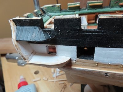

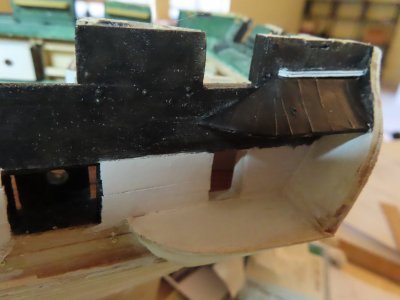

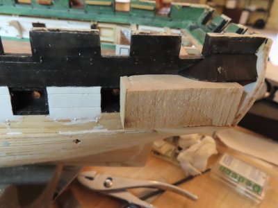

Once I made the molding, I had all my parts for the quarter galleries’ roof. The roof molding was cut and painted first. Using the gallery spacer block, the roof pieces were glued into place level with the gallery floor. Touch up painted was added to the remaining exposed transom wall. Finally, the roof molding was added to the roof. So far, so good.

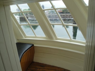

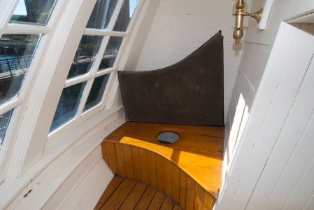

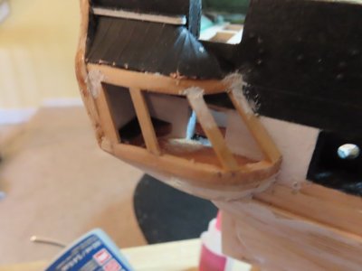

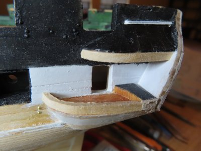

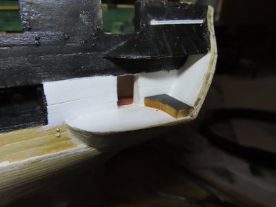

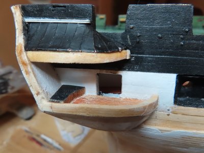

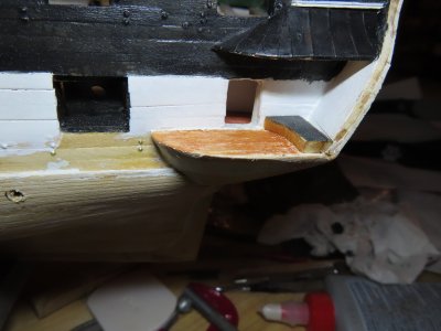

Nobody, as far as I know, has attempted to place anything inside the quarter galleries. So here I go again. In the practicum there is a photo (HP7.2.5.-1) of the port quarter gallery annotated with numbers for the instructions of the practicum. It also shows that an outside viewer can see the interior of the quarter gallery. What can be viewed is a bench seat, which on the starboard side lifts to reveal a privy, and a wall sconce light. The bench seat is easy to make, the sconce is not. If I was adding interior lighting, I might have considered it, but since I have no electrical skills, the light is out (pun intended).

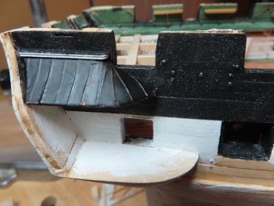

Constructing the bench seat was straight forward. Using the Starboard image with the privy revealed, I eyeballed the shape and height of the bench. The base was scored to give the impression of vertical boards. Also, the image revealed that the floor had to be repainted as I had initially painted interior completely white. This meant scraping the white paint off with an X-acto blade and staining the wood. By the time the windows are installed, I doubt any fine details will be visible, but the viewer will know something is in there. Again, my philosophy, the closer you look, the more you see. It keeps the viewer engaged.

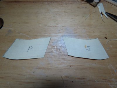

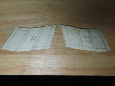

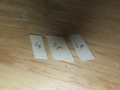

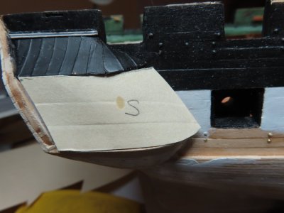

My first attempt, hopefully not my first of many attempts, was to make a card stock template of the surface of the gallery window area. What makes this this a bit tricky is the template is three dimensional as it curves around. Based on the US Navy plans, the windows have a slight vertical bow although the plans did not show a view to indicate whether there was a horizontal bow. The vertical bow was so slight, I don’t think it would be discernable at model scale. My template does not capture that bow. It will be used mainly to get the overall window positions and dimensions.

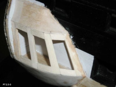

The practicum would have you install the vertical posts first then install the window headers and sills. That is six horizontal pieces that must align perfectly. Mr. Hunt came very close to achieving that. Kudos to him, but I don’t know if I could do the same.

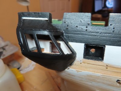

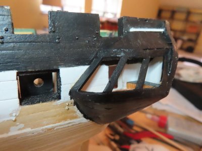

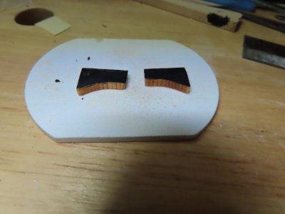

I chose instead to construct the headers and sills slightly differently. Instead of installing the posts first, I decided to install the headers and sills as one piece each, guaranteeing the horizontal lines are true. Since the verticals don’t have to line up with each other, any slight error with those will be unnoticeable, at least that’s the plan.

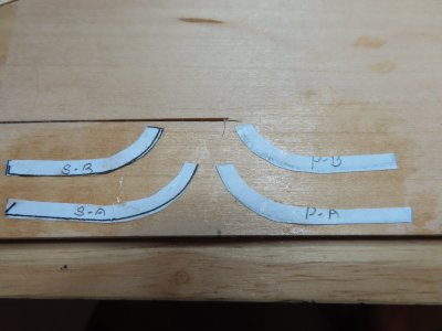

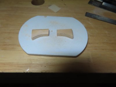

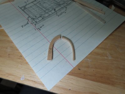

To make the sills and headers, I initially tried to bend the wood with disastrous results, so I cut them out as blanks. Then they were carved to their final shape by trial fitting, filing, and sanding. As it turns out, I was a little short in length, so I had to fill the gaps with additional wood (color change).

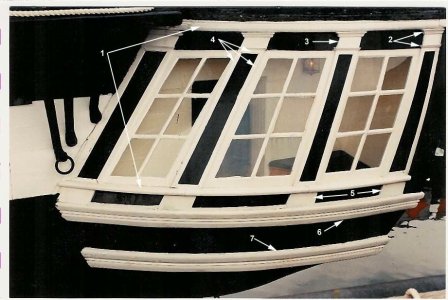

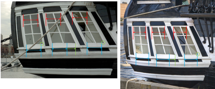

While I was fiddling with the headers and sills, I kept looking at images of the quarter galleries trying picture in my mind their true shapes. Using images that were taken at an angle to show their proper shapes better, I noticed something about their dimensions. All three of windows have the same width for their header (as measured from the glass panes). The vertical elements of course are at different angles. The sills of the outer windows are very close to being the same width, but not quite. The center windowsill is approximately a half to two thirds of a pane of glass wider. I checked this on two separate images with the same results.
In the picture below, the red dimensions are all the same as each other as are the blue ones per photograph. The green dimension indicates dimensional differences. The kit supplied windows do not even come close to these proportions. Now I have an idea as what my model windows should emulate.

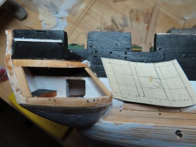

Using the window template, I made earlier to help me get a handle on what the windows should look like on my model, I sketched out the window frames by eye. Not surprisingly, when laid out flat, you can see the complexities of the window frames.

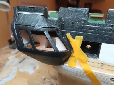

Based on the template, the vertical window posts were added to the outside edges of the galleries. Then using the template marks, I made on the sill and header as a guide, the two inner posts were added. Where there were some minor gaps, filler was used. Once everything was sanded, per the practicum three coats of polyurethane were applied and sanded. Finally, a couple of coats of black hull paint.

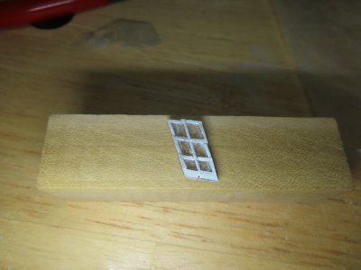

For the sashes I am using 1/64” birch plywood for its strength. My second choice would have been boxwood, Since the final product will be painted white, no one will know what kind of material was used. The sill will use 1/16” x 1/64” plywood. The stiles and header will be 1/32” x 1/64” plywood. And the muntin (sash bars) will be 1/64” x 1/64” plywood. All these strips of plywood will be cut from a 1/64” birch plywood sheet using the Byrne’s saw. The plan is to follow the practicum’s method of construction…for the most part.

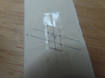

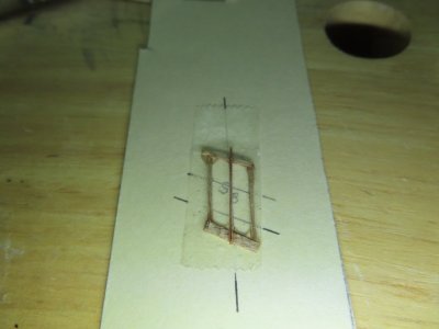

The first thing the practicum tells you to do is make a template for each window opening, which I did. It then has you double side tape the template to a piece of card stock, which I did…wrong. I laid down the tape on the card stock and then stuck the template on the tape, so it was card stock tape, then template. That left the template without a sticky top surface, which was the whole point of the double-sided tape. Got it right on the second attempt.
The sill, header and styles were laid down on the tape which held them fast. Next came the vertical muntin which was laid down very carefully into position. Most of the pieces were made a bit long so they could be handled easier. The excess would be filed off later. A few fine drops of CA glue at the joints and everything was what it should be…or not. Here is where my cunning plan started to fall apart.

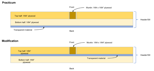

Because Mr. Hunt used styrene, he didn’t have to think about painting. I knew that I had to paint the sash before the last step installing a transparent material (not determined yet) for the windowpanes. Additionally, I noted that Mr. Hunt’s windows had a gap between the muntins and acetate he used for the panes. When he finished constructing his sash, he’d flip it over and apply the acetate to the inside surface of the window border. Therefore, his muntins were 1/64” above the acetate. This required that I modify his method slightly.
As shown below, the modification would require that the transparent material be sandwiched between bottom and top elements of the window border pieces. This would also increase the gluing surface for the muntin installation thus increasing the structural integrity of the window sash… Or so goes the theory. Next immediate steps: remove the vertical muntin, remove any excess glue, smooth the surface, and paint the outside border of the partial sash white.

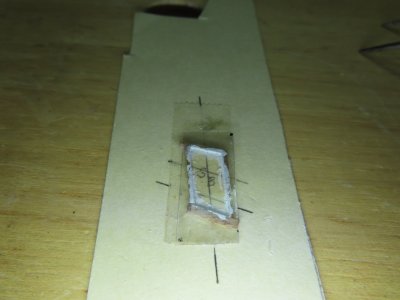

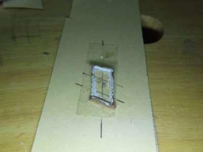

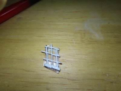

Following my plan, by laying down the inside frame pieces on the template which was fastened down with double sided tape once again. These were glued together at the joints with CA glue. I tried to only paint white the inside surfaces of the muntins. I wanted the gluing surfaces bare wood. I tried sanding off the excess. It looks worse in the photos.
Next came the mica. Using just scissors, a slightly oversized piece was cut from the main sheet. I planned to trim everything at the finish. CA glue was applied along the top surface of the frame and the mica laid on top.
It was at this point; I saw the major flaw in my modified cunning plan. I didn’t have a sticky surface anymore to hold the remaining 16 pieces to complete the sash. Everything now had to be glued to the slippery mica. Mica is very smooth and CA glue needed something to grip to. Even worse than that, because the sash pieces were very short, thin, and narrow, they tended to jump from the surface of the mica to my CA needle applicator due to surface tension of the liquid CA. Needless to say, there were numerous “do overs.” I should also point out that all the pieces had to be pre-painted while still a stock of wood, then cut to size.
Finally, I was able to get everything glued together. Peeling the completed sash from the tape was a delicate maneuver which didn’t go as smoothly as I would have liked it. The mica surface lifter off the inner frame which had to be glued back down…again.; some sash pieces had to be reglued into place.

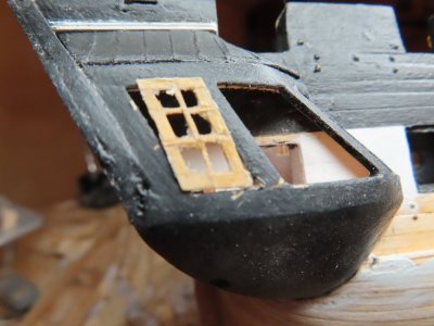

Finally, I was able to trim the excess and smooth the edges. I had a complete window sash with just one minor problem…It didn’t come close to fitting the window opening. Somehow through all the machinations of gluing, parts coming apart, re-gluing, etc. the vertical angle of the side of the sash changed. But I proved the concept through trial and lots of errors.

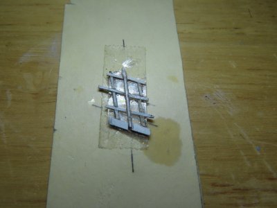

To make things slightly easier (not simpler), my next attempt will attempt to build the window sash from the outside, inward as opposed to the way this one was made, inside outward. All 15 pieces of the outside sash component will be placed on the tape first and glued all at once, then the mica, and finally the four larger pieces of the inside sash. Hopefully this will work better, go faster, and everything will be cleaner, neater, and remain glued together.
Well, Plan B failed. I did what I intended, built the sash in reverse and it was easier than I had hoped, but like Plan A, not practical nor accurate. This time the problem was removing the partially constructed sash from the tape without breaking it. I thought I would be able to paint it before the mica was attached and secured with a backing bringing the total thickness to about 1/32”, but when I checked to see if it even fit properly in the window opening, well you can see what I saw in the image below. I hadn’t even cleaned it up, no point.
I believe the basic problem is that the component is so small and delicate, any error compounds and magnifies any distortion. I still have at least Plans C (another method), D (jacknastyface2 method*) and E (Practicum’s method). So, it’s off to Plan C where I will forgo using a template and get my sash shape directly from the window opening. Stay tuned to the next installment of “Crash & Burn or Possibly Survive.”
