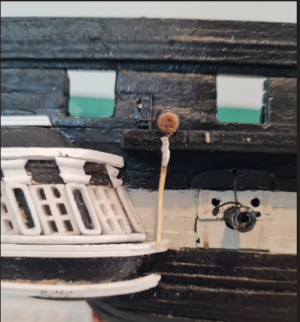

I have to find something to fit in the holes at the bottom of the chainplates. These holes serve to attach the chainplates to the hull. The nails they gave are too big for the holes. Lauch Street suggested using model train rivets, so I ordered some, but I don`t like their look. Maybe once they are painted it won`t show that they are made of plastic. I hope so.
I can also try to widen the holes but I don`t have a lot of extra room to work with.
You can also try cutting some thin brass rod and use those as nails. If you want you can use thin slices of small diameter styrene rod glued over the ends of the rod/chain plate as the head of the rivet but at this scale you probably don't need to bother.
great idea. thanks

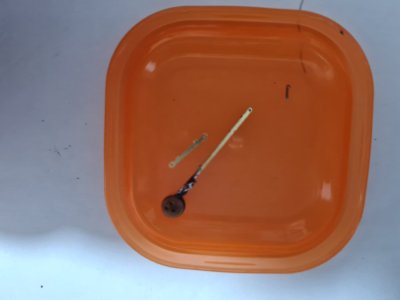

Here is one that took me about 2 minutes to make. It seems solid enough. I dare not file it further as I will probably wind up removing all the solder. As usual, there will be a 1/16 x 1/16 piece of wood that will cover the front of the chainplate thus locking it into place.

I have to fit the rivet into the holes(reamed with a #75 drill bit) in the chainplate assemblies then attach to the hull with another rivet. The rivet is the little brown thing at the top right and the chainplate assemblies are the two other pieces. I have to clean the solder and paint everything black. Then rince and repeat.
