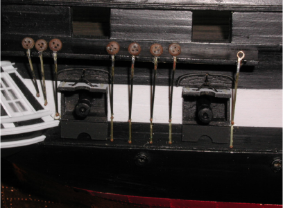

I have to fit the rivet into the holes(reamed with a #75 drill bit) in the chainplate assemblies then attach to the hull with another rivet. The rivet is the little brown thing at the top right and the chainplate assemblies are the two other pieces. I have to clean the solder and paint everything black. Then rince and repeat.
For how many chainplates?

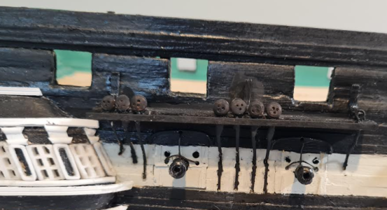

Small update. After fiddling with the plastic rivets for a while, I decided to give up on that idea. In addition I decided to paint the deadeyes and the eyebolts black because I didn't like how they looked unpainted. This is my first attempt at soldering chainplates. It's really hard because the pieces are so small.
I feel your pain.
Jack Sparrow - I felt the same pain. I used Testors Matte Black acrylic model paint and it was thinned already and it went on nicely and didn't clog up the holes which I thought was going to happen. The chain plates were not fun whatsoever. I used that small stand with the clips on each side to hold the deadeye with the wire and the other with the brass strip and then I positioned the tip of the brass on top wire and then put my soldering iron under the wire pulled away immediately when I melted just a touch or solder. This leaves just enough to keep everything together otherwise any longer and globs up and hard to clean up with a metal file. I also used copper wire around the deadeyes because I thought the brass wire in the kit sucked and broke too easily and kept unfolding itself. Copper was easy to solder and a great conductor and that's why I laid the brass on top of it. After you paint them, you would never know anything was improvised.

But overall it is a very challenging process. I didn't use the brass wire. Instead I used dark annealed steel wire. It twists quite well. Now that I think about it, maybe I should sand off the dark stuff on the wire. That would explain some of the difficulties that I am having.
Steel wire can’t be soldered unless it is zinc galvanized.
I am going off a couple of references that I found on the subject. I didn't clean the steel properly but I did put a tonne of flux. I will do a mechanical cleaning in my new procedure to see if it makes a difference.
