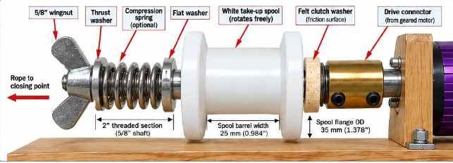

I decided to add another control variable on the planetary ropewalk called rope tension. So now i have head rpm, feedrate, strand tension and rope tension.
The idea is to leave head rpm alone, set rope tension and to use the feerate to maintain constant lay. I have purchased a loadcell and display that I will use to measure the tension so that I can keep it constant. Should be interesting to see if I can dial in this machine and record recipes for different sizes of rope and lay. All this sounds great on paper. I hope I can deliver. If not I'll be awefully disappointed.
Well here is a sample of a z twist rope that I generated with this setup. The rope was pulsing on diameter and I tightened the tension on the rope and that seems to have stabilized it. I also adjusted the feedrate so that the lay is less tight for a head % of 30. I do have some control of the lay, which is great. I haven't set myself any targets for rope diameter and lay length, but that will be my next step. At this stage I just wanted to see if I could get something that looks like a rope.
What do you think?
someone reviewed the picture and told me that the rope was uneven and showed signs that the strands had unwrapped. I tried to make a z twist rope from a z twist rope, which won't work. I need to make an intermediate S twist rope or unwrap the strands and rewrap them into a S twist.
