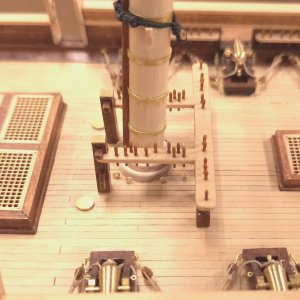

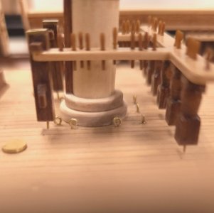

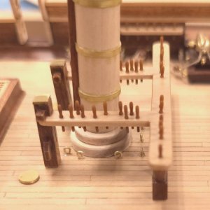

Before I glue the main mast in to the hull, I needed to deal with a couple of small housekeeping items.
First, I had to put pins underneath the stanchions of the fife rail and mark where on the spar deck the fife rail needed to be mounted.
Then I had to locate the positions for the nine eye bolts that surround the mast at its base.

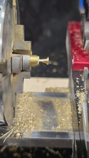

While the mast was still off the boat, I thought it best to fit the ship's bell, which of course I need to fabricate. I managed to get pretty far along on that the way before I had to call it quits at the shop today. It being Manhattan Club night.

I'm not gluing the Fife rail in until after I rig the mizzen stays. I just dry fitted it the purpose of the photo app.
Unless I decide to also add the pike rail, after the bell is mounted, I'll start on the shrouds.
