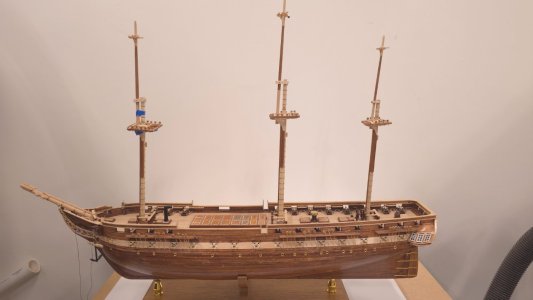

Before I launch into my "Output" over the last day or two, I was reminded that I haven't posted a photo of Connie herself in a while. Here's one with the lower masts dry-fitted:

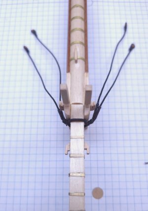

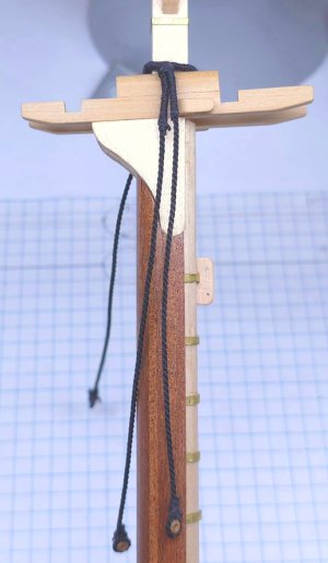

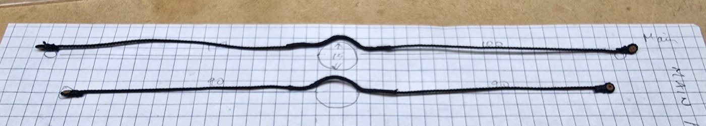

"Rigging" is officially underway. First up, pendants for the main.

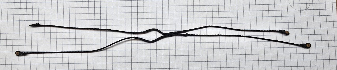

I opted to do them differently than both the plans and Mustafa. I think the concept explains itself - more or less.

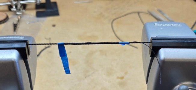

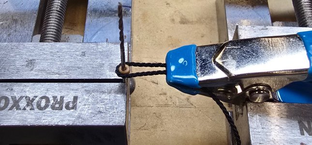

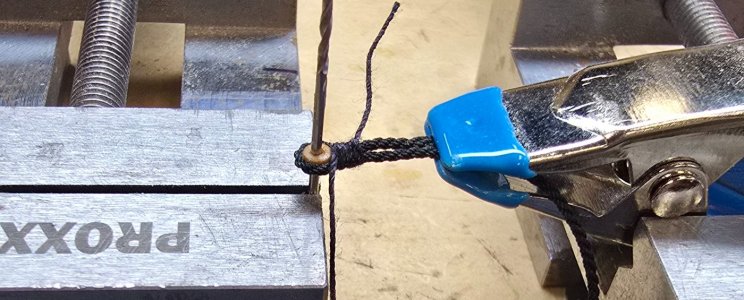

Well, this might require some explanation. After calculating the total length of both the long and the short pendants and eye-spliceing (is that even a verb?) the thimbles, I had to seize the center sections of each pendant. I know this sounds crazy, but I actually found it easier to do these relatively short lengths by hand, given that the thimbled (is that even an adjective?) were problematic to set up with the Seize-o-matic from Syren. The tension on the pendants between vices was nice an taut. Now that I have a better idea of how much rope to allow for the thimbles, for future pendants I'll do the seizing first using the gizmo

Here's the departure from the plans. I figured that I didn't need the loops, since the part that wraps around the mast will be hidden by the shrouds that will come later.
