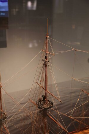

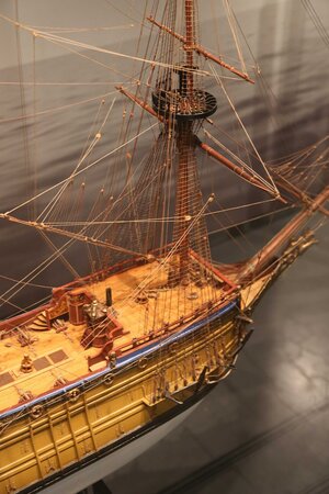

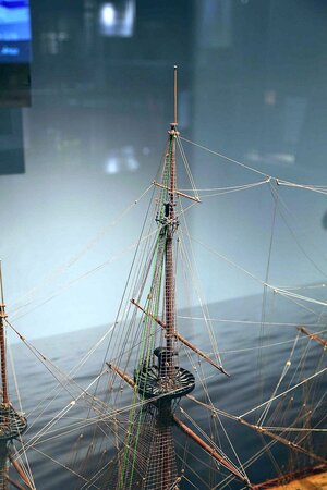

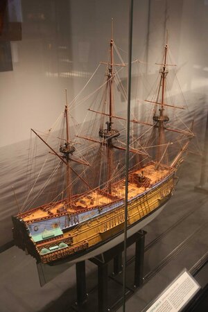

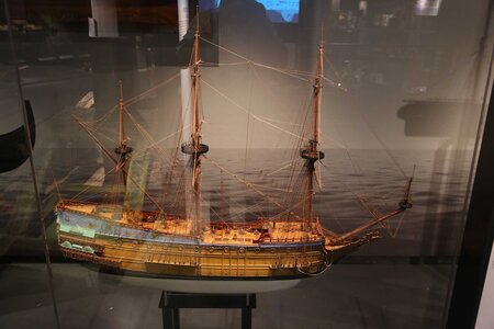

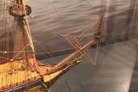

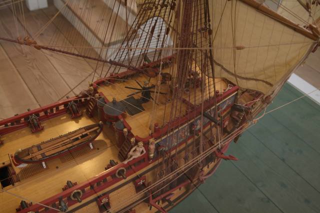

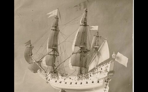

Looks like that site with Sophia Amalia is not accessable any more, but a few years ago I ve saved some photo... model made on highest standart, and there are a lot of interesting which couldvbe studied, and I think usefull for Vasa modelling , including topmast backstays ! :)))
Thank you, Kirill. I actually found another source apart from the one Daniel uncovered. I will certainly be spending some time looking at this beautiful model of a 1650 galleon.
JUST GREAT!!!
Thank You Very much!
There are much more details could be seen that on foto which I have... very interesting how they played with upper sails tie halliard! ...
Alternatevily if not strictly follow Vasa museum model rigging plan, than this version could be used! in some aspects such experiments will be very interesting , if someone will try to reproduce this version of rigging on galleon model!
Kurt,
Thanks again!

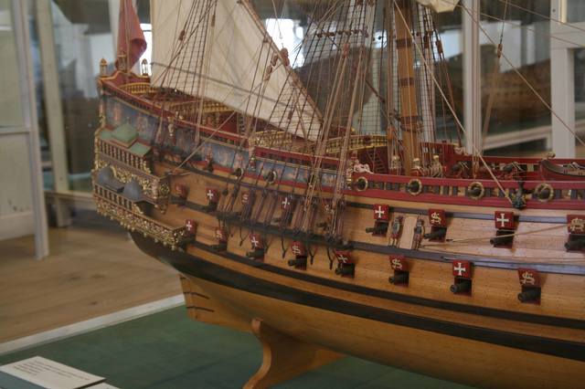

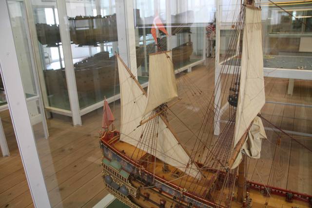

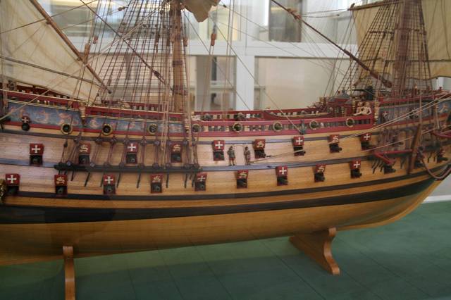

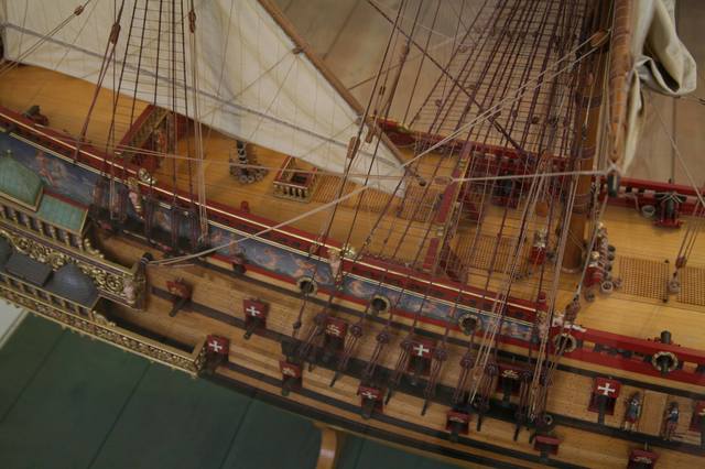

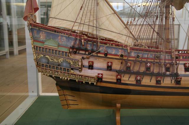

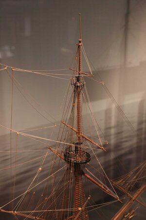

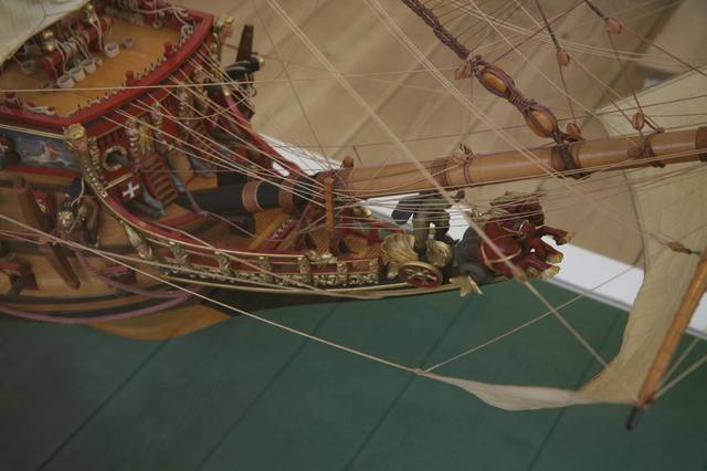

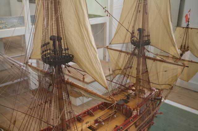

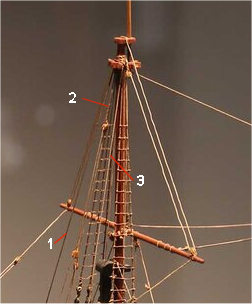

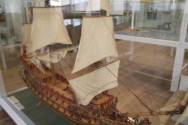

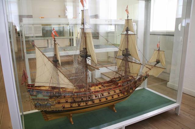

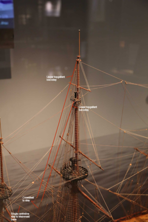

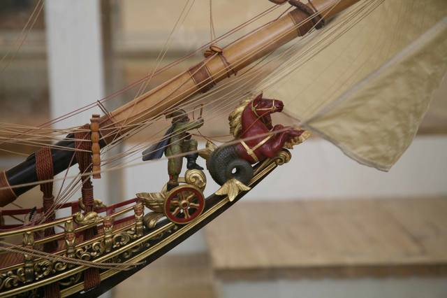

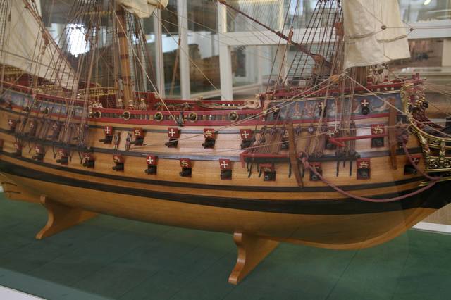

Wow, they are truly magnificent models (and at 1/30 scale!!). I note that the two sites are of different models of the same ship however (eg examine the horse and chariot at the front of the bowsprit, sails and no sails etc etc). The bulwark flank decorations are stunning.
The rigging too is especially well done (albeit at 1/30 scale) and while I agree with Paul that awaiting Fred Hocker's communication and comments will most likely direct how he rigs the backstays, from what I see, the Sophia Amalia has rigged backstays with support from the main stays centrally aligned, not secured to port and starboard (see below), at least from the mainmast topgallant. It's a little harder to see from the foremast topgallant because there appears to be at least two separate stays running forward from the foremast.
Nevertheless, a wonderful model and one not widely known, given its provenance and time.

Good day,
Dear Peter,

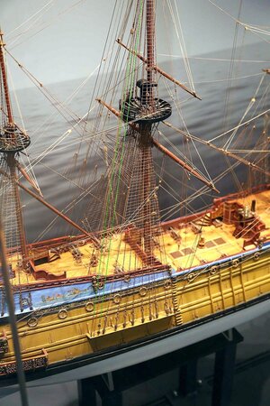

You are too fast in making decision, top mast and top gallant masts backstays - there are different lines, which pendants more dark in color... and they went down to the chainplate\deck level,pls check foto more carefully...
You missed some lines and lead blocks of that tie halliards ...and while missfit drawing red lines You jamped from tie halliards lines to backstays lines when making color mark them...
but that lines which You marked" white" , they are still upper sails tie halliards, and they yes , partly secured to the stays by crowfeets...tie halliards ,in principal ,there are same arrangements as fermormed on Vasa museum model...

I don't see those lines the same way either, Peter. Take a closer look at them again.
Kurt and Kirill4,
Thanks you for your constructive comments. While I can see what you are saying, the resolution of the images make it almost impossible to tell (maybe it's my poor computer monitor). I can only see three possible lines from the main topgallant (labelled 1, 2 or 3 below). Line 1 is the one I have thought was the backstay (as per the previous post).
Line 2 goes to a block, divides and then divides again at two second blocks (I think). It is really difficult to then see where it is belayed. These could be backstays I guess???
Line 3 continues I think to a block but then descends, I assume to deck level, but again the belaying point is not evident.
So, I am likely wrong, but I don't think we can see in the photos enough to confidently say how the backstays are configured or where they are belayed.
Regards,
PeterG.

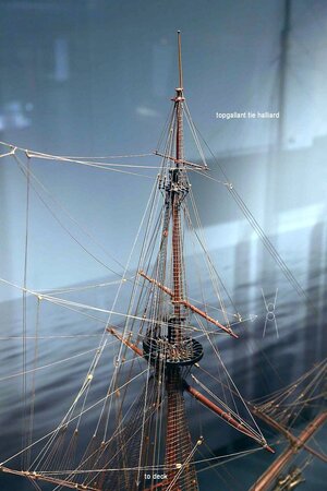

1 and 3 - they are topgallant backstays,port and starbord, 2 - topgalland tie halliard -as You said ,this is devided into complex shape of leading blocks and crowsfeet and final fall goes somewhere to the mast base... more clearly could be seen on fore mast
Oh! not exactly the same as on main mast on the fore mast they did topgallant tie halliard a little bit different! :)))
possible arrangement in my interpretation
