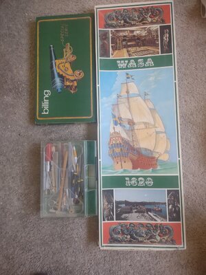

So some background... I am a member of Model Ship World as well and have been keeping my eyes open for kits or tools as I have just started out about a year ago with full ship model building. As it turns out, someone who was 20 minutes from me retired from making ships and gave away a free kit that was started which was on my list of ships I would like to do.
You see there is a lot of people who do the victory or the constitution but not have done the Vasa...the marvelous ship who was gorgeous in looks and that's about it as it sunk in 30 minutes of casting off lol. But I love the look and beauty the ship has and am quite drawn to it for sure.
So I picked up the kit and got to meet a fellow shipwright who is in the area and I can chat with and meet at events and such which is really a blessing in it self. So these are some photos of the kit I got and all the parts so we have a starting ground

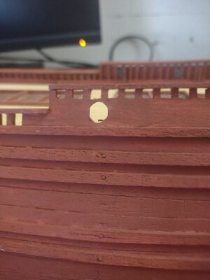

So first idea is ok let's tackle these gun ports and going through these I got one side cut out and measured using a piece of balsa with a gunport glued on the end to make sure it fit. IMG_20220122_094027206.jpgIMG_20220122_094018743.jpgIMG_20220123_180435031.jpg
And I thought hey this doesn't look bad so let's go with this and do the other side.... Yea then I go an itch with the fact of what I didn't like. So I tried the good ol wood filler and sanding method and found I liked it A LOT better then the other side IMG_20220211_222642746.jpgIMG_20220211_222653248.jpg
And this is what I ended up with after painting and a lot of sanding and shaping to get it nice and flat.
IMG_20220226_114526396.jpgIMG_20220226_114753068.jpgIMG_20220226_114510483.jpgIMG_20220219_115629465.jpg

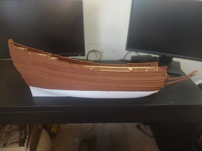

Next I said ok let me try to do some work on the transom which was not too bad. Just some measuring and sanding and I was able to get them pretty well situated. Only issue is that the Wales were cut a little too much so I will have to tackle that after I get the rest of it built up and see what space I'll have left over. IMG_20220306_104930792.jpgIMG_20220305_111647428.jpgIMG_20220306_104925739.jpgIMG_20220306_104930792.jpgIMG_20220306_135538503.jpgIMG_20220306_135506025.jpgIMG_20220306_135531200.jpgIMG_20220306_135546651.jpg
I made sure the are 90 degrees to the hull and equidistant in length to make sure everything will line up correctly when I add all the bells and whistles.

So going through my process I decided it's staining time for the deck. Did a quick sand and wipe down then used my pre stain and tested one more time each color and was very tentative...but I think it came out really well!!
Then I decided to do the red to start getting everything to the right color. And I just used cadmium red but it was so dark it didn't look right.
So now I'm putting a coat of gesso and then doing white banisters and red on the sides IMG_20220319_152643750.jpg
