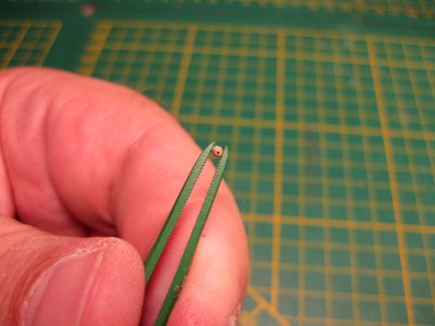

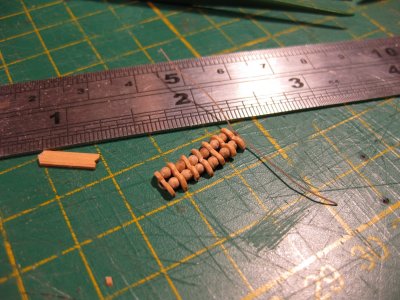

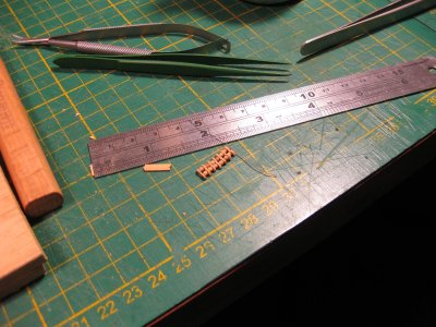

But today I felt like trying something new on my ship. I had to make parrel trucks for the mizzen yard.
And with a scale of 1:75, those things have to be very small. They are not available ready-made, so making them myself is the only solution. After much trial and error and a number of failures, I found a good method. All I have to do now is make the holes in them.
Here are a few photos and a video at the end. It's going pretty fast this way, and I'll keep going for a bit. Because I think I'll need a lot more.
View attachment 556812View attachment 556813
Link to bur: LINK
View attachment 556814View attachment 556815View attachment 556816
Thanks for stopping by....

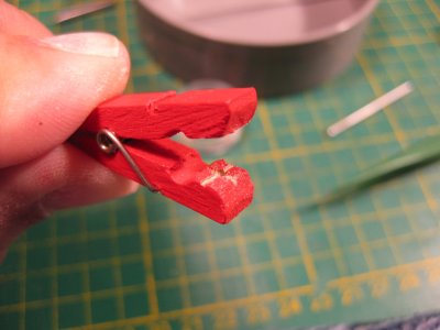

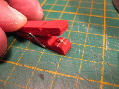

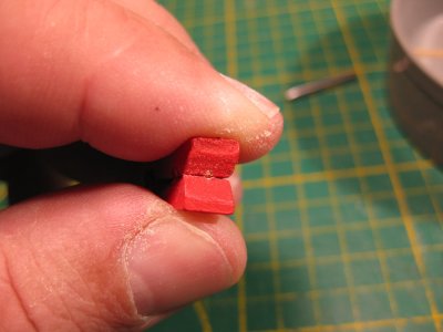

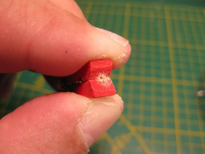

I made a little jig for the holes in the parrel.
I hope the picture tels the story.
I used these clamps, used for hanging christmas cards, drilled a hole from side to side when clossed and make a round bed (round bur in right size) in the crosspoint on each side. Clamping the parrel and drill from the front a hole straight thru the middle.
Making the parrels goes a lot quicker now.

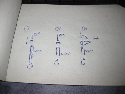

See drawing above, I start on the woodstick from above and make the top round. I keep turniong the stick between my mingers all the time.
When the top is round, I move slowly to the side with the bur. Still keeping the stick turning around between my fingers. The ball appears and looks even more perfect then the one in the video. The bur I used was new, but after using it, the sharpness is a little bit less and that is perfect. But make sure not to burn the bur or wood. Smoke is end of life.

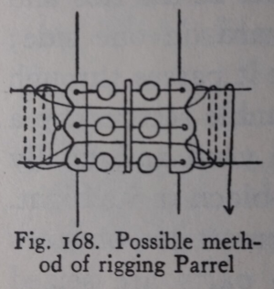

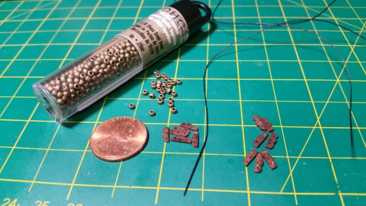

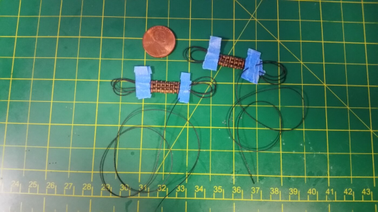

Your method for making wooden trucks is ingenious! As an alternative for other builders, if you want to save time making trucks for parrels, and you aren't interested in making them from wood, here is a nice shortcut. Use brown glass beads.
Prepare the parrel rigging assembly like this from the drawing above using tape, and slip the yard through the end loops after wrapping the assembly around the back of the mast. Even at 1:100 scale, it can be done with enough preparation and patience.

Thanks, and it goes fast. 1 parrel takes a minute to make, include the hole.
Thanks but it takes less then a minute to make 1 parrel with hole. And it goes everytime faster. So waste of time?
I made another video, it shows better how it works.
And I can tell you, when you sit down and start making these parrels, it takes about an hour to make 70 of them. I took a little longer because I wanted to film it. Less then 20 seconds to make a ball out of the stick and about 15 seconds to drill a hole. And it works the best when the stick is round and not square.

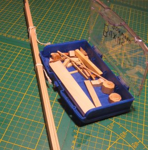

The rack for the mizzen mast is ready. The slides were quite a challenge. I have many types of wood in the form of strips, all from old building kits. However, when constructing something this small, you need a type of wood such as castello or boxwood. I have 3x10 mm castello strips, which I used for this.
First, I sawed a long strip of 70x3x1.2 mm and stuck it to the smooth side of the table with double-sided tape. Then, using a mini kanna, I planed it down to a thickness of 0.75 mm. There is a discussion here on the forum about a drum sander. Whether or not to buy one or build it yourself. I'll be honest, if you build on my scale, as I do now, you don't need one, at least not often. If you are going to sell kits as a business, then it is not an unnecessary luxury. But even if you are making a larger model and need to cut large quantities of wood to size, this can be a useful tool. However, as I mentioned above, most of the work can be done with a small plane, scraper, or sanding block.
The rack
I think the uneven shape of the sleds and balls has a certain charm, especially for a Dutchman. Things weren't so precise back then; it just had to be functional.
What you see in the photo is a rough assembly; the original rigged rack will look different later on.

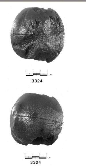

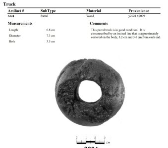

Archaeological picture of a parrel
so mine parrel of 1,7 mm. at scale 1/75 is just 0,6 mm. to big. I can live with that.

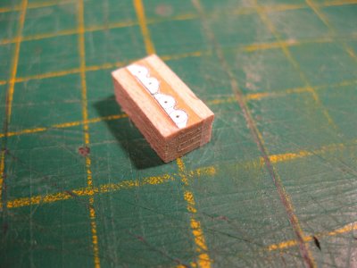

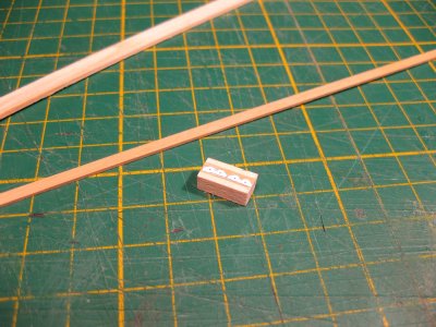

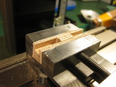

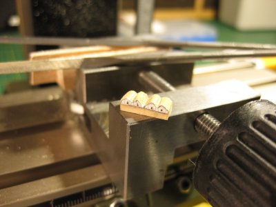

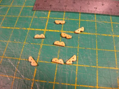

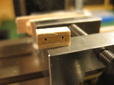

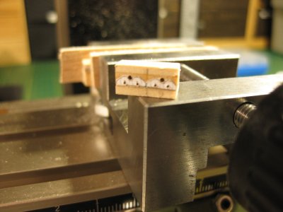

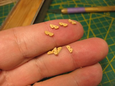

I will show you how I make the sledges for the rack using photos.
First, I glue four strips together, which can be used to make eight sledges. I use the paper-thin double-sided tape.
Then I glue a lime wood strip to the sides, top, and bottom edges, which I then sand immediately. I use regular white wood glue for this. I place the paper template on top and then drill holes.
Once the holes are in place, I sand the shape with very fine files.
When I think it's good, I remove the bottom plate and separate the pieces. I clean and polish everything as well as possible with a blunt cutter. I still have to go over them once more with 600-grit sandpaper to remove the last bits of glue. But you can see how it works. Polishing with the cutter isn't easy when you have clumsy fingers like mine. But I manage it anyway.
