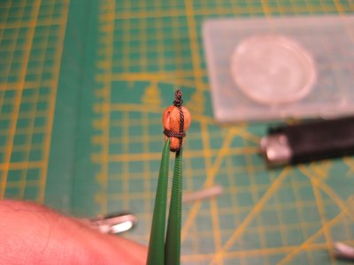

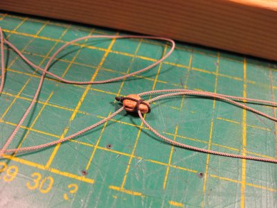

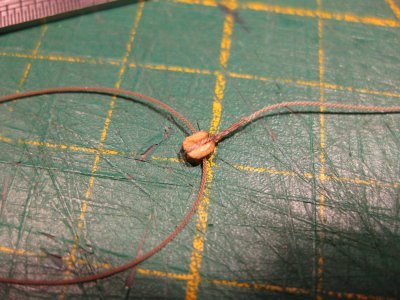

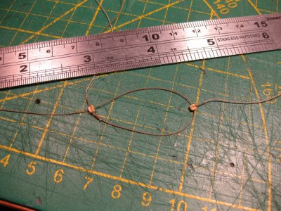

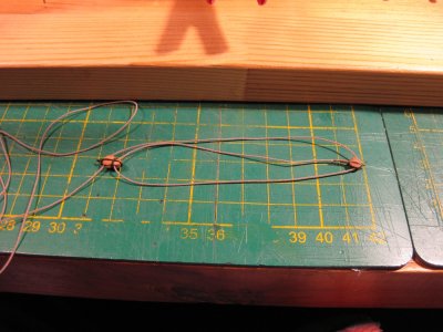

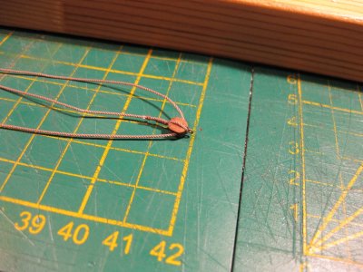

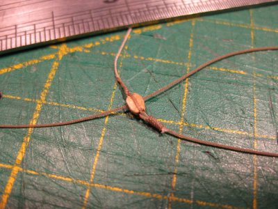

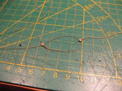

Thanks for the likes and copliments again. This update took me a few days to make. Especially the reef tackle took some time to make. The Mizzen topsail halyard I made today. The violinblock is handmade on the same way I make ornaments.
The reeftackle 2x:
When you zoom in you see the glue. The rope is 0,2 mm. With bare eyes not visible, but I have to experiment with other glue that don't have this effect on small parts. On bigger rope I can hide this.
The Halyard of the mizzen topsail:
The rope is 0,61 mm. It should be 0,53 mm. I can live with that.
The reeftackle 2x:
View attachment 554149View attachment 554150View attachment 554151View attachment 554152
View attachment 554143View attachment 554144View attachment 554145View attachment 554146View attachment 554147View attachment 554148

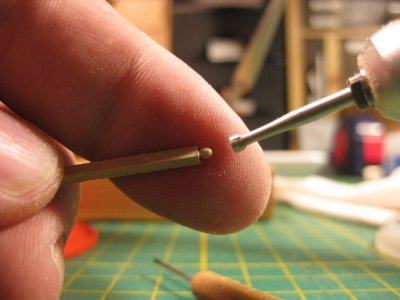

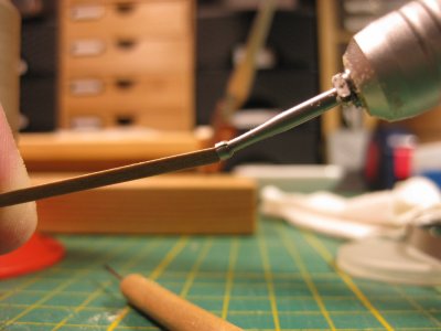

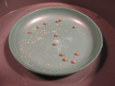

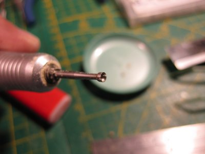

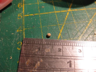

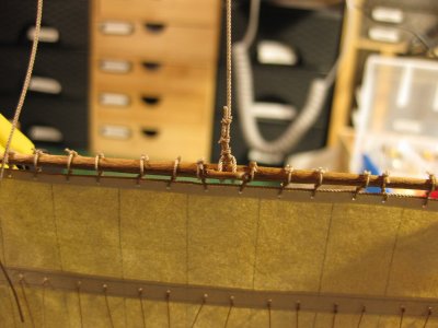

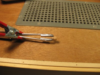

But today I felt like trying something new on my ship. I had to make parrel trucks for the mizzen yard.
And with a scale of 1:75, those things have to be very small. They are not available ready-made, so making them myself is the only solution. After much trial and error and a number of failures, I found a good method. All I have to do now is make the holes in them.
Here are a few photos and a video at the end. It's going pretty fast this way, and I'll keep going for a bit. Because I think I'll need a lot more.
Link to bur: LINK
Thanks for stopping by....

What a great idea for making the parrel beads! I didn't know such drill bits existed. I'll definitely get one. The video is also very well done and explains the process very nicely.
Thanks for sharing.
Thanks Johann, I'm not too happy with the camera's focus in macro mode. It was a bit difficult to get a sharp image. But you can clearly see what I'm trying to do. First, I roughly shape it with a little pressure. You can see that. And then I turn the wood in the cup bur without using much force. There are two types of burs. The one I use is for wood, but there are also burs for rounding off metal.
