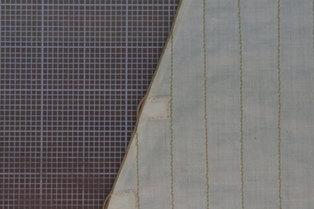

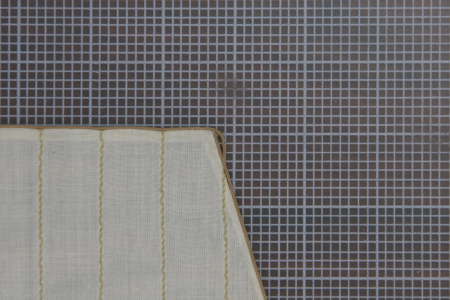

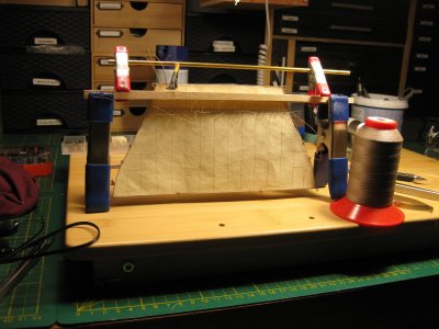

Thanks Ab, you are absolutely right about this point. I mentioned in my post before
I didn't get them in a nice way onto the boltrope. It keeps looking messy. That's why I choose the grommets, they looked the best of all. Yeah I'm ashamed about it, but to small for correct details.
The bigger sails will give me a better try, because of the bigger rope on the sail. Circular cringles are used on modern sails these days. They are placed in the sail.
The next small sail I make, I will try to don't let them look round but oval by sewing them on 2 points first and then the middle point. And the main and fore sail are big enough to give more detail.

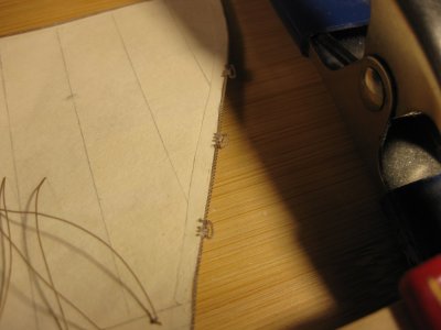

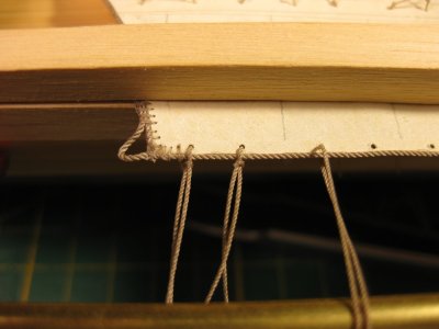

Hi Stephan,
I did a visual cheat (scabbed in a short section of rope under the cringle loop which was a direct continuation of the bolt rope):
Hi Stephan,
View attachment 533785 View attachment 533786
That's a good solution to look at. Looks not messy at all. I'm gonna try this on my test sail, if possible. the sails are very thin in my case, that's why it is so difficult to glue without mess. Thanks Paul

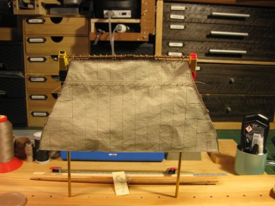

I changed the "leuvers" a bit. just make them a little more oval.
They are still not what I want, next sail will be different. I leave this one, It's a small sail and with the bare eye it's hard to see.

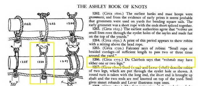

You can see the reefpoints pointing to everywhere, they are not heat treatment till now. First the robands.
Ashley's shows them in this way 1264. Not the yellow.
I made 3, but I'm gonna look if I can do the seizing better. Don't like it how it's done by me now. The robands are 0,35 mm. and the seizing is 0,23 mm.
Lovely work, Stephan. Could you just seize with thread? It's so small no one will notice you didn't use proper rope.

I give that a try Paul, because it's real small and almost not visible when the yard is attached.

Thanks guys for the nice words, my goal was to show how to make sails from paper and how they will look. Surprice, it came out very good. I like them also, looking realistic. I hope that furling these sails will come out as well too. Like Allan says that details look oversized when made of piece cloth. I got that problem too. There are some cloth that look good, bud hard to get, seaming them is still hard to do.

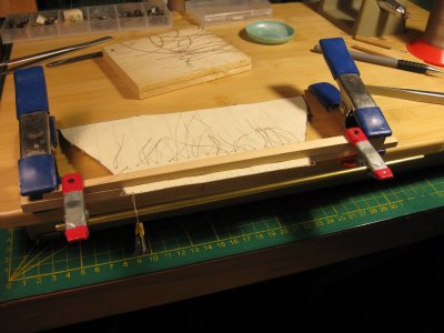

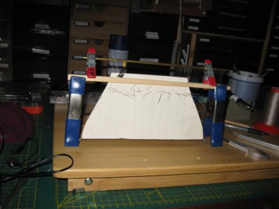

The paint I used was this
118 ml is what you need for 1 set of sails, maybe more. I got 250 ml tubes from another store.
the only difficult part is when you paint the paper and take it of your table. The rest is easy. When dry, it is very strong.
Oh wait, the most difficult part is to glue the bolt rope to the sail.

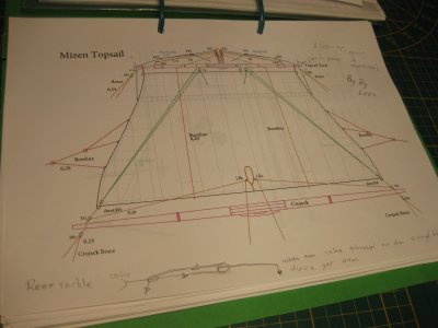

I'm getting back to working on the sail and now I have to figure out what strings and blocks and how it all comes together. Nice figuring out with a pile of books, documents on the PC, pictures and drawings I can find or have made myself.
Straighten the reef lines will be done in a later stage of the build. Just before I hang the sail
A lot to research..... a lot.

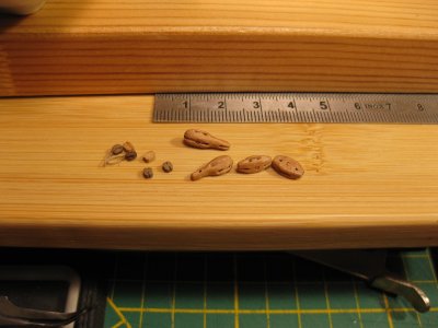

And of course making parts. Tiny parts

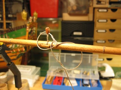

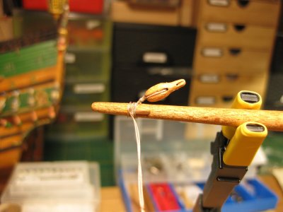

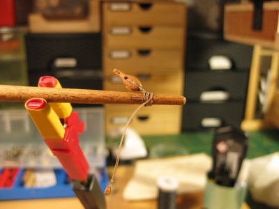

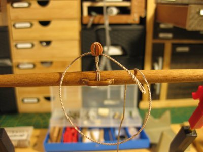

The strop to hang the crojack, big grommet for the block and an eye on the strop.

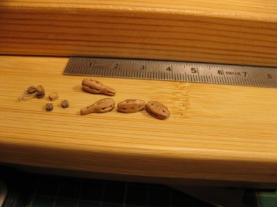

2 block for the sheets on the colar of the stay. Both with grommets. (2 mm. blocks) rope is 0,22 mm.
pdf with my research to keep in mind how things supposed to been done.
Now I'm gonna make the lift blocks on the mast and the shoe? block on the crojack ends.

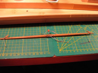

all the blocks and the blocks attached to the yard.
These blocks on the yard are big. I found this drawing online source vaartips.nl Tekening van Frederik J.Weijs
