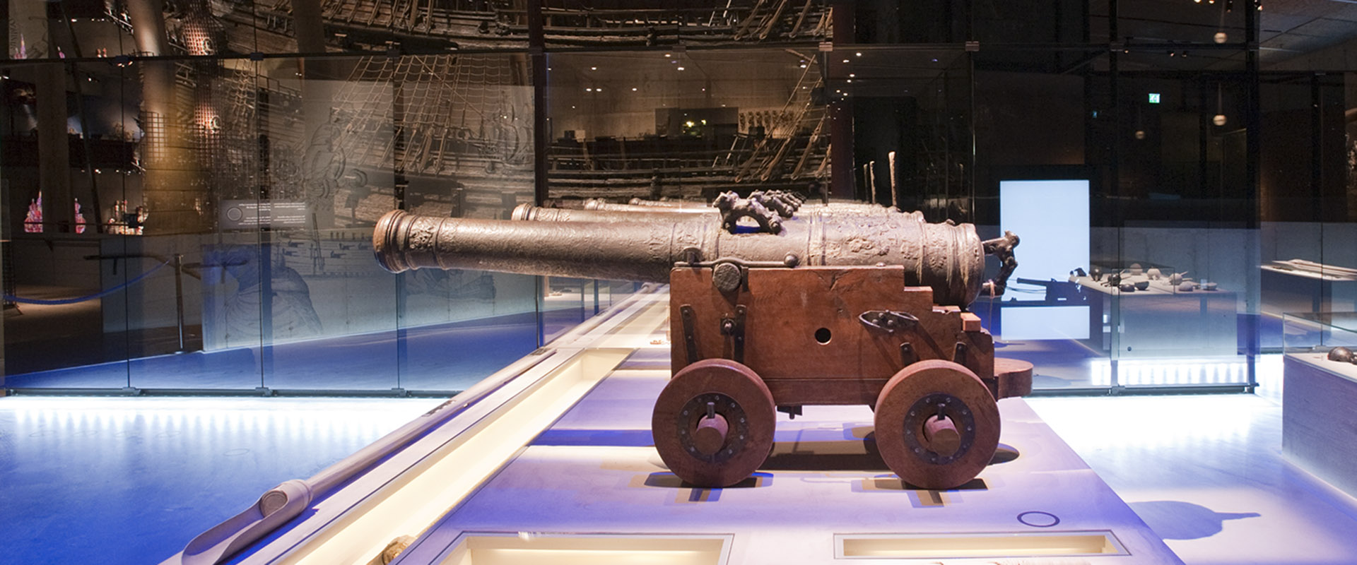

Your gun barrels are sitting wrong on the carriages - the pins of the barrels should be lower than the longitudinal axis of the barrel.
This is the situation now:
Here a sketch of a gun (taken from Jean Boudriots book)
Your location is marked in red, but it should be under the axis
Unfortunately the cannons are use came with the Corel kit and they were pre-drilled there’s not much I can do about that.
OK, but you can easily change it without drilling the barrels - you have only to turn them by 180 ° degrees along the longitudinal axis
