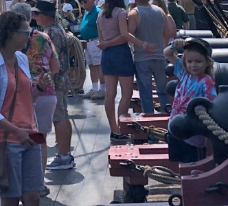

The color of the deck varies with the lighting, weather (wet or dry), and tourist traffic to name a few variables. It ranges from an orangey color in the lightly trafficked areas to flat grey in the heavy traffic areas as well as from board to board. It is distinctly different from the deck below due to exposure to the weather.

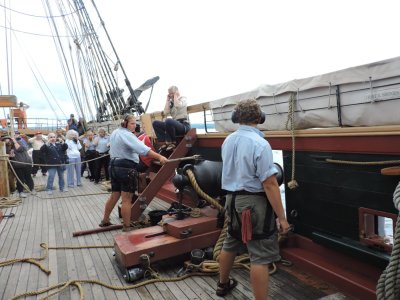

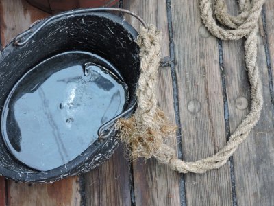

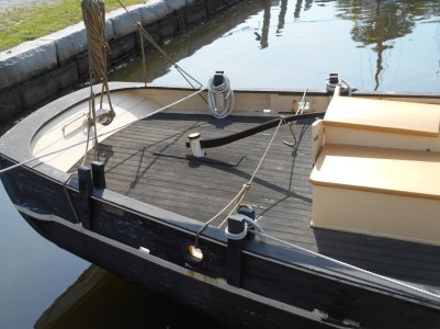

real decks on real working ships are a dirty grayish tan. It also depends on the wood some ships were decked with Southern Yellow pine other with red or white Oak. Also note in the second picture deck planks are sometimes curved and do not run in a straight line. Also so many model builders think the insides of the bulwarks were painted red not always so shades of green and blue were quite common colors.

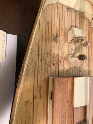

The quarter sawn (annular ring) grain is tight and compact, so there aren't large variations in the grain as in flat sawn wood. I mention this because the stained appearance of tight interlocked grain of poplar or bass imitates the look wanted in a model. A light grey with a brown tint that is wiped dry looks right. You could try a two stage stain job using gell stain to bring out the grain after coloring the field. Decks were caulked with oakum and tar leaving dark black edges to the planks. On actual decks I've used a rubbery black caulk between planks, and on my 1/4" scale Elsie, I used a graphite stick on the edges of each plank. I don't think this would work for me in a smaller scale, just relying on the stain work. Bear in mind that any final coat of sealer to repell dust would have to come last.

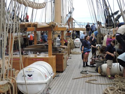

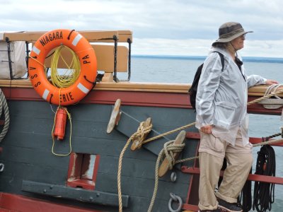

I hate sounding like an expert, but I've built more boats than models, and a lot of houses. So here's Elsie, Emma C. Berry model and Mystic, and Constitution in 2019.
